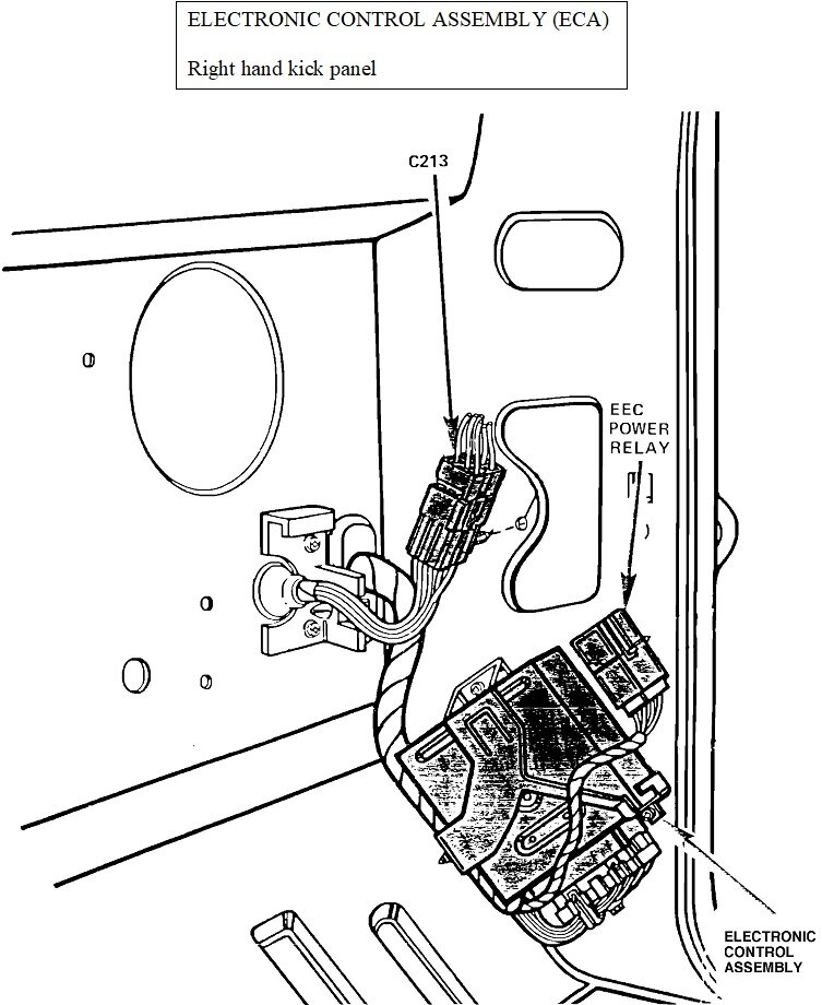

Can’t find the location for my ECM?

It sits right behind the right kick panel where salt can get to it. Be sure to check for any wires that are corroded off.
Image (Click to make bigger)
