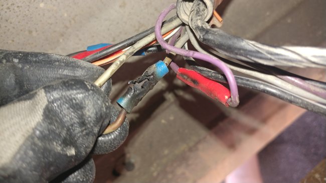

DANE JUSTUS
Lifted truck. Got to splice. Found this burn. K. We have the culprit, but why? I do not want to have to come back to this. I will check the new fuel pump box see if it has a new lead. I want to say the gauge was smaller. Will need to check.
Thoughts on the reason and how to alleviate this in the future?
Thanks.
-Dane

HMAC300
  • 48,601 POSTS
Not to be a smart ass but it looks like it wasn't done right to begin with, put a solder joint on both wires and use shrink wrap around it, maybe two shrink wraps. It looks like I f it's shrink wrap it may be some really cheap stuff. Then check the ground and see how may amps pump is drawing as it may be drawing to many. Some of these trucks the pump was bad and a new harness had to be installed about a foot back because of poor connection. Normally they came with the harness and the connection was changed.
Thursday, June 8th, 2017 AT 1:57 PM
HARRY P
  • 2,296 POSTS
As HMAC stated, these trucks do have issues with the fuel pumps and their wiring. I've had 2 blazers (same fuel systems along with most other mechanical) and I've had to replace both fuel pumps. And the current one is having issues with the gauge sending unit (probably the wiring).
As far as a suggestion on how to fix that wire, I'd say trace it to the other end and replace the whole thing with a heavier gage wire.
