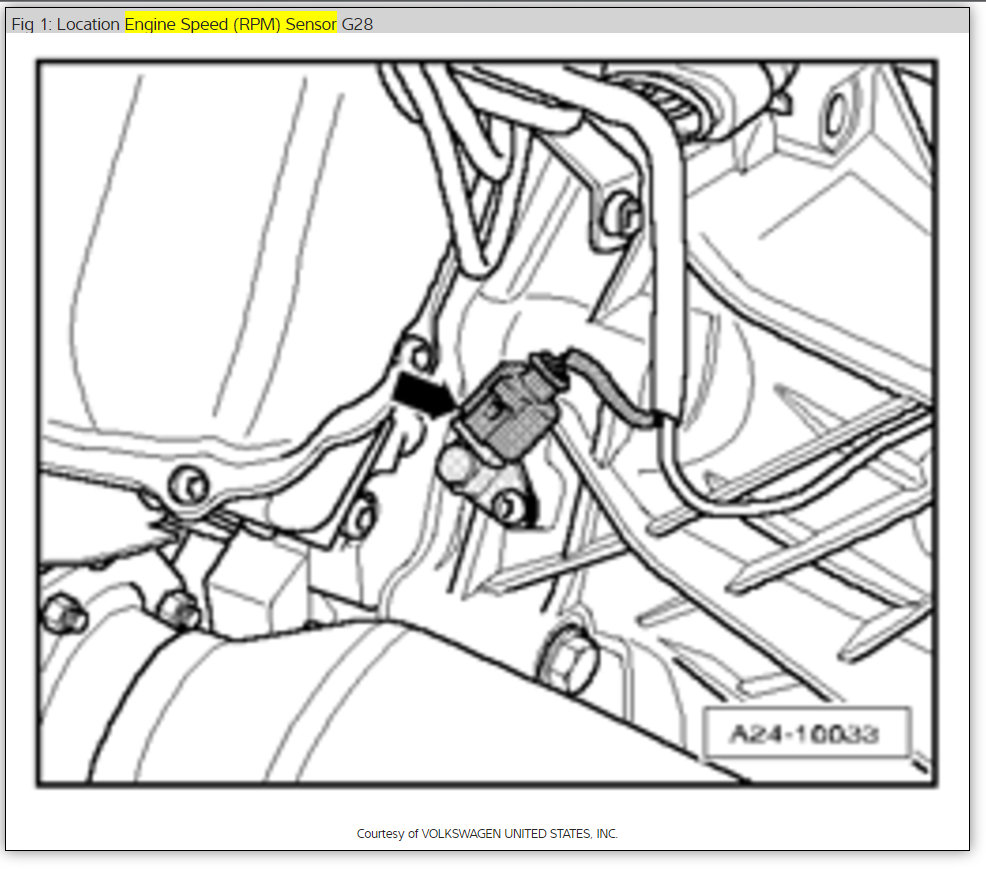

First it broke down on the road, we bring the car home and inspect. We changed some relays J271 and the ignition coil was shorted and then we replaced the coils and the engine starts, but runs not great. Now the car will not start because the fuel pump is not running.
The tester said that it is a relay, but I have replaced that too.
Can you help? Thanks

It sounds like the crankshaft angle sensor has gone bad and the computer is not turning the fuel pump on becasue it does not see the engine turning over.
Here is a guide that will show you what you are in for when doing the job:
and
and
Here are some diagrams to show you how it is done on your car.
At left front of transmission housing.
