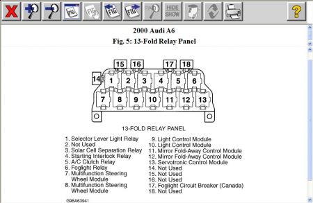

My A6 has intermittent starting problems.
When you turn the key on, all the dash lights come on, but part of the time I will have the turn the key on and off. As many as 30 times to get the starter to engage.
I replaced the electrical part of the ignition switch, but I still have the problem.

Check and test your starter, starter relay, and clutch switch.

Where are the starter relay and clutch switch located on the 2000 A6 2.7t?

Starting relay-see below and disregard the clutch switch-
https://www.2carpros.com/forum/automotive_pictures/12900_start_relay_1.jpg

Where is the relay panel located on the 2000 A6?

My references don't have the exact location you need to look for it-it resembles the pic I gave earlier-also I suggest a repair manual/DVOM on hand if you gonna deal with this problem yourself
