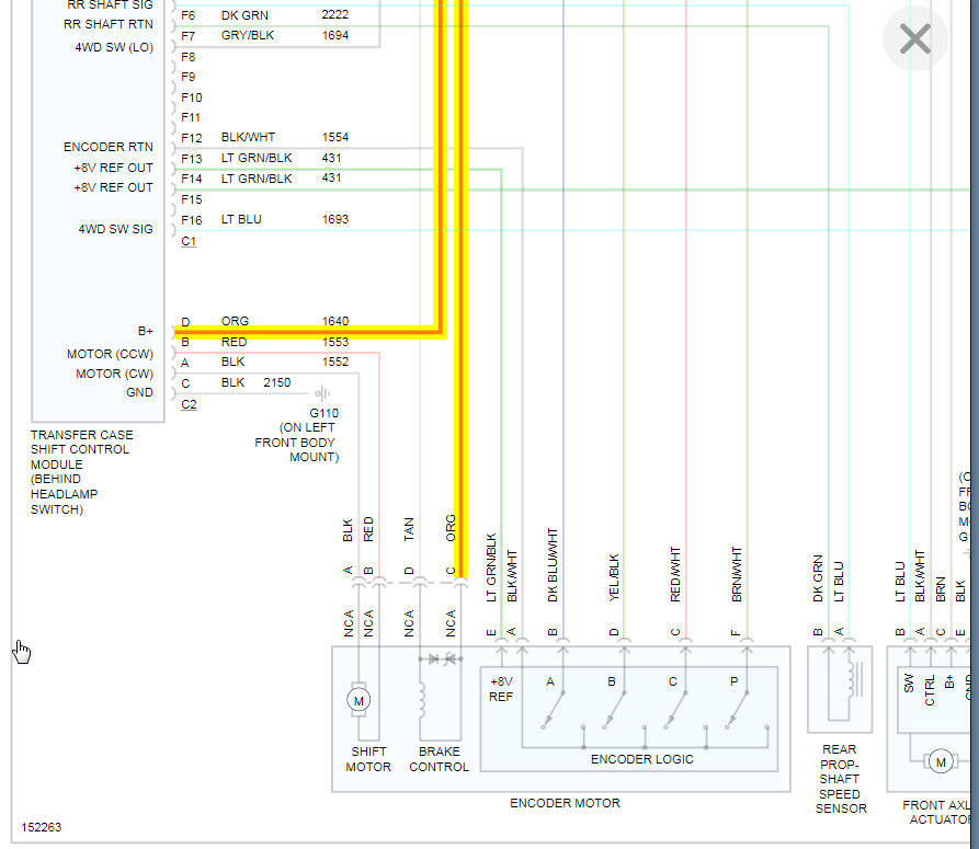

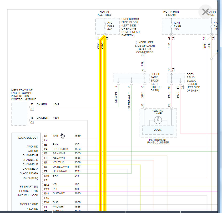

Take a look at the wiring diagram. This fuse actually feeds the B+ for the transfer case control module and the encoder motor. I would suggest one of two things. First you can unhook the C2 connector of the transfer case control module and then replace the fuse again and turn the key on and seeing if it blows. Or you can install a smaller fuse on each leg of this wire and then replace the ATC again and see which one blows first. Whichever one does is the leg of the circuit that is the issue. Since this is a 20 amp fuse I would go with a 10 amp fuse on each wire. Point is, we need to limit down the two wires to one so we know which component or wire is the issue.
Let me know if you have questions and we can go from there.

So, I’m having a heck of a time trying to figure this out, this schematic and troubleshooting stuff scrambles my brain.
Is there a typo on schematic or in your testing procedure? You reference a C2 terminal, I only see a C1 and C9 on the fuse side of schematic?
Since you’re talking about an immediate fuse blow with key on, does that mean TCCM behind headlight switch is fine?

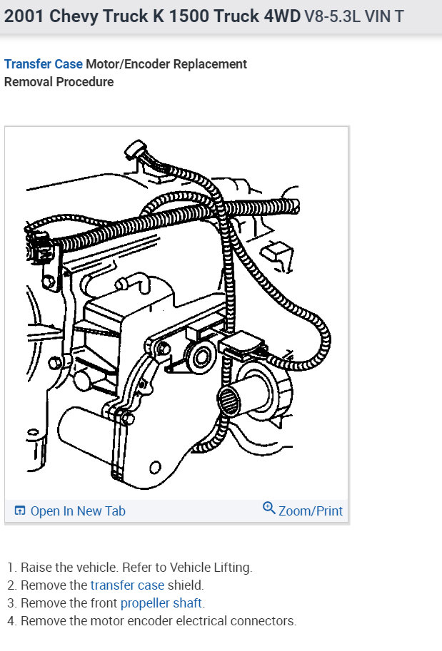

I would remove the transferer case actuator and work the switches, if the motor can be run throughout all modes and is okay the problem is inside the transfer case which is making the motor work too hard and pop the fuse. Please let me know what happens. Also did the fuse condition stay the same with both the new and old actuator motor?

Thanks Ken, good idea. I hadn’t considered since there’s all sorts of warning stickers on the motor about not operating when not connected.
So, I just got it pulled off and the motor does move without blowing fuse.
I’m now wondering (and hoping) if I had it misaligned- think the motor came factory set in 2WD and maybe my t case wasn’t in 2WD? It did bolt on just fine, not sure how much the selector post moves in between shift positions.

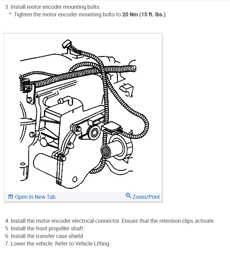

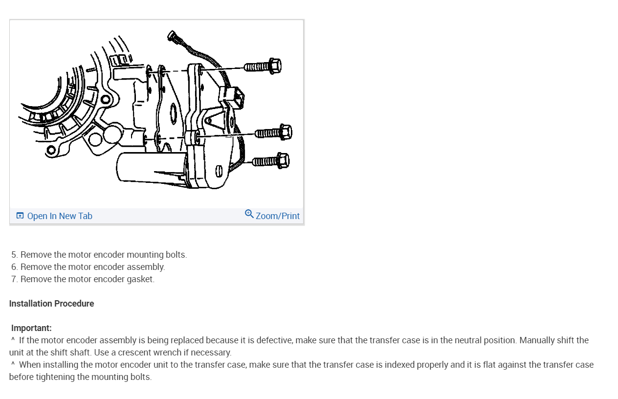

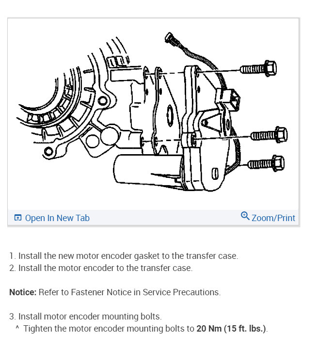

Yep, that could be, here are the instructions for installing the new actuator motor.
Important: When installing the motor encoder unit to the transfer case, make sure that the transfer case is indexed properly and is flat against the transfer case before tightening the mounting bolts.

After many months of driving in 2WD, icy conditions finally pushed me to address this issue.
I actually fully expected it was the t-case, purchased a refurb one and scheduled an install with my very accomplished mechanic friend.
We started to prepare to pull drivelines and he was like your transfer case is engaged!
Which started 12 hours of troubleshooting- ruled out front differential, he ran down all sorts of electrical stuff and got the ground out to the transfer case control module under the dash on the ATC fuse circuit.
As discussed here, the ATC circuit has two power feeds, one to the encoder motor and one to the TCCM under the dash.
Replaced the $330 reman TCCM ($200 core)- and the ATC fuse was still blowing when car was running. Pulled the encoder motor, still blowing ATC fuse. Bought a new encoder motor ($170)
So two electrical components, $500 and 12 hours later it’s shifting in and out of 4WD with no issues
