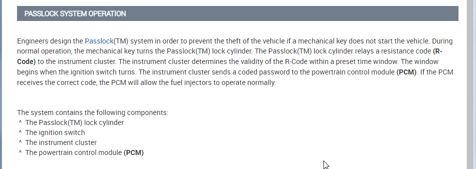

GM PASS LOCK RELEARN- Ignition to "run" position, try to start and let key return to "run" position
Approx ten minutes security light will go off
Turn key "off" and wait 5 seconds
Repeat 2 more times for a total of 3 relearns.
Turn key off, then start it

Problem is most likely bad ignition cylinder and or switch. The temporary fix is to attempt to start the car then leabve the key on. After ten minutes the theft light will stop flashing and the car will then start.

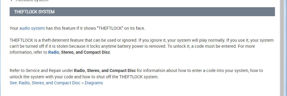

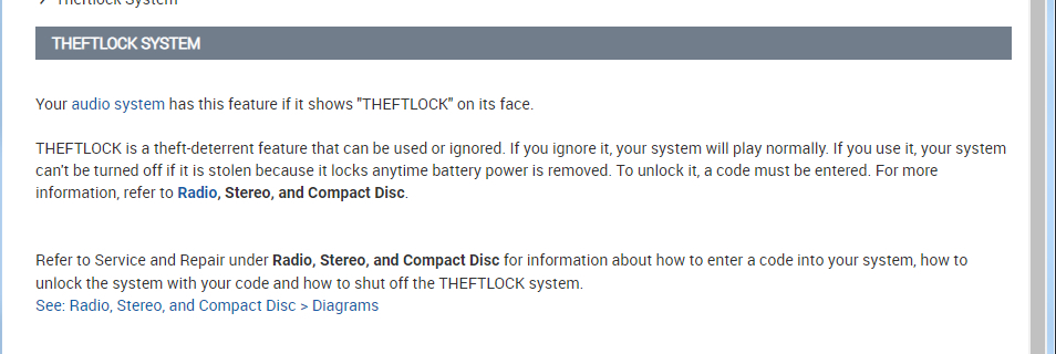

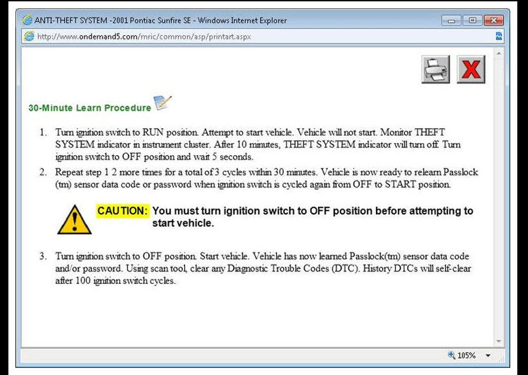

Just to be clear, you are locking and unlocking the vehicle with the remote but you are wondering why the lights don't flash to alert you that the alarm is set or deactivated like other vehicles do?
If so that is because on earlier systems like this it was not an option.

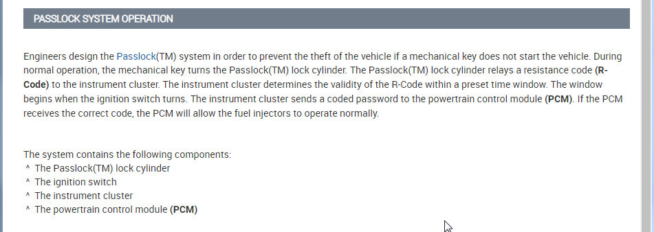

I attached the info about the theft lock which is the anti theft system and the ignition system which means it has to have a key turn the ignition cylinder and not a screw driver or something else that could be used to steal the vehicle.
Let me know if you have other questions or I am not understanding. Thanks

Ok, we need to relearn the system. Turn the key to start and back to on, let it sit until the security light goes out. then do the same thing again and let it sit until the light goes out, then do it a third time. when it is done the third time, it should have learned the pass code and should start. This guide can help.
https://www.2carpros.com/articles/how-to-reset-a-security-system
