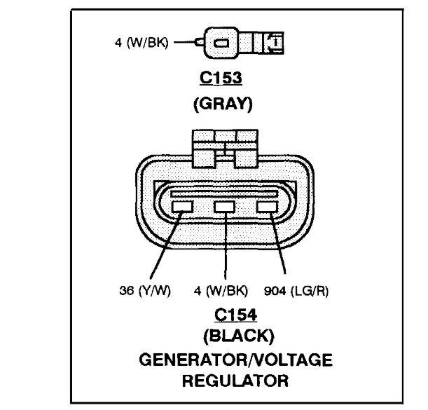

Standard replacement from O'rielly Auto parts. This is the second one. My original was from American Muscle, I thought it was the alternator too?

If the fuse does not fail with it disconnected, that means the wiring is good up to the alternator.

It is possible that the yellow wire and green/red were switched? The pig tail for the alt was replaced thinking this was the initial cause to the blown fuse, would it matter?
Monday, January 13th, 2020 AT 4:49 PM
Yes, it would. Look at the diagram I attached back in the beginning. It identified the wires and where they were located in the connector.
I also attached the diagram of the connector for you as well.

Okay, I definitely just made the wires match the last pic, they were swapped. The old connector fell apart so I had to replace it.

Good find.
Let us hope all is good.

Would a failing alternator connector cause the blown fuse in the first place?
Monday, January 13th, 2020 AT 5:25 PM
If the wires were not in the right position, yes. It may have been going to a direct ground causing the fuse to fail.
