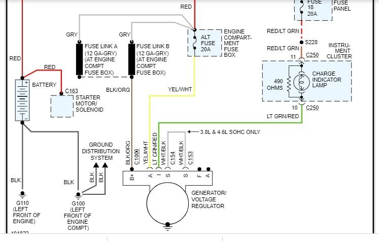

Battery light came on one day. About a week later it shut off on the way to work. Found the alternator fuse blown. Replaced the alt thinking it was inside the regulator. Also changed out the starter and battery. Fuse blew again. It blows at different times so hard to tell what’s going on. Please help

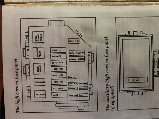

The alternator fuse here bottom left corner.

Can you please give me the fuse number? It is way too small to read on that picture.

I think it is #14. It is under the hood fuses. Takes a 20 amp fuse and is labeled alt.

Okay, check the yellow wire at the alternator. Does it have power with the key on?
If it does not, then we are at the issue. If you have replaced the alternator, then either the alternator is bad again, which I doubt, or you have a wiring issue.

Unfortunately the battery is dead now. I would have to get back to you with that info. So if no power at the yellow wire, would that be the wire to inspect inside the loom for a short to ground?
Dec 29, 2019 at 9:50 AM
That is correct. That fuse only controls that wire from the fuse box to the alternator.

Disconnect the yellow wire from the alternator and see if the fuse still fails.
Jan 13, 2020 at 3:24 PM
BRIDGES77
  • 35 POSTS
With the yellow wire unhooked it does not blow now.
Jan 13, 2020 at 3:49 PM
Do you have power to that wire with it disconnected?
Jan 13, 2020 at 4:08 PM
BRIDGES77
  • 35 POSTS
Yes about 9. volts?
Jan 13, 2020 at 4:17 PM
You should have battery voltage. If your battery is charged, it should be 12.6 volts.
If you hook that wire up, and the fuse fails, it points directly to the alternator.

If the fuse does not fail with it disconnected, that means the wiring is good up to the alternator.
Jan 13, 2020 at 4:31 PM

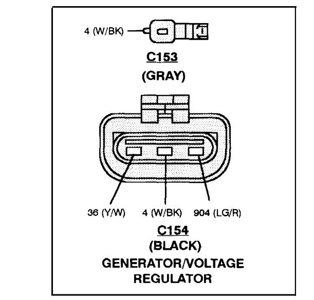

It is possible that the yellow wire and green/red were switched? The pig tail for the alt was replaced thinking this was the initial cause to the blown fuse, would it matter?
Jan 13, 2020 at 4:49 PM
Yes, it would. Look at the diagram I attached back in the beginning. It identified the wires and where they were located in the connector.
I also attached the diagram of the connector for you as well.

Okay, I definitely just made the wires match the last pic, they were swapped. The old connector fell apart so I had to replace it.

Good find.
Let us hope all is good.

Would a failing alternator connector cause the blown fuse in the first place?
Jan 13, 2020 at 5:25 PM
If the wires were not in the right position, yes. It may have been going to a direct ground causing the fuse to fail.
