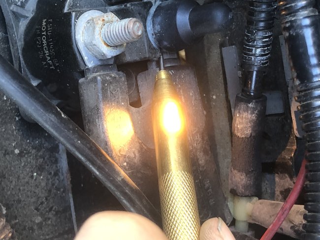

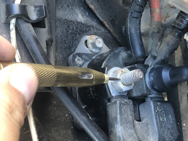

Used a test light on my starter solenoid not sure if that plays a factor.
Friday, November 6th, 2020 AT 5:55 PM
Just to jump in and answer that question. It appears that is the control wire on the starter. You should only have 12 volts on that when you are cranking the engine. So if you were not cranking the engine when you tested with with your test light then it would not light up.
Friday, November 6th, 2020 AT 6:11 PM
DOUGIEP15
  • 13 POSTS
Thanks for the response, in regards to the picture I posted, I was not cranking the engine.
Friday, November 6th, 2020 AT 6:22 PM
  • 110,144 POSTS
That wire only gets 12v when the key is in the start position. So what you found is normal. Have you checked the connection at the alternator? If you have and it's good, remove the alternator and have it bench tested at a parts store. Most will do it for free.
Again, since the fuse only blows when the alternator is connected, then it is most likely the alternator or the connector.

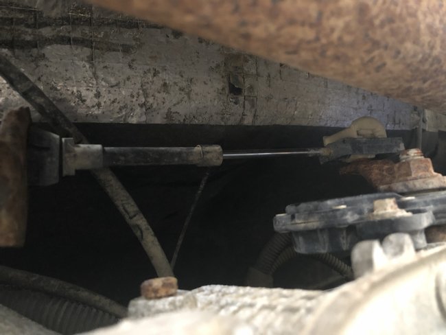

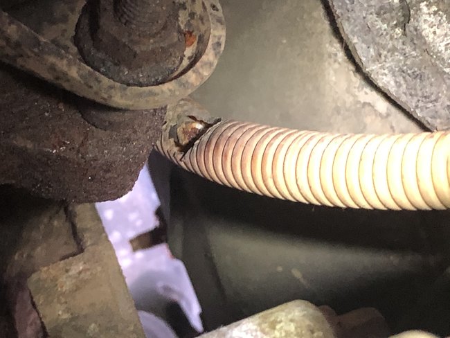

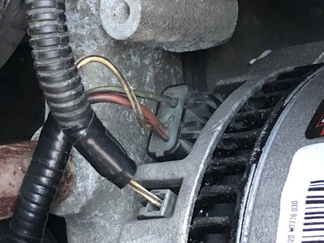

Not sure if this would cause the alternator fuse to keep blowing. I followed the cord from what you see in the picture all the way up to the instrument cluster.
Saturday, November 7th, 2020 AT 3:34 PM
  • 110,144 POSTS
What wire is that in pic 1? Where does it go? That certainly needs attention.
Saturday, November 7th, 2020 AT 3:39 PM
DOUGIEP15
  • 13 POSTS
Hey Joe, that burnt wire leads up into the instrument cluster.
Saturday, November 7th, 2020 AT 3:42 PM
  • 110,144 POSTS
If you shield it, does the fuse still blow?
Saturday, November 7th, 2020 AT 3:45 PM
DOUGIEP15
  • 13 POSTS
Going to try right now.
Saturday, November 7th, 2020 AT 4:06 PM
DOUGIEP15
  • 13 POSTS
Still blows when I shield it.
Saturday, November 7th, 2020 AT 4:26 PM
  • 110,144 POSTS
I was hoping that was the issue. However, it needs repaired regardless.
Have you checked at the alternator (plug) or had the alternator itself bench tested?
Saturday, November 7th, 2020 AT 4:45 PM

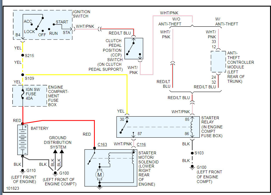

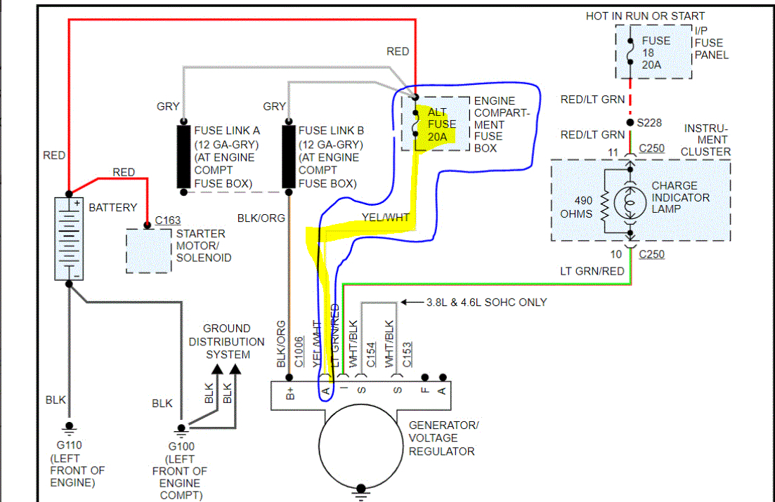

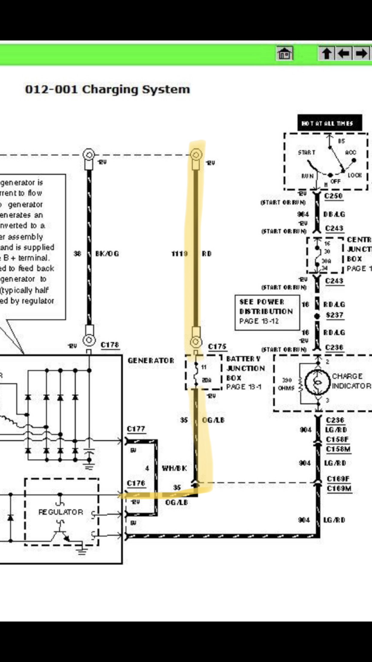

I'm more interested in the yellow wire between the fuse and the alternator. Have you inspected it along with the connector?
Sunday, November 8th, 2020 AT 4:12 PM
DOUGIEP15
  • 13 POSTS

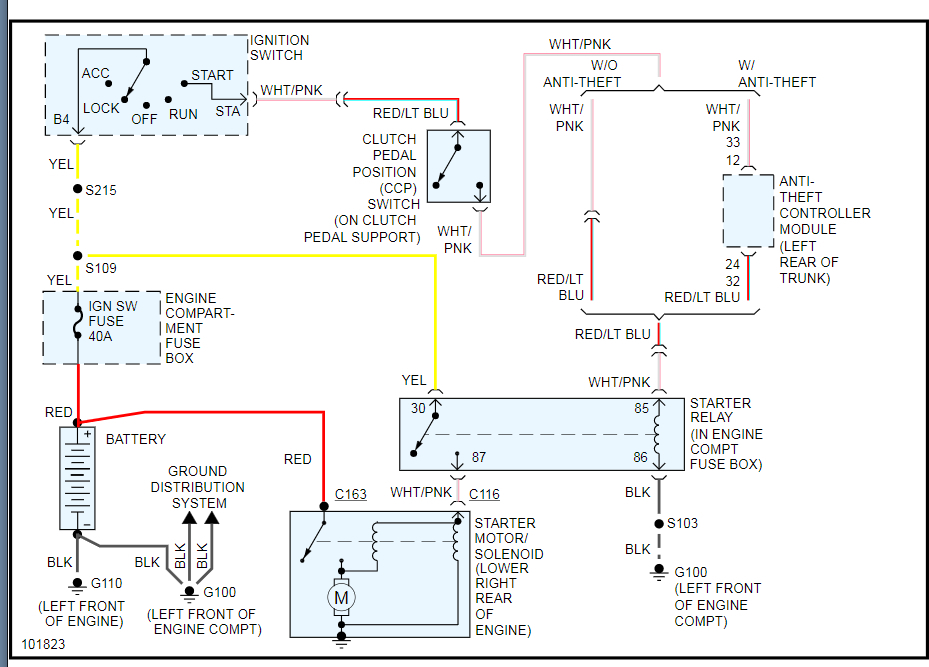

This is the diagram for my 2003 Ford F-150, I’m bringing my alternator to do bench test tomorrow after work.
Sunday, November 8th, 2020 AT 6:04 PM
  • 110,144 POSTS
Sounds like a plan. Let me know what you find. Also, when looking at your schematic, it's a bit blurry. However, it looks the same. Is there something different you are seeing?
