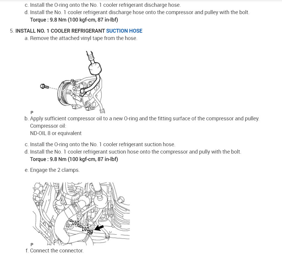

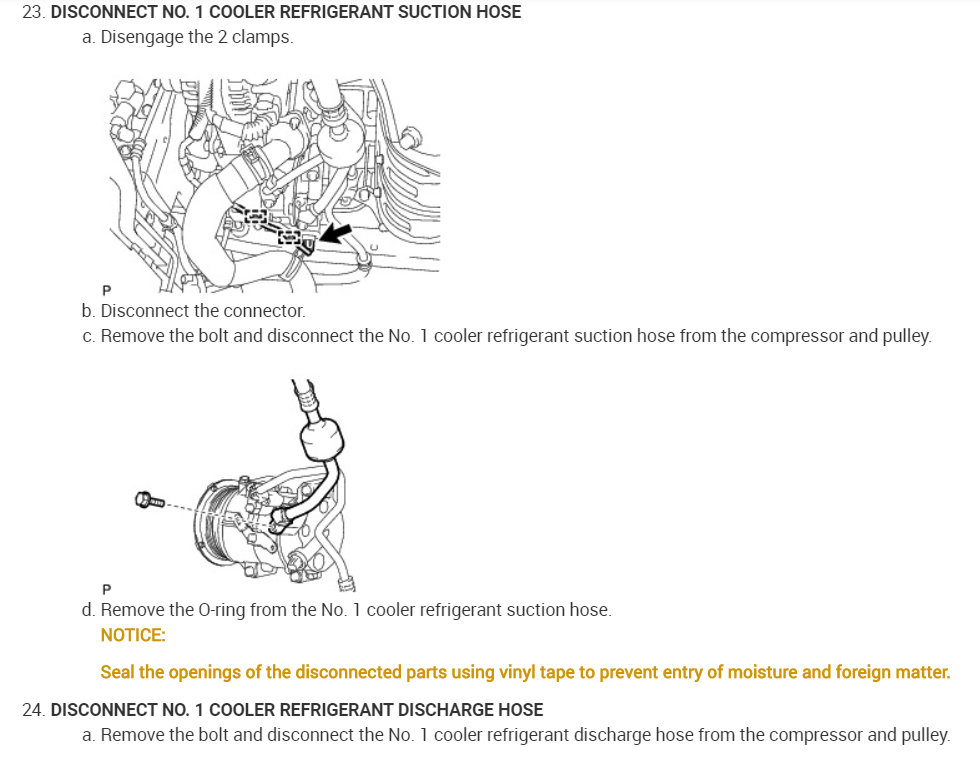

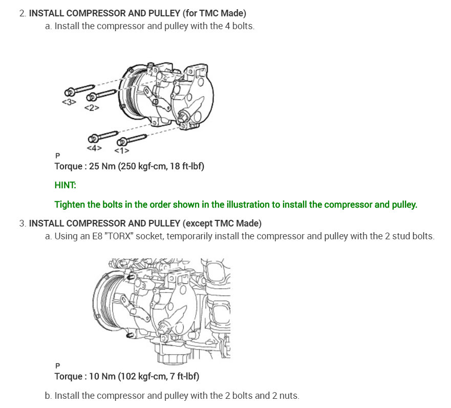

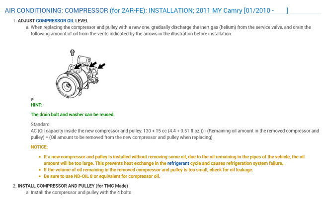

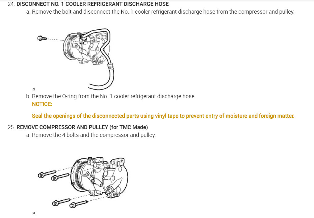

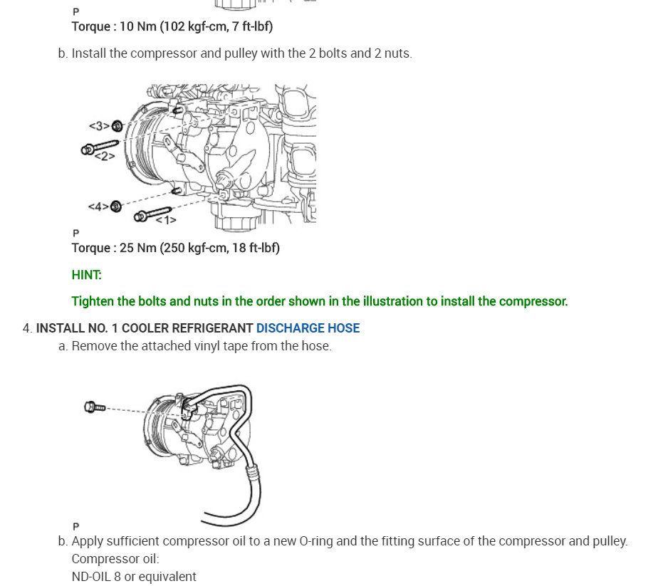

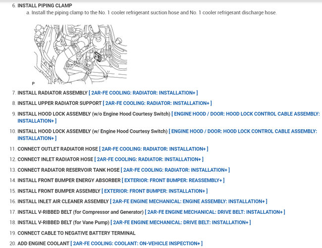

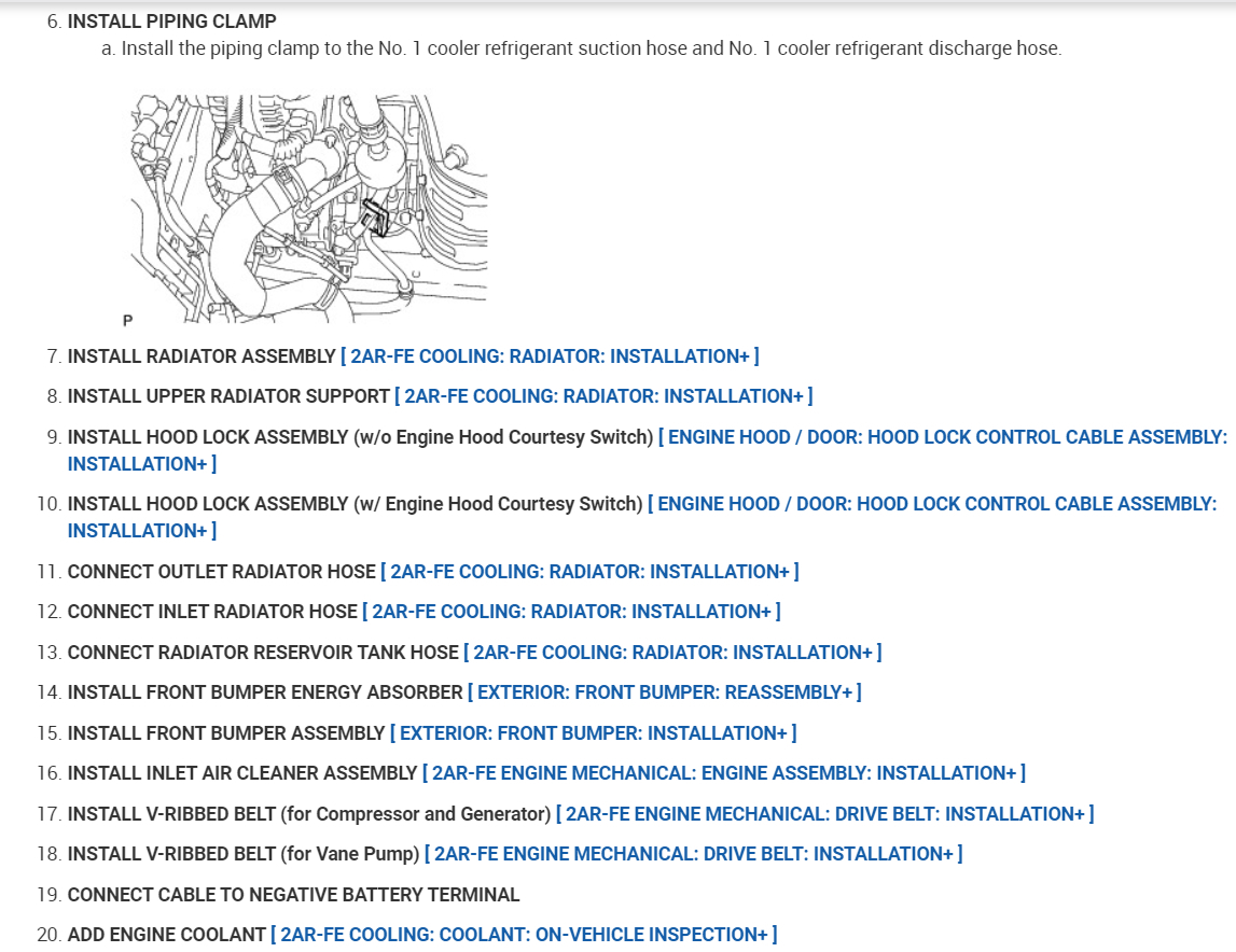

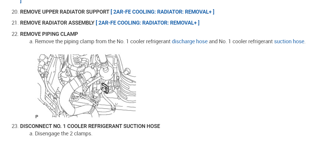

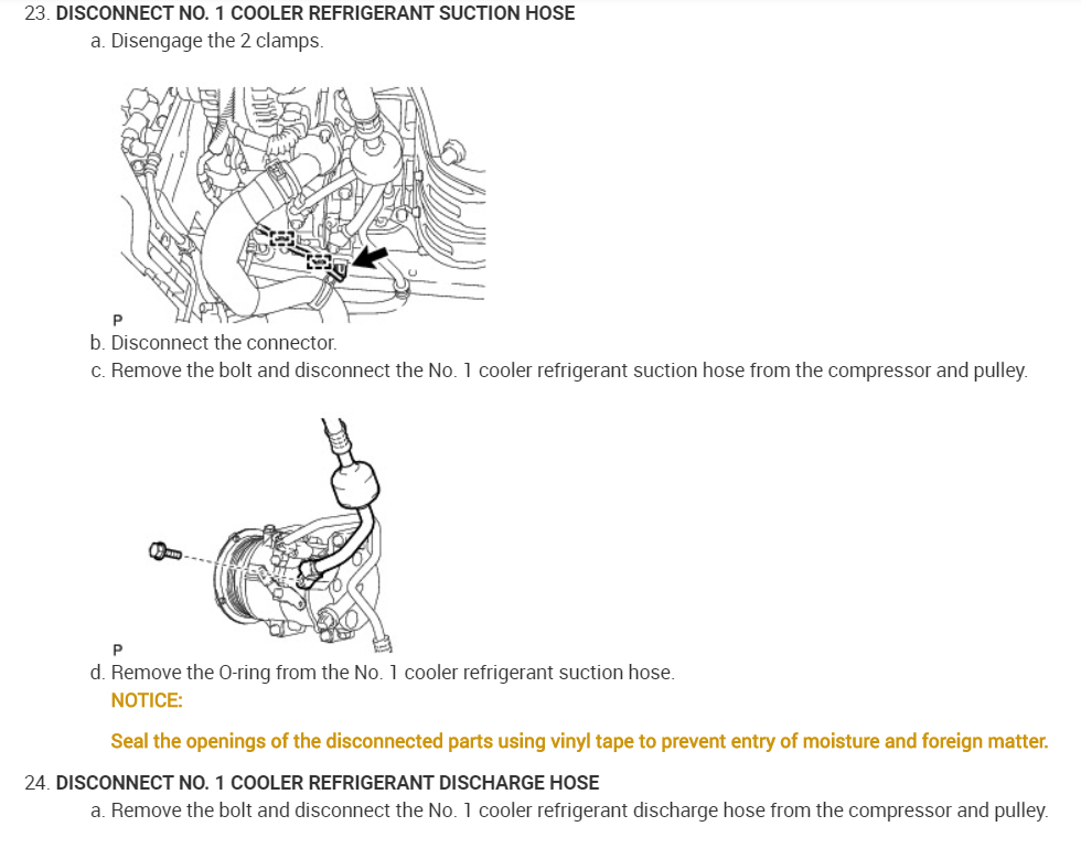

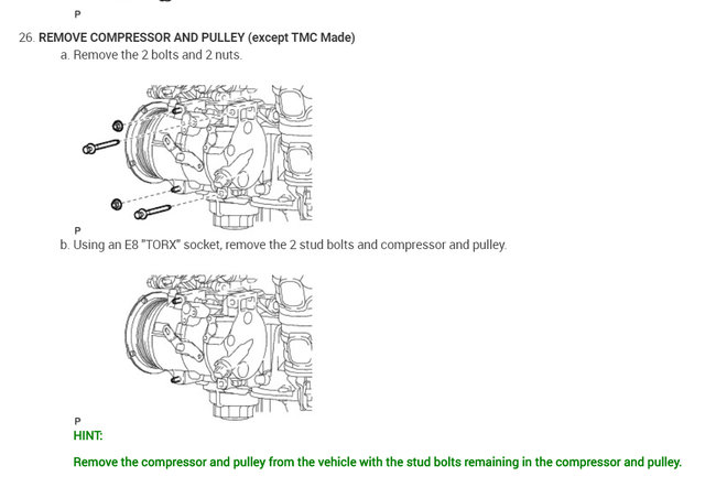

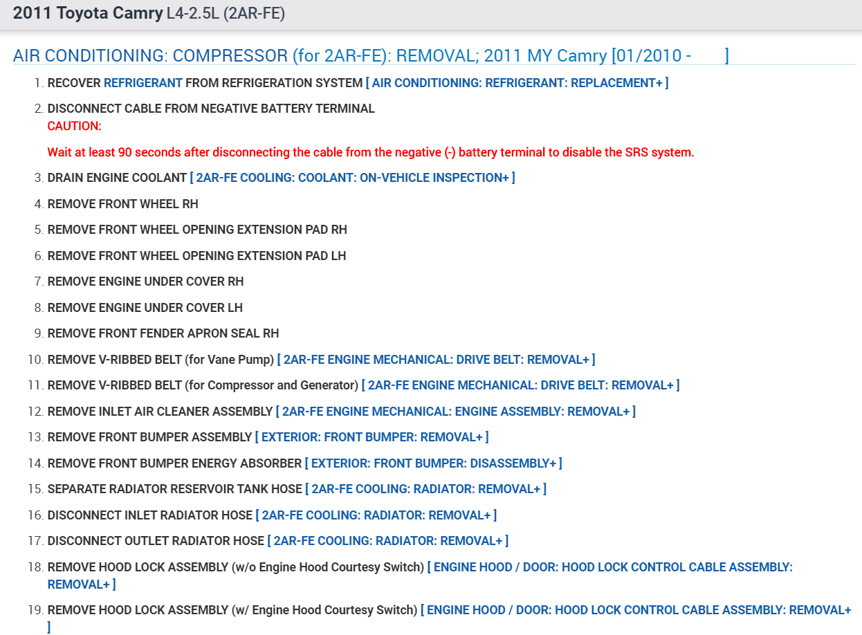

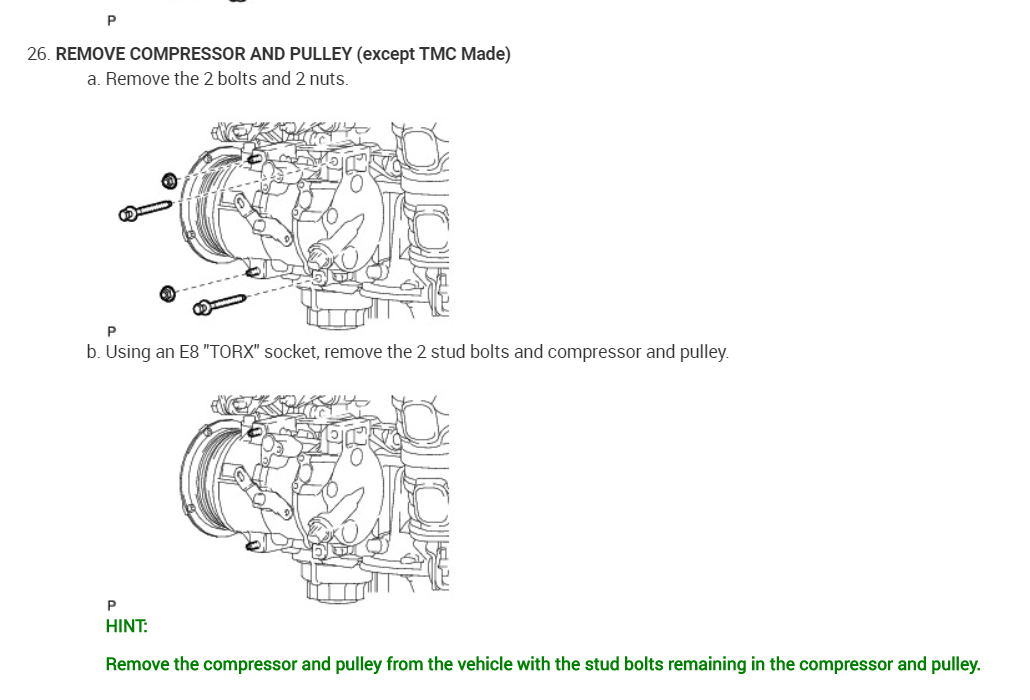

If the system is full you could have a compressor that is going out. this guide will help with diagrams below to show you how on your car:
https://www.2carpros.com/articles/replace-air-conditioner-compressor
and
This video will show you how to fill the system:
https://youtu.be/uZrQCGwXfek
Friday, November 27th, 2020 AT 8:24 AM (Merged)

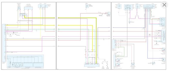

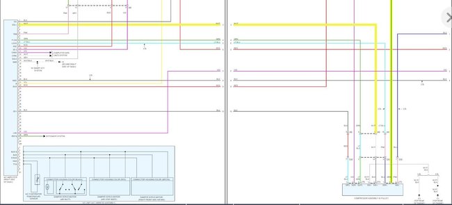

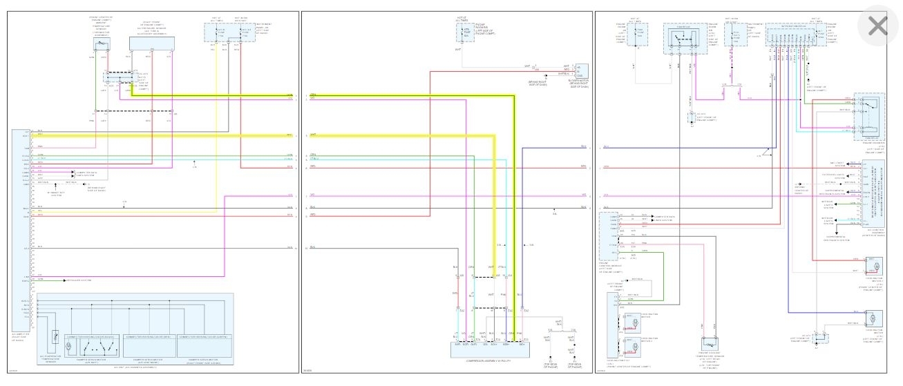

By coolant you mean engine coolant? of refrigerant? I would as the system is low on charge and if not the compressor is starting to go out. To be sure here is a guide to help us check the high side pressure which will tell us everything we need to know:
This guide can help as well:
