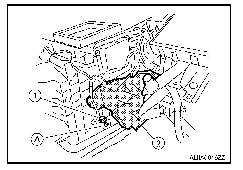

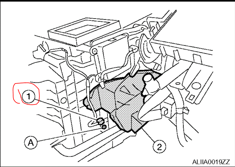

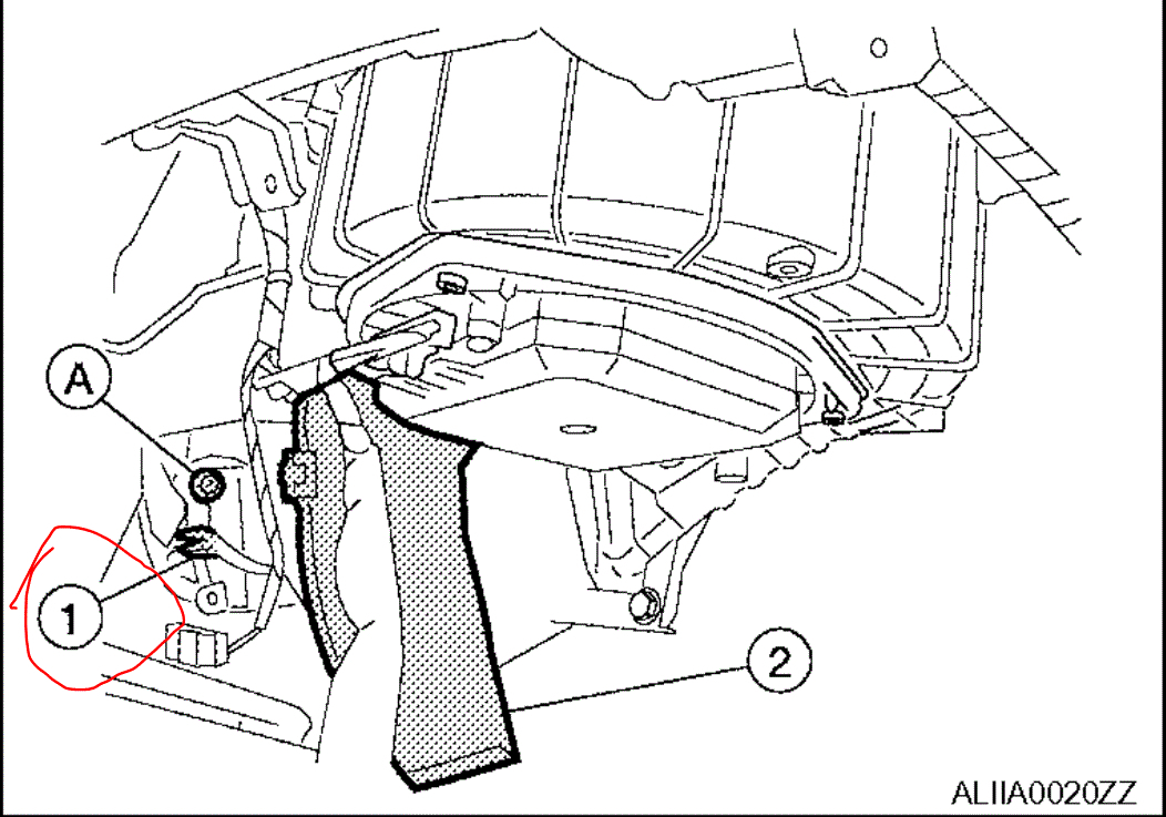

There are two blend air door actuators on this vehicle. I attached two pics below. Pic 1 is the left side and pic 2 is the right side. The left actuator will be on the left side of the HVAC box and opposite for the right.

Here are the directions from Alldata. The first set of directions are for the left side. The two attached pics correlate with the directions.
__________________________
2007 Nissan-Datsun Altima L4-2.5L (QR25DE)
Air Mix Door Motor - LH
Vehicle Heating and Air Conditioning Air Door Actuator / Motor Service and Repair Removal and Replacement Air Mix Door Motor Air Mix Door Motor - LH
AIR MIX DOOR MOTOR - LH
AIR MIX DOOR MOTOR
Removal and Installation
pic 1
Removal
1. Remove the instrument lower cover LH.
2. Remove the center console side finisher LH.
3. Remove the heater and cooling unit foot duct LH (2).
4. Remove the tire pressure monitoring system receiver.
5. Disconnect the air mix door motor connector (1).
6. Remove the air mix door motor screws (A) and then remove the air mix door motor LH.
Installation
Installation is in the reverse order of removal.

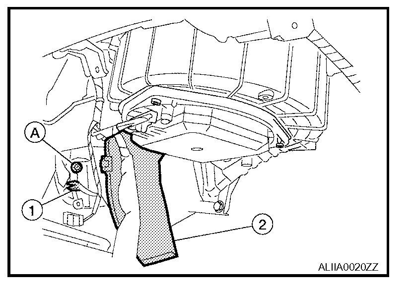

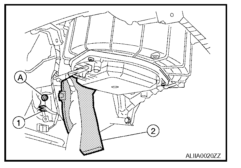

Air Mix Door Motor - RH
Vehicle Heating and Air Conditioning Air Door Actuator / Motor Service and Repair Removal and Replacement Air Mix Door Motor Air Mix Door Motor - RH
AIR MIX DOOR MOTOR - RH
pic 2
Removal
1. Remove the glove box.
2. Remove the heater and cooling unit foot duct LH (2).
3. Disconnect the air mix door motor connector (1).
4. Remove the air mix door motor screws (A) and then remove the air mix door motor RH.
Installation
