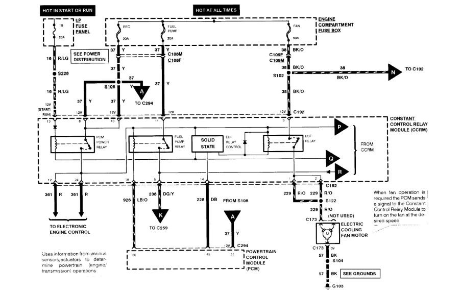

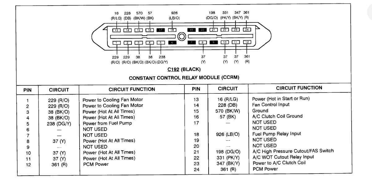

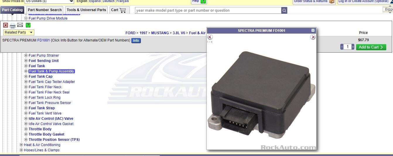

Replaced the suction line and dryer. Vacuum held over an hour, recharged with correct amount and now blows cold air and compressor cycles. However my fan (radiator fan) won't come on. Followed test procedure from my. Streetonline and it points to CCRM. Ect working, fan works when jumped, voltage into CCRM, no voltage at fan and no voltage from CCRM. I appear to have a re-manufactured CCRM and the part number label is missing. Can I get a correct pn by using my vin? Thanks again for all your help.

Okay, first, what is the high side pressure? The fan will not come on until there is at least 150-200 pounds.
Can I have the VIN number?

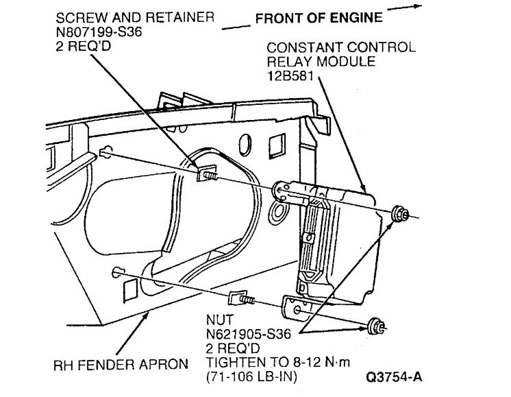

I attached the connector and the wiring diagram for you. Verify all powers to the unit before replacing.

Okay, I attached the part. Rock auto has it in stock.
