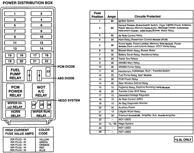

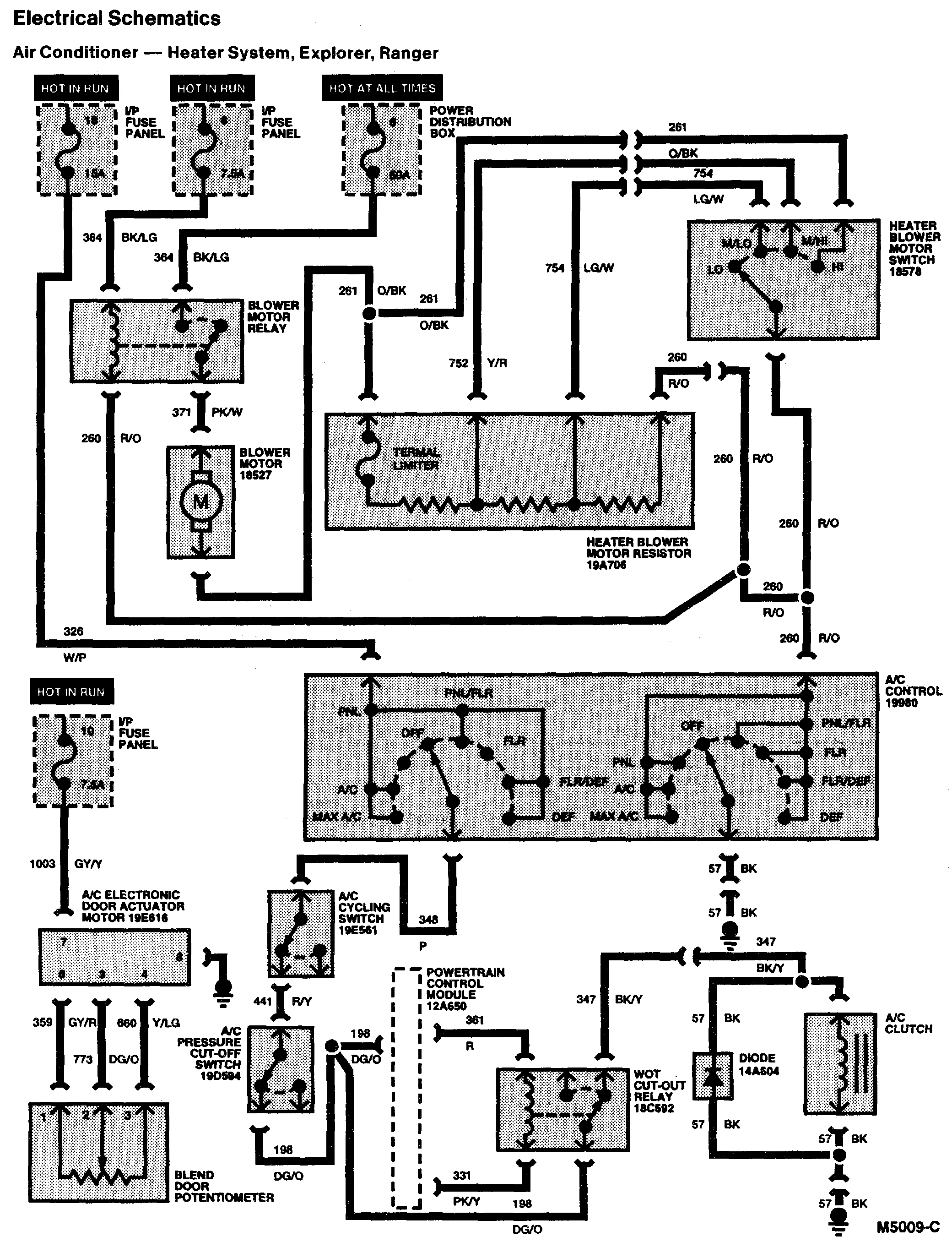

The air conditioner only blows through the back vents. It does not blow through the front vents or the defrost.
Saturday, August 3rd, 2019 AT 1:59 PM
BMDOUBLE
  • 1,139 POSTS

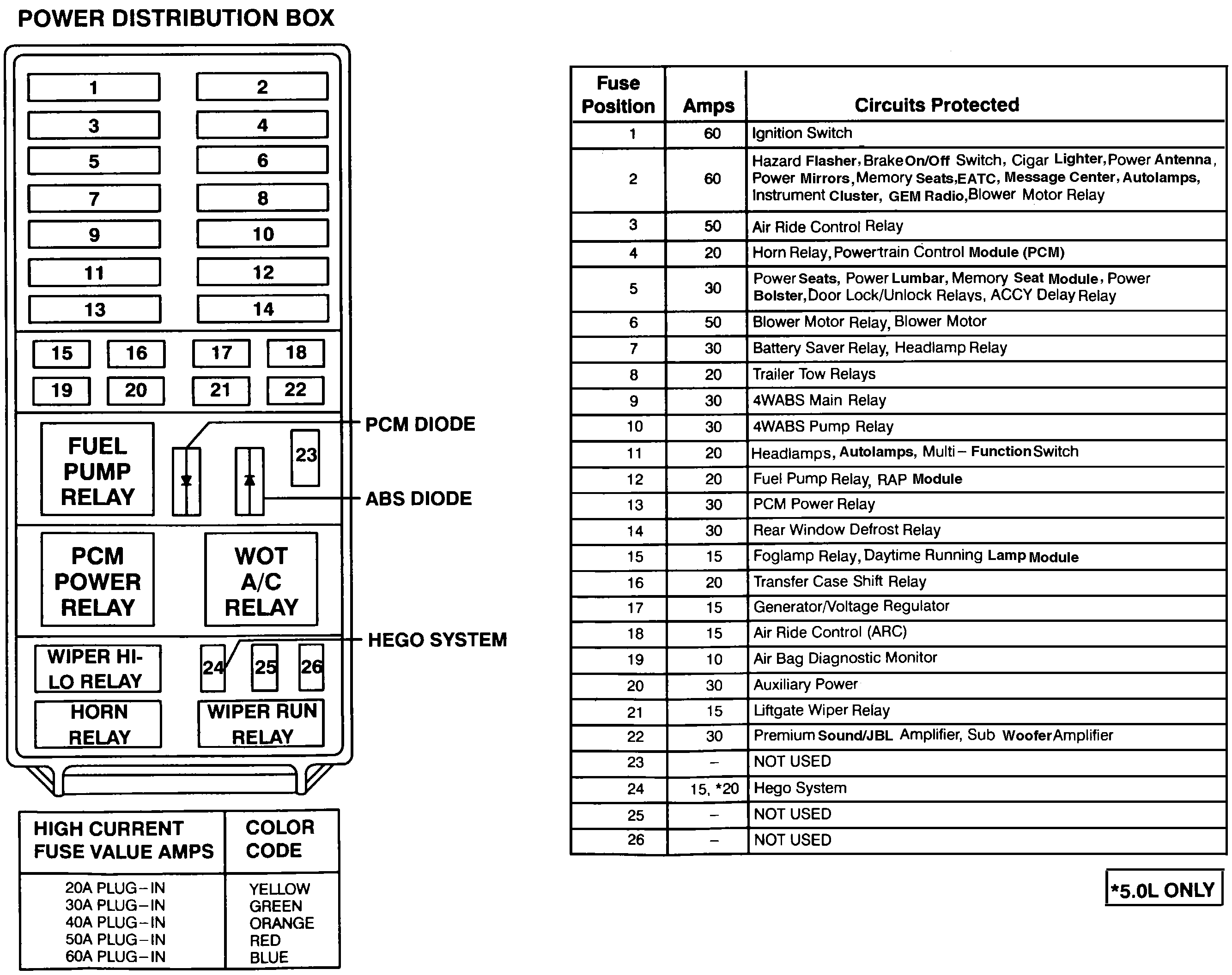

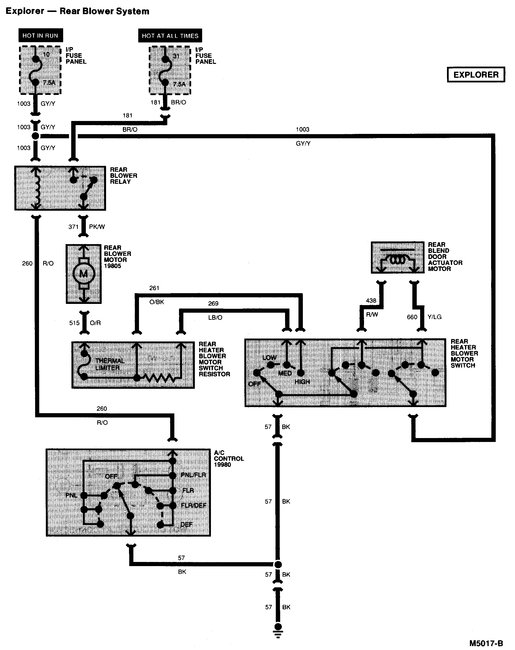

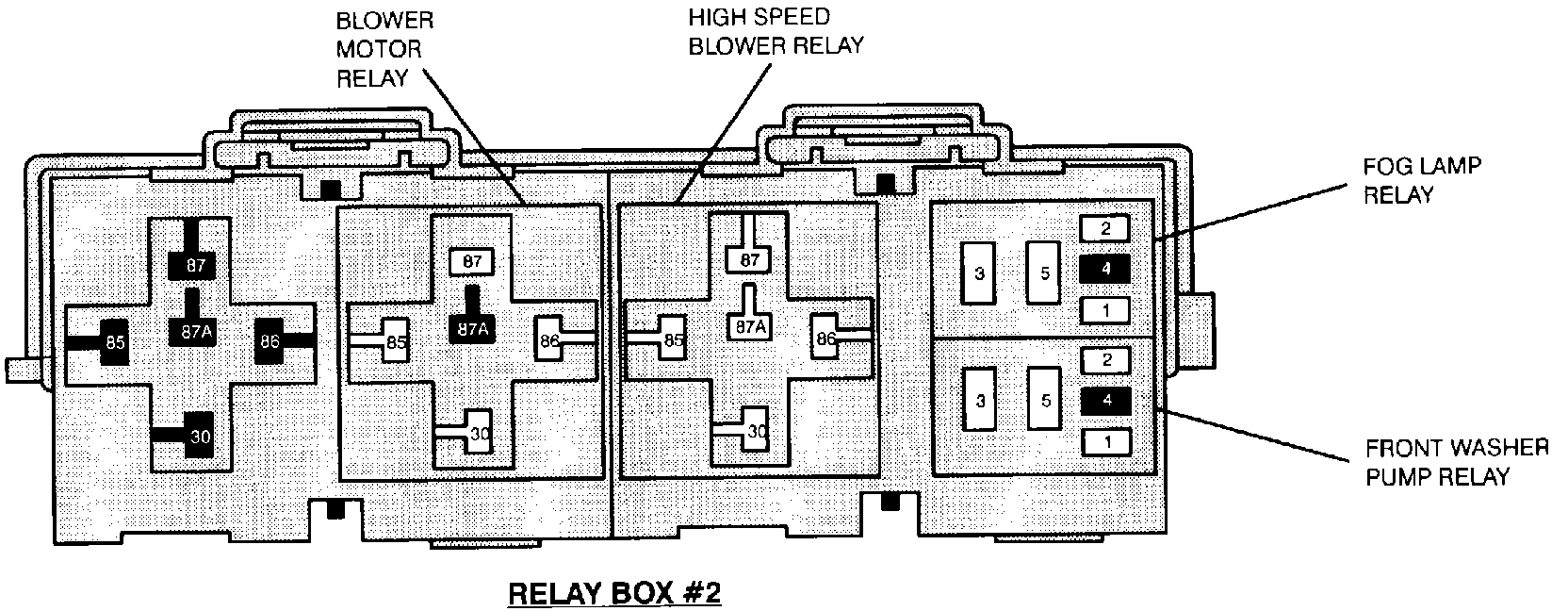

Your vehicle has a separate rear blower motor that works independently from the front. I will include a wire diagram for the entire HVAC system for your vehicle so you can check fuses and other basic tests. The blower motor relay is in the engine compartment in a small fuse/relay box, I included a picture of the relay box.
