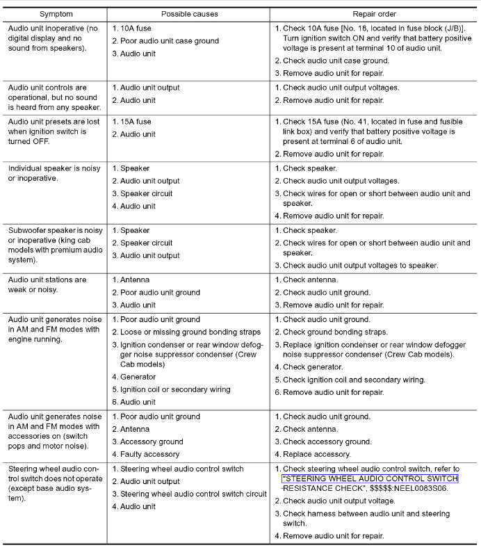

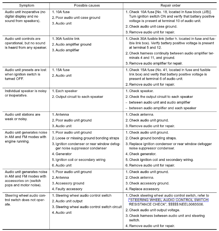

Here are the two Audio Flow Charts for diagnosing audio issues. Run through these are see if you're missing something.
