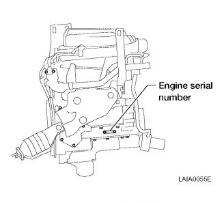

I have to stencil the engine number for registration but I can't find or locate the numbers.

See diagram, It will be in a similar spot for both 4 & 6 cylinders
