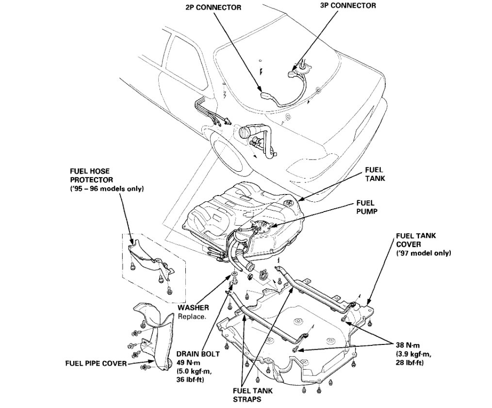

how do you remove the gas tank i have removed all straps and lines?
Mar 11, 2010 at 9:50 AM
BLUELIGHTNIN6
  • 16,542 POSTS

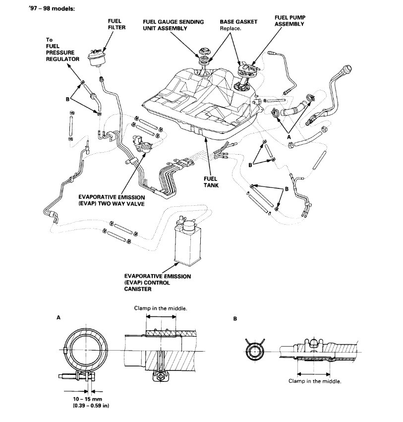

Here is a guide to help walk you through the steps of removing the tank and diagrams below to show you how on your car.
https://www.2carpros.com/articles/how-to-replace-an-electric-fuel-pump
WARNING: Do not smoke while working on fuel system. Keep open flame away from your work area.
1. Relieve the fuel pressure.
2. Jack up the vehicle, and support it with jack stands.
3. Remove the drain bolt, and drain the fuel into an approved container.
4. Remove the fuel pipe cover and fuel hose protector and remove the fuel tank cover.
5. Disconnect the hoses.
CAUTION:
- When disconnecting the hoses, slide back the clamps, then twist hoses as you pull, to avoid damaging then
- Clean the flared joint of high pressure hoses thoroughly before reconnecting them.
6. Place a jack, or other support, under the tank.
7. Remove the strap nuts, and let the straps fall free.
8. Disconnect the 2P and 3P connectors.
9. Remove the fuel tank.
NOTE: The tank may stick on the undercoat applied to its mount. To remove, carefully pry it off the mount.
10. Install the drain bolt with a new washer, then coat the drain bolt with Noxrust 124B.
Allow the Noxrust to dry for 20 minutes.

Disconnect the power connectors and any fuel/vent lines from the tank/pump/sender unit.

Thanks for your response. I have removed all the things (mentioned previously)that should allow the tank to tilt. Although it acts as if there is something preventing it from tilting to access the vent tube and other items which need to be disconnected before letting the tank down. I have removed the back seat and I do not see anything that seems to be attached to the tank. I read in a previous post that prying the tank may be necessary. I have tried prying and it does not seem to be releasing the tank. It seems as if there is something preventing it from releasing freely.
Jan 19, 2019 at 11:48 AM (Merged)
STEVE W.
  • 15,200 POSTS
They tended to coat them with a LOT of undercoating. Acts like glue and bonds the tank in place. If you have the fill tube and those parts off the undercoat is probably the problem.

Note: The tank may stick on the undercoat applied to its mount. To remove, carefully pry it off the mount.

Where is the tank's mount located? My car's tank is secured by two straps. I am experiencing the same issue although my car is equipped with the 2.5L engine instead of 3.2L.
  • 54,840 POSTS
Yes, there are two straps, but there is an undercoating strap that acts like glue. Pull down on the tank and it will come loose.
Let me know how it goes.
Best, Ken
KANGELO1
I literally just figured out how to do this. I had the same problem, straps gone, could not drop the tank. We removed the back seat and used a heat gun on the frame to warm up the bonding/tape while somebody else pried on tank with a pry-bar. Popped right off! Hope this helps!
