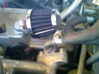

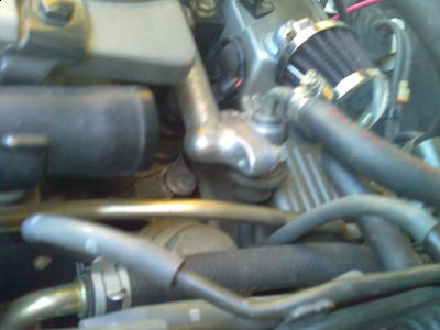

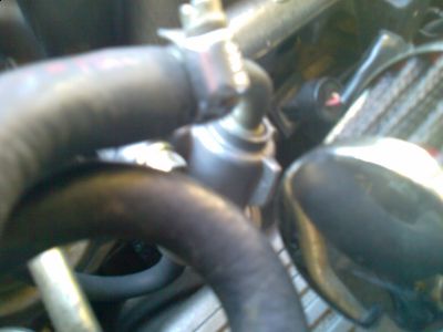

KEVTBEAR57
  • 5 POSTS
Pictures being worth a few words.
https://www.2carpros.com/forum/automotive_pictures/372086_IMAG0016_1.jpg
https://www.2carpros.com/forum/automotive_pictures/372086_IMAG0017_1.jpg
https://www.2carpros.com/forum/automotive_pictures/372086_IMAG0018_2.jpg
Wednesday, March 1st, 2017 AT 3:38 PM

KHLOW2008
  • 41,815 POSTS
Yes, the pressure regulator is wrong side up. Most probably the previous guy could not find a replacement part or the part installed is of a higher pressure.
If the engine is difficult to start when it is hot, we need to know if it is fuel or ignition related.
When engine could not start, check for ignition sparks. If it is available, check the fuel pressure.
Knowing what is missing would enable us to understand the problem.
Does the Check Engine Light come on when driving? This model should have the LED on the ECU sight window.
