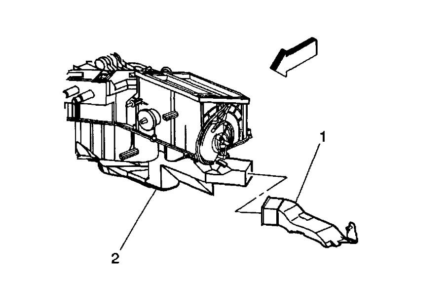

Air blows through defrost at the windshield and rear cabin vent.
Apr 30, 2021 at 11:27 AM (Merged)
Good morning.

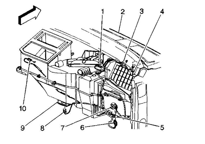

It sounds like the mode door actuator may not be working. These actuators are common failures.
REMOVAL PROCEDURE
imageZoom/Print
1. Remove the floor air outlet duct extension (1) from the floor duct (2).
imageZoom/Print
2. Disconnect the electrical connection at the mode actuator (10).
imageZoom/Print
3. Remove the mode actuator mounting screws from the HVAC module.
4. Remove the mode actuator as an assembly with the actuator cam.

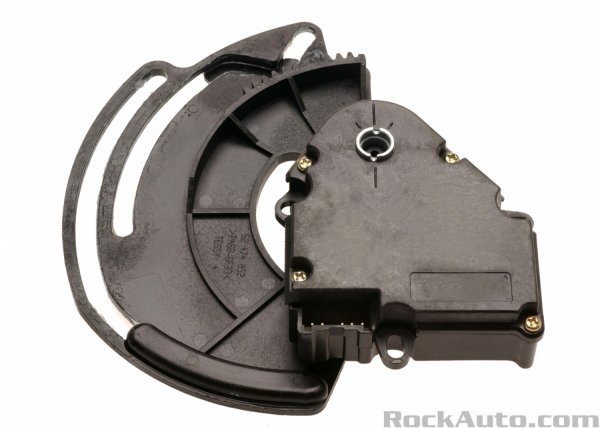

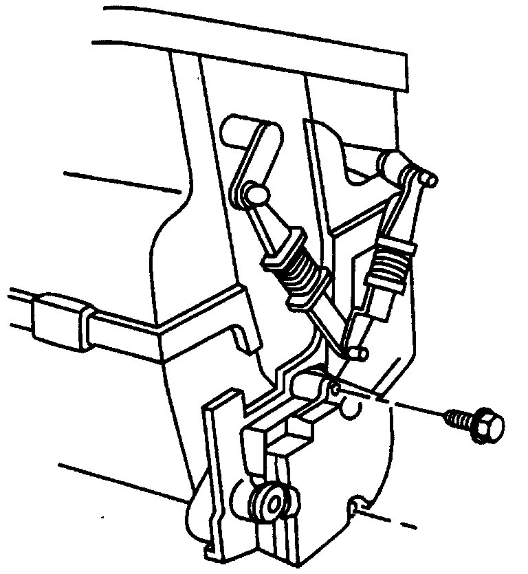

When I turned the dial on the dash to defrost, little to no air came out of the vents on top. Air was blowing out of the vents on the bottom toward the floorboard. This was a real problem since we had freezing rain this morning. When I turn the dial, it sounds like the air is being re-directed but it doesn't work. Is there any way this can be fixed without having to spend a lot of money to have the dash removed?
  • 110,193 POSTS
Chances are the problem is related to what is called a mode door actuator. The mode door is what directs air flow. Often times, you will hear a ticking or clicking sound from them when they fail. There is a plastic gear in them and the teeth can break preventing from fully functioning.
______________________

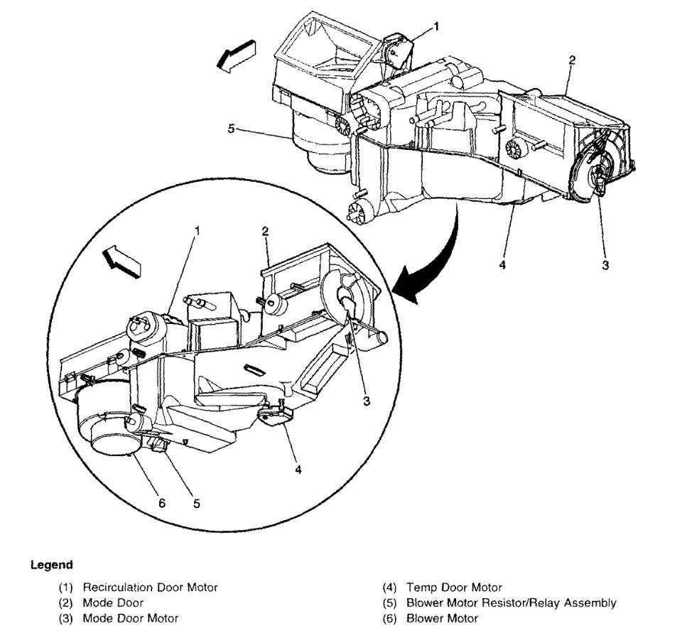

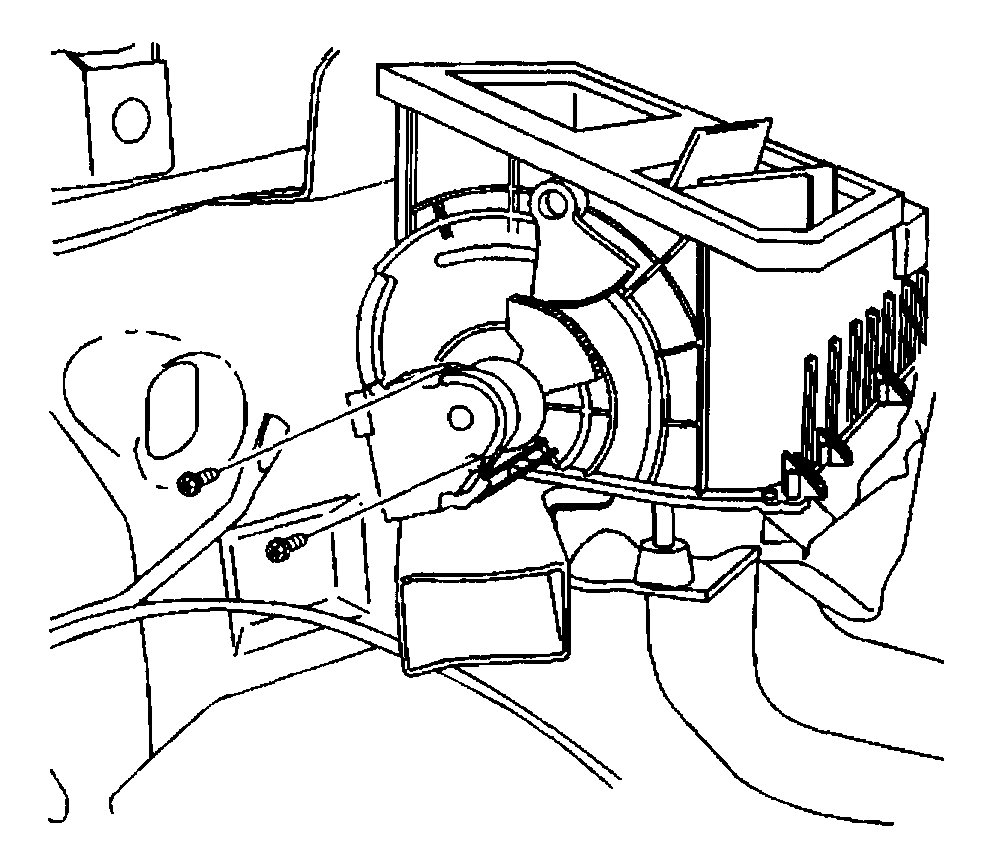

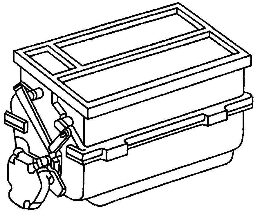

What I suggest is to remove and inspect it. See if it moves when you switch air flow direction. If you find it is bad, here are the directions for replacement. The attached pics correlate with the directions.
1997 Chevy Truck K 1500 Truck 4WD V8-5.7L VIN R
Mode Actuator
Vehicle Heating and Air Conditioning Air Door Actuator / Motor Service and Repair Procedures With Air Conditioner Only Mode Actuator
MODE ACTUATOR
Mode Actuator Location
Pic 1
Mode Actuator Replacement
Pic 2
Remove or Disconnect
1. Negative battery cable.
2. Electrical connector.
3. Screws.
4. Adjuster links from control lever.
5. Mode actuator.
Adjust
A. Electrical connector to the actuator.
B. Turn the ignition key to the run position and let the actuator position itself.
C. Turn off the ignition key.
D. Remove the actuator from the electrical connection.
Install or Connect
1. Mode actuator.
2. Screws.
3. Adjuster links to control lever.
4. Electrical connector.
5. Negative battery cable.
- Check circuit operation.

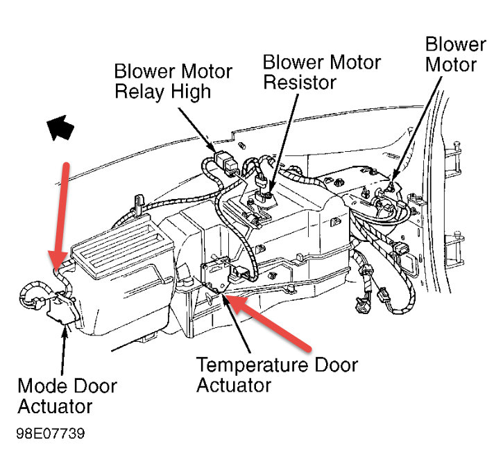

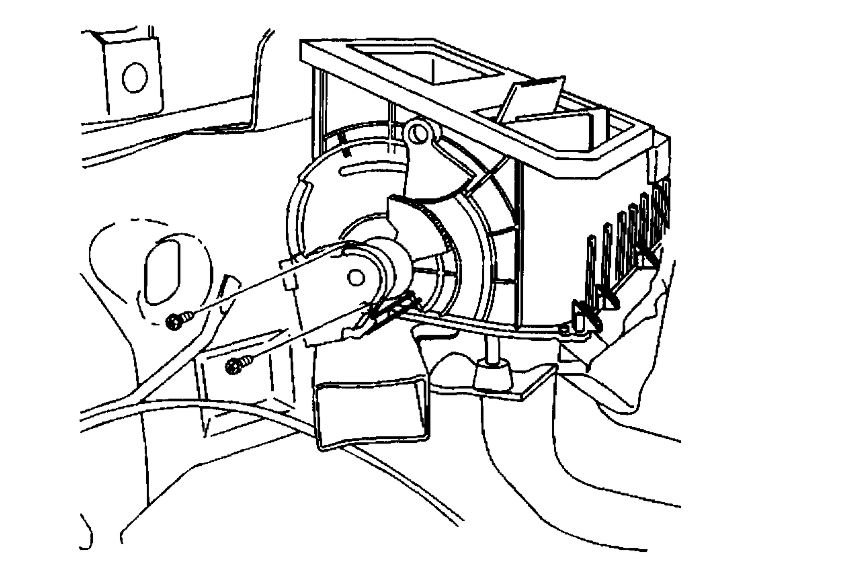

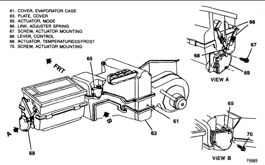

From my research I believe I need the blend door actuator located below the steering on the end of the unit. I have the part. Is that the only actuator that I have to worry about on this year truck? Also, I have the clicking noise from the right side of cab which is common on these trucks, what is that unit called? Also, where can I download the diagrams for the complete A/C heating unit for this year? Also, I'm looking for a 1990's truck club group, anyone know? Thanks.
DANNY L
  • 5,648 POSTS
Hello, I'm Danny.

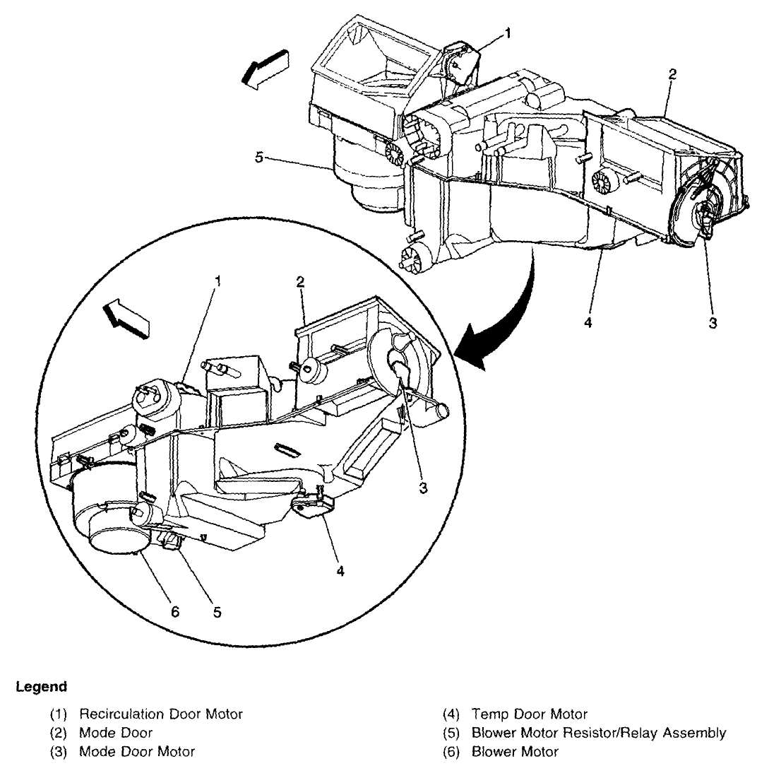

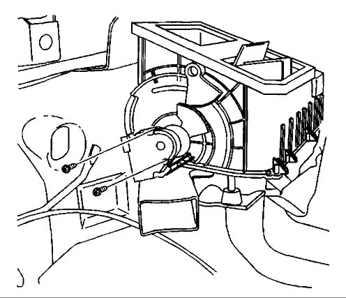

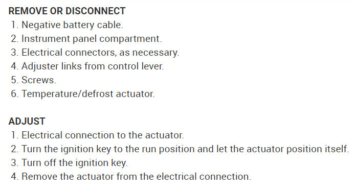

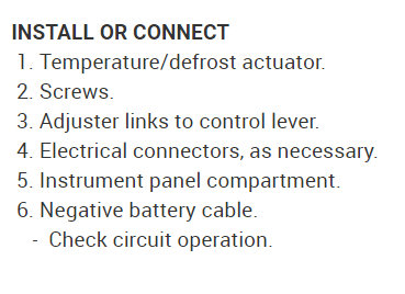

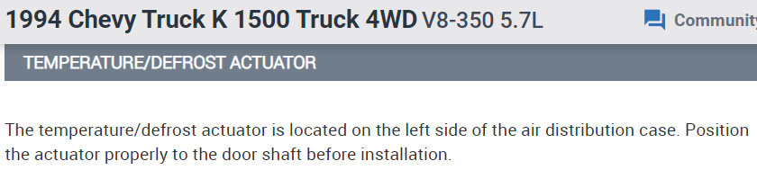

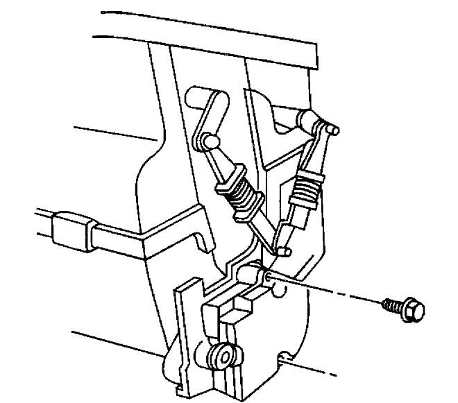

Yes, it sounds like you are having an issue with the temperature-defrost actuator. Here is a tutorial showing how to change a blend door actuator which is similar:
I've attached picture steps below on how to change the temp-defrost actuator for your truck. I've owned 2 K1550's myself a 1997 and a 1989. Attached my pictures below for you. If you are on Facebook there is a group-site for us. Here is the group name-
GMT400.com (88-98 GM full size trucks) Let us know if you have any further questions on this issue. Hope this helps and thanks for using 2CarPros. Happy New Year.
CARLOS ORTEGA
  • 8 POSTS
Great! Thanks, the tutorial was a little different since mine is in a different spot but same concept. The only question I have is, it says to turn ignition key on to run position and let the actuator position itself, then turn off. Does this happen without the A/C turned on? Or does it need to be on? Thanks! I have the part, I just want to make sure I do it right with no problems.
DANNY L
  • 5,648 POSTS
Hello again.
I would leave the A/C off but the defrost on so the actuator can position itself. Keep us updated after the install if you have any further questions on this issue. Did you find the Facebook site I recommended? Hope this helps and thanks again for using 2CarPros.
