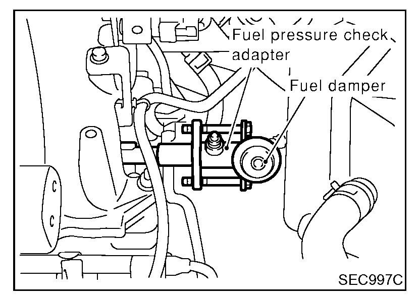

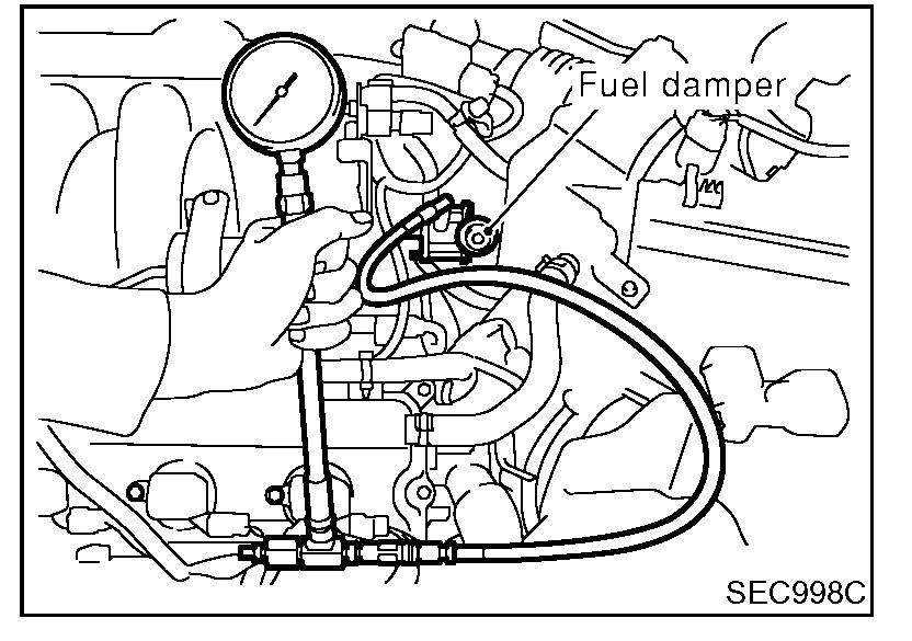

When you crank this car it runs fine idling but as soon as you press the gas pedal the engine revs high then low and no pressure on pedal when you push to floor.

Next, since there is an issue with power, the first thing I am suspecting is there is an issue with a weak fuel pump. Test fuel pressure to confirm there are no issues there.
Here is a link that shows in general how it's done:
Here are the directions specific to your vehicle for testing fuel pressure. The attached pictures correlate with the directions.

pic 1
1. Perform fuel pressure Release Procedure to zero.
2. Disconnect fuel tube joint between fuel damper and injector tube and set fuel pressure check adapter (J44321).
pic 2
3. Install pressure gauge to the fuel pressure check adapter as shown in the figure.
4. Start engine and check for fuel leakage.
5. Read the indication of fuel pressure gauge.
At idling: Approximately 350 kPa (3.57 kg/Sq cm, 51 psi)
6. If results are unsatisfactory, go to next step.

Let me know if this helps. Also, let me know the results. Please keep in mind, I am basing this on the idea that the check engine light isn't on. If it is, there are other things which can cause it, so let me know.
