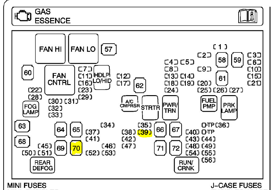

Here is what we need to do. First, fuses 39 and 70 in the under-hood fuse box are what send power to the blower motor. These fuses should have power at all times. I need you to check the fuse and confirm there is power available.

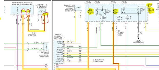

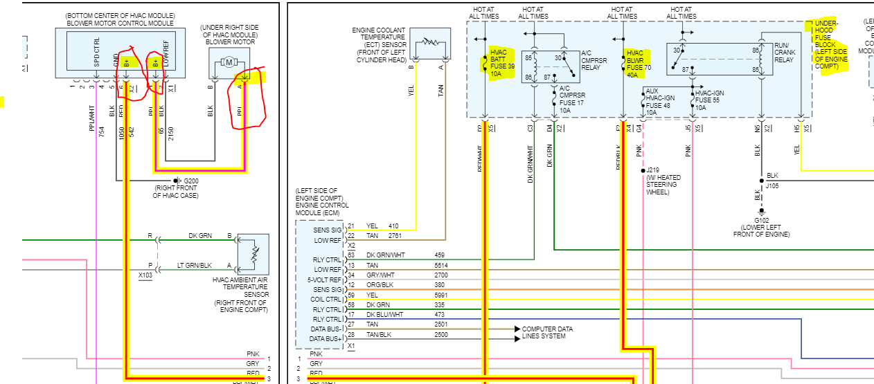

If there is power present, we need to bypass the blower control module and locate the purple wire at the blower motor. With the fan requested on and the key on, see if there is power at that wire. If there is, then we know the blower motor has failed.
Let me know what you find or if you have questions. I attached a portion of the wiring schematic below so that you can see what we are dealing with. I highlighted wires related to the power supply. Also, pic 2 shows the fuses to check inside the fuse box.
