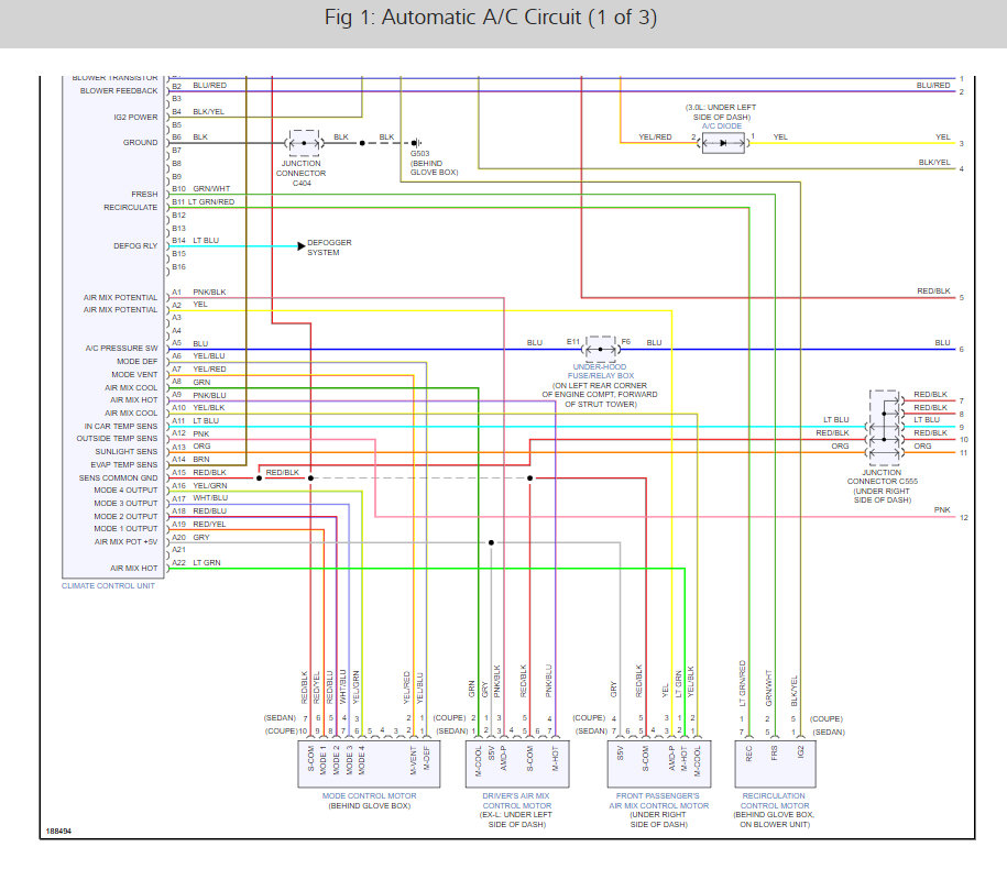

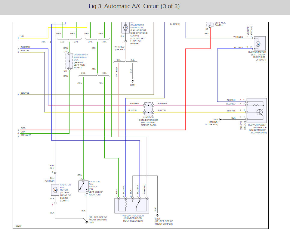

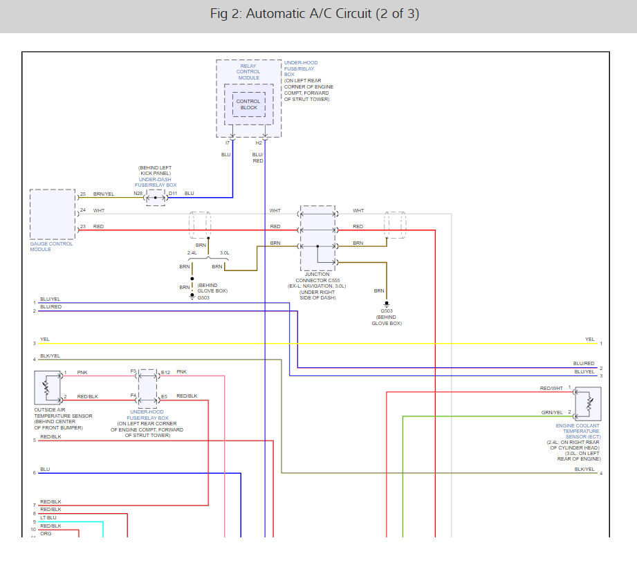

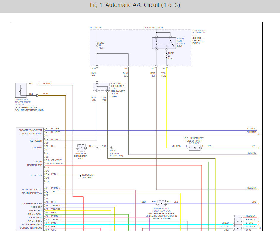

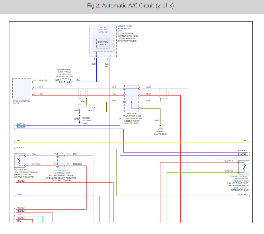

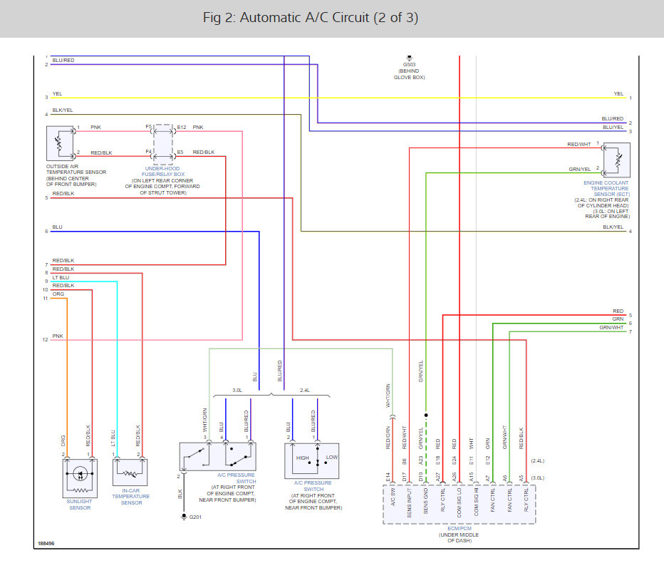

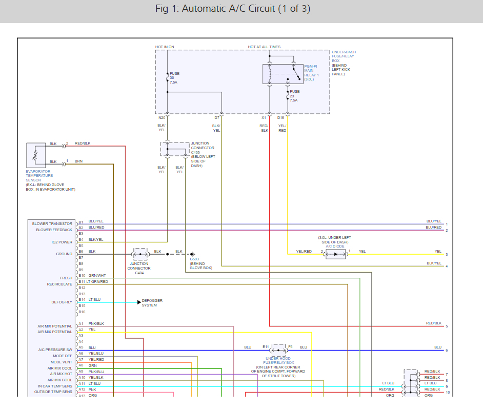

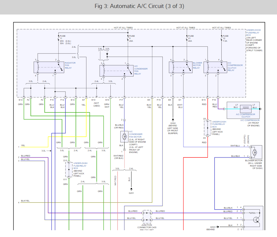

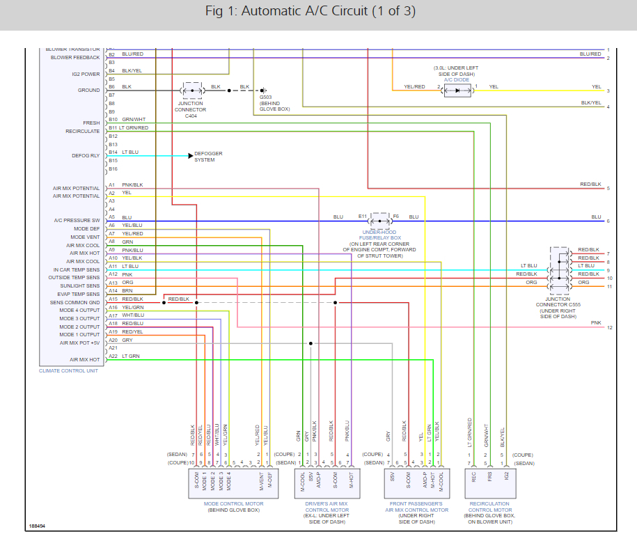

Hello, I just bought this car. Everything works on the controls just the AC display does not come on therefore can't control it.
Friday, April 19th, 2019 AT 7:45 AM
22 Replies
SCGRANTURISMO
  • 4,897 POSTS
While the extended warranty has run out, It does give you instructions for troubleshooting, repairing, and the part number of the the part that will need to be ordered in order to fix the problem.
Please go through it and get back to us with what you are able to find out. I have included it in the diagrams down below.

ENAVARRO
Thanks for answering my question before I purchase new a new control panel. Just want to let you know that everything works the audio button works I can see the display the CD player works I can see the display the XM radio works I can see the display but can't see the display to control the inside fans and AC.
Tuesday, August 25th, 2020 AT 1:46 PM
SCGRANTURISMO
  • 4,897 POSTS
Okay, in the diagrams down below I have included a factory troubleshooting guide for the HVAC controls on your vehicle. Please go through them and get back to us with what you are able to find out. It will call for you to use a multimeter, so I have also included a link below for you to go to if you are unfamiliar with how to use one.
Here are the air conditioner wiring diagrams. Check out the diagrams (Below). Please let us know what you find. We are interested to see what it is.

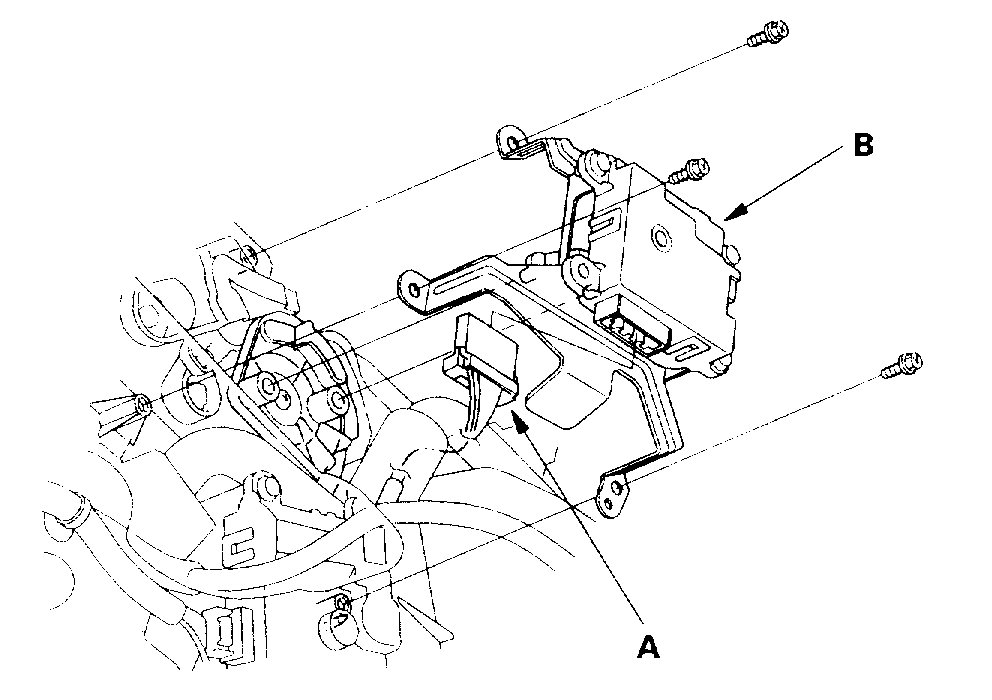

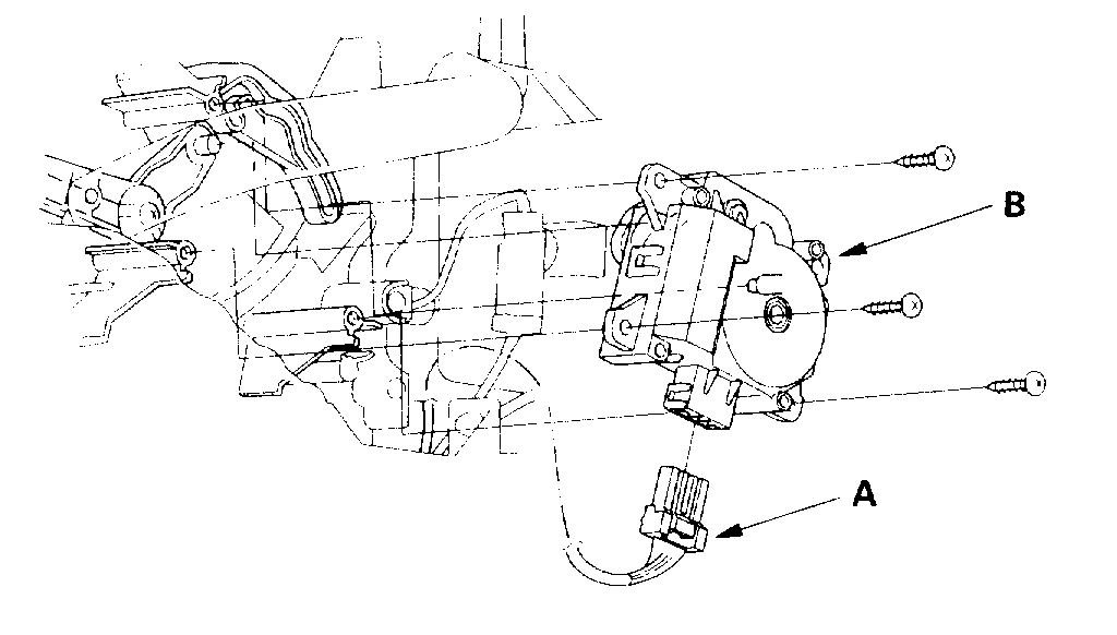

The directional buttons on my AC is not functioning. It otherwise functions properly, blowing hot or cold are. What could be causing this?
Thursday, December 17th, 2020 AT 10:30 AM (Merged)
  • 110,194 POSTS
Hi.
If the air flow doesn't change directions, it sounds like an issue with what is called a mode door actuator. That is the component that changes the air flow direction.
Here are the directions for replacement of the actuator. However, before getting a new one, check the existing one and confirm it isn't responding when you change flow direction.
The attached pictures correlate with these directions.
____________________________________________
Mode Control Motor
Vehicle Heating and Air Conditioning Air Door Actuator / Motor Service and Repair Procedures Mode Control Motor
MODE CONTROL MOTOR
Mode Control Motor Replacement
4-door
1. Open the glove box. Remove the damper from the glove box, then let the glove box hang down.
Pic 1
2. Disconnect the 7P connector (A) from the mode control motor (B). Remove the self-tapping screws and the mode control motor from the heater unit.
3. Install the motor in the reverse order of removal. After installation, make sure the motor runs smoothly.
2-door
Pic 2
2. Disconnect the 10P connector (A) from the mode control motor (B). Remove the self-tapping screws and the mode control motor from the heater unit.
Let me know if this helps.

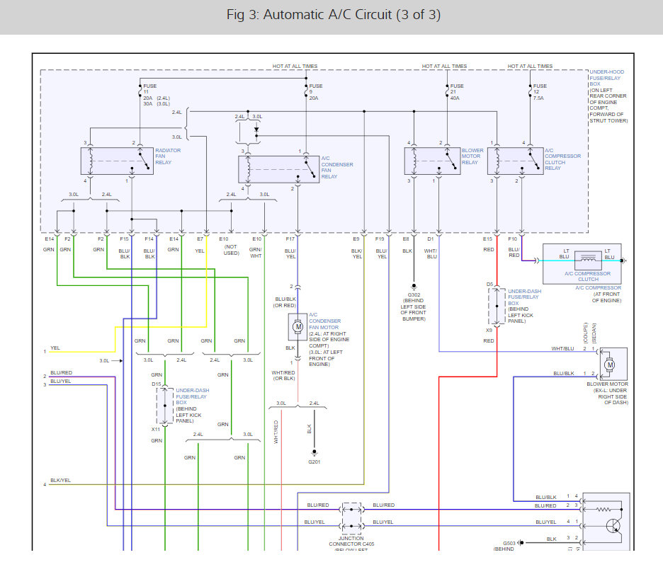

The A/C doesn't work. I didn't hear running noise from condense fan. I checked fuses under hood is fine. What are problems possible?
KHLOW2008
  • 41,814 POSTS
Hi chinafjw,
If there is insufficient gas, the compressor will also not work. It could be due to the control panel. Are the various vent positions functioning well? this guide will help us fix it

A/C clutch will not engage.
  • 110,194 POSTS
Welcome to 2CarPros.
This could be a result of different things. Is the system properly charged? If it is too low on Freon, it won't engage. Also, is this something that happened all at once?
Here are links that explain how to check for an AC not working. Additionally, I will add a link that shows how to add Freon.
https://www.2carpros.com/articles/air-conditioner-how-to-add-freon
Take a look through these and let me know if you have additional questions or need help.
