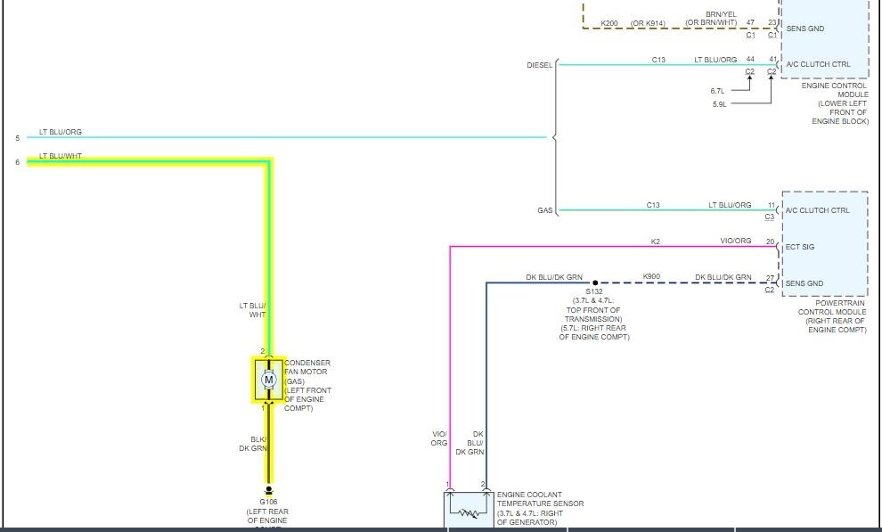

Good afternoon,
Does the A/C work? If it does. can you give me the high and low pressure readings?
The radiator cooling fan should come on at 208 degrees and go off at 180.
https://www.2carpros.com/articles/how-an-electric-cooling-fan-works

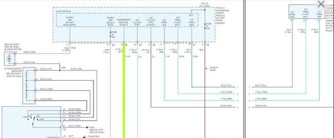

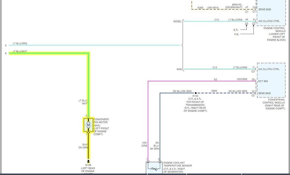

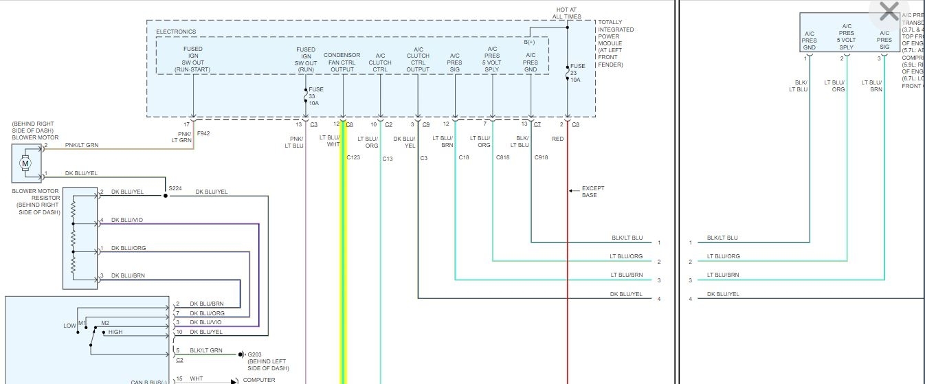

I attached a wiring diagram for you to view. You need a test light or voltmeter to do some tests.
OPERATION
The A/C condenser fan used in gasoline engine equipped models (except SRT 10) is controlled by the powertrain control module (PCM). When the A/C-heater control is set to any A/C position, it sends a request signal on the CAN-B bus to the totally integrated power module (TIPM), which then transfers the request on the CAN-C Bus to the PCM/ECM, which sends a signal on a dedicated hard-wired circuit to the totally integrated power module (TIPM) to energize the internal A/C condenser fan high side driver. When energized, the A/C condenser fan high side driver provides battery current to the condenser fan motor.
The A/C condenser fan control system is diagnosed using a scan tool.
The components of the A/C condenser fan cannot be adjusted or repaired and must be replaced as an assembly if found inoperative or damaged.

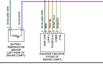

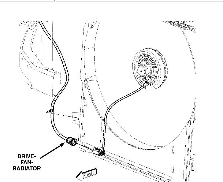

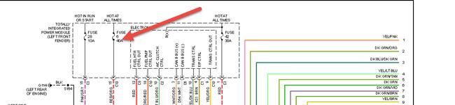

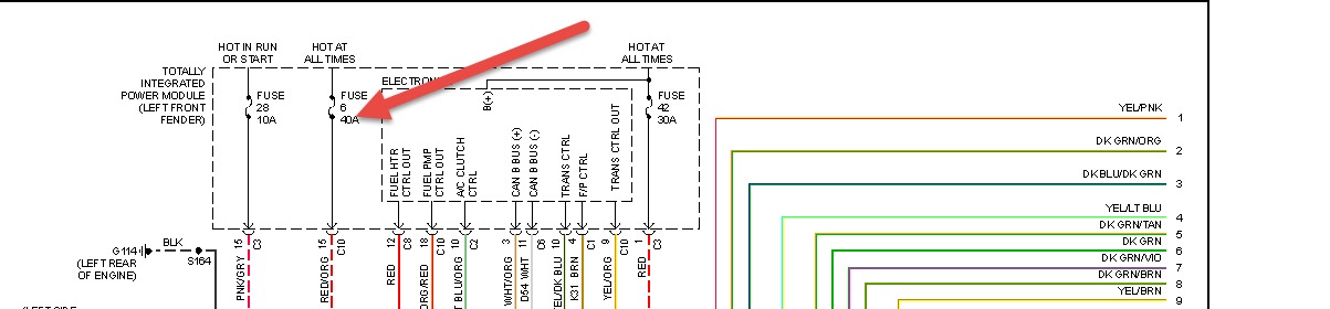

what would happen with your air if no fan cooling is that you would get cooling for a while then it would stop. your fan on your truck is electronically controlled and should lock up as temp gets warm or if pcm calls for it. there is a fuse and am sending the pic of where to check for it. what the guy was probably trying to explain is that maybe the harness is broken under the engine hard to tell. see pics for fuse and other pic is of fan controller.

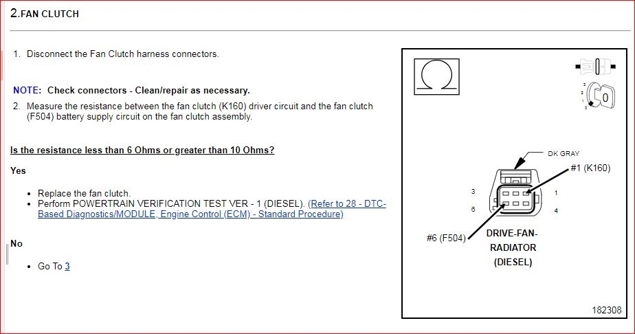

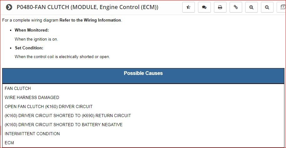

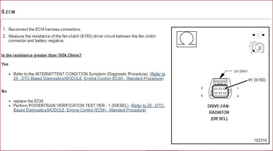

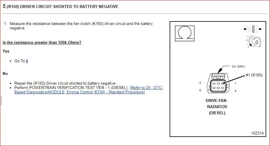

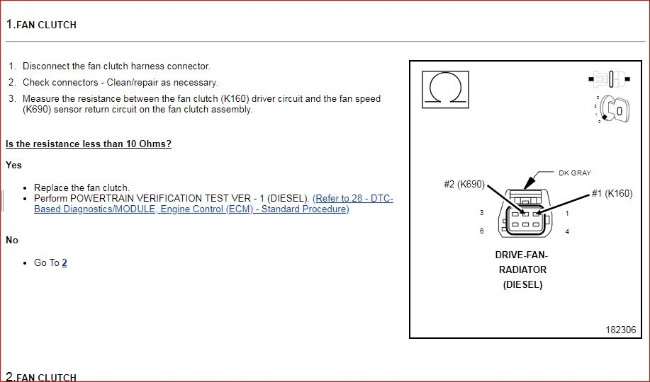

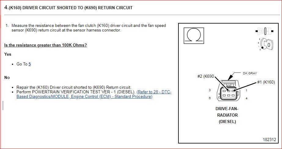

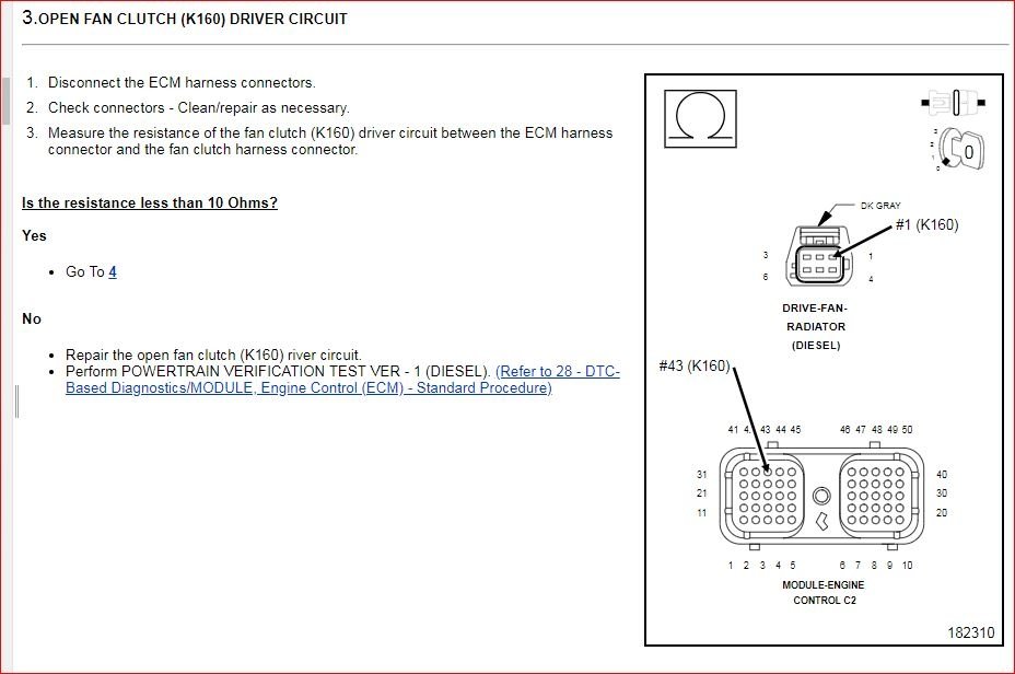

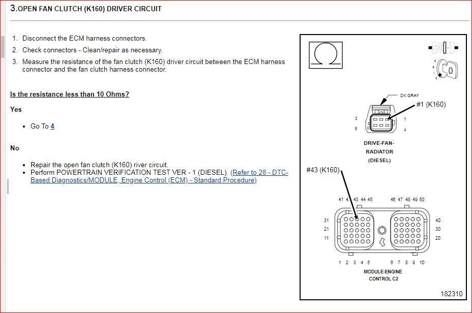

What is the code that you are getting? Is it P0480? Is it just one or are there more? Please provide all of them if possible.
If it is the P0480 then here is the diagram for this. If there is another one, I can send that as well.
I doubt you are in limp in but it is possible if you have a greater ECM issue. Do you notice if the engine is getting hot? If the temperature is rising this would be more likely to explain your driveability issues. The ECM is degrading the engine to keep it from overheating. If this is the case, fixing the fan issue should resolve everything.
Let me know and we can go from there. Thanks

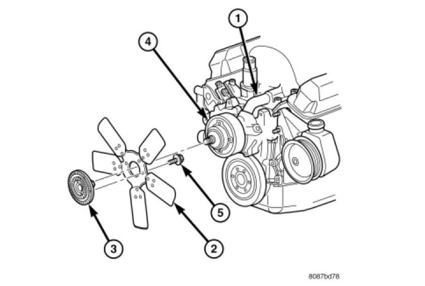

I have seen the cooling fan relay go out and cause this problem.
here is a video to help you swap it out:
https://youtu.be/_wyb8rr6EWI?si=A5v0J4bUiw-2k8vz
Please go over this guide and get back to us.
