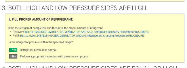

Here is a rule of thumb I always follow:
If the low side is low and the high side is high, there is likely a blockage such as an orifice tube or H block.
If the If the low side is high and the high side is low, then I would suspect a possible compressor.
If both are low, then add Freon
If both are high, normally it is over charged.
__________________________
If you look at pic 1, it is straight from the manual if both are high.

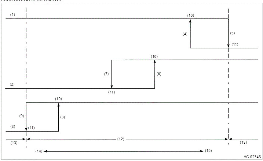

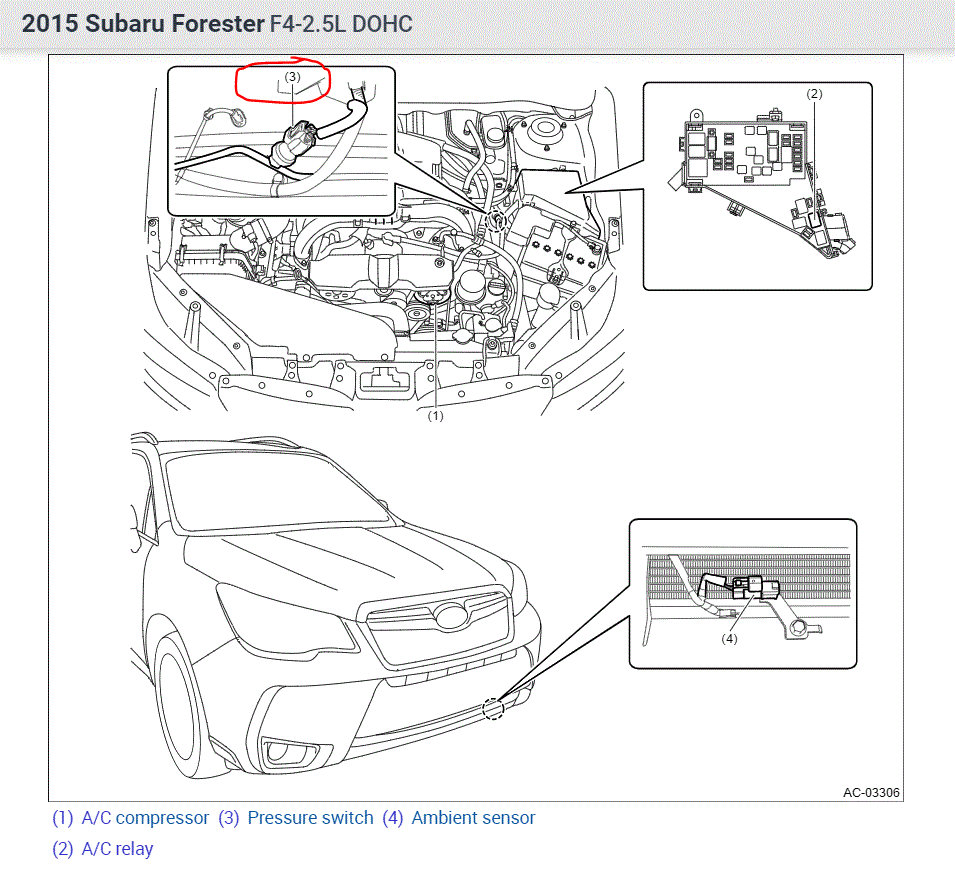

Next, the pressures switch on this vehicle is referred to as a triple pressure switch. It controls high, medium, and low pressure.
Here is the test procedures for checking it. The attached pics correlate with the directions.
_______________________________________________________
Pressure Switch (Triple Pressure Switch) - Inspection
Vehicle Sensors and Switches Sensors and Switches - HVAC Refrigerant Pressure Sensor / Switch Testing and Inspection Component Tests and General Diagnostics Pressure Switch (Triple Pressure Switch) - Inspection
PRESSURE SWITCH (TRIPLE PRESSURE SWITCH) - INSPECTION
INSPECTION

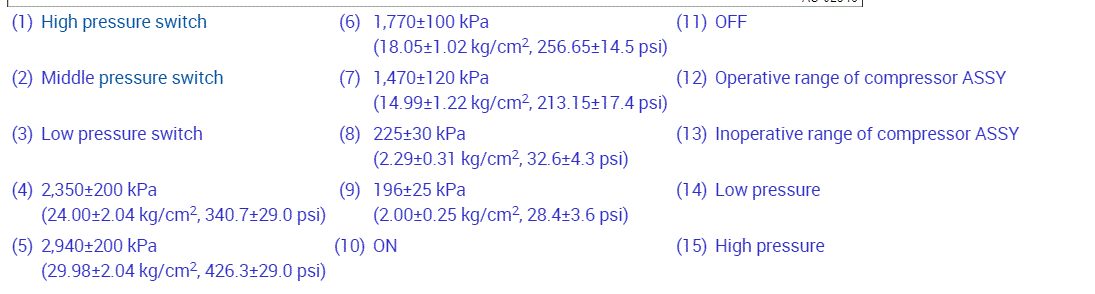

1. Connect the manifold gauge to the service valve on the high-pressure side.
2. Disconnect the connector.
3. Start the air conditioner, and check the operating pressure of switch by turning the compressor assembly (magnet clutch) to ON/OFF. Operation of each switch is as follows.
See pic 2
See pic 3
Note:
High pressure switch turns the compressor assembly (magnet clutch) to OFF when the refrigerant pressure becomes extremely high to prevent the evaporator, air conditioner piping and expansion valve from getting damaged or frozen, etc.
The middle pressure switch is used to effectively control the radiator fan output by judging high load/low load in normal pressure range.
The low pressure switch detects a refrigerant shortage and deactivates the compressor assembly (magnet clutch) if the refrigerant pressure is abnormally low. (Because any further compressor assembly operation in such a state may lead to compressor seizure)

The last pic I attached shows the location of the pressure switch.
Let me know if this helps.

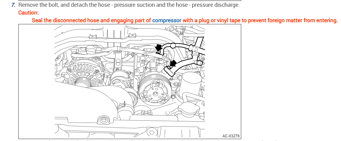

Once the system is empty please follow this guide:
Remove the lines at the compressor image below and video the inside of the compressor and refrigerant lines please. Upload the video in your response. Check out the diagrams (below). Please let us know what you find.
