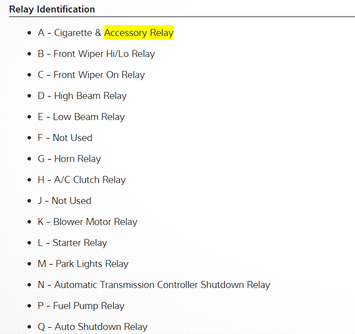

Update on this issue:
I remember that I removed the park light relay before because the park lights stay lit even when the switch is off. I found out too that when I put the park light relay back in, the blower works but only when the park light relay is in.
The blower relay is intact, but won't run the blower when the park light relay is not inserted in the terminal.

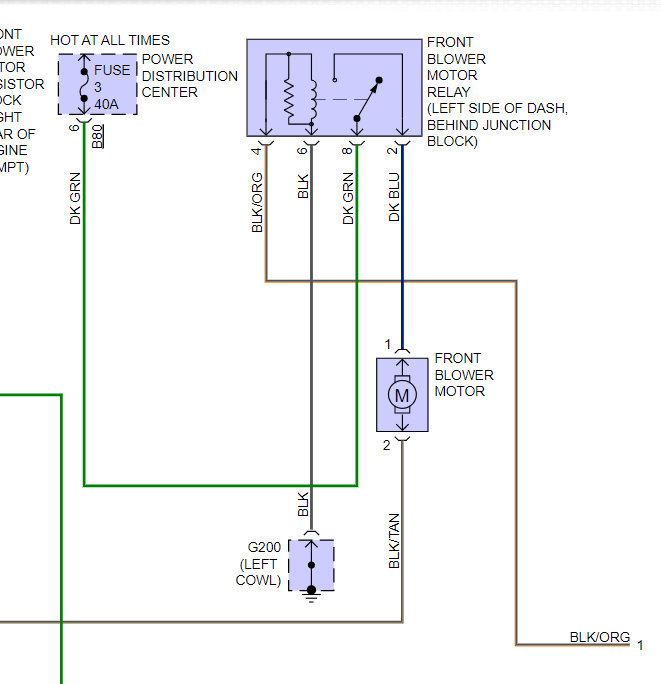

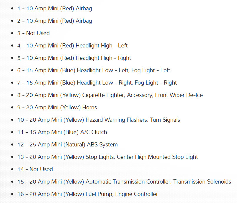

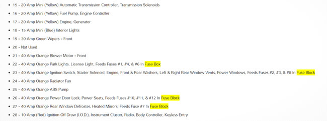

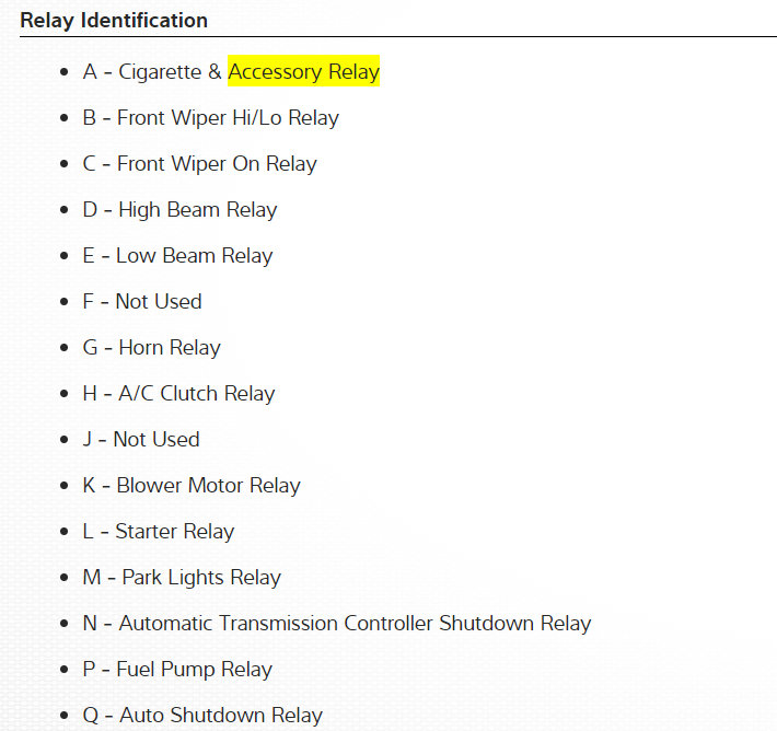

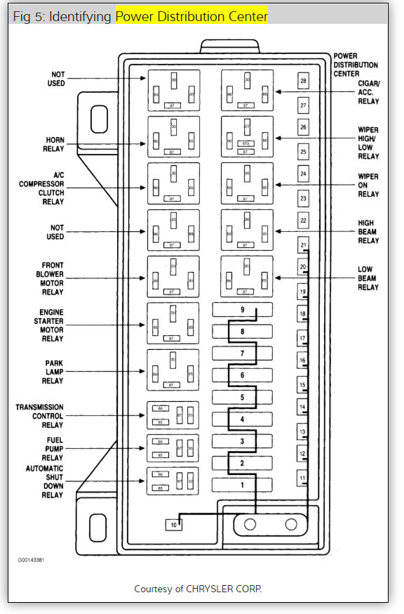

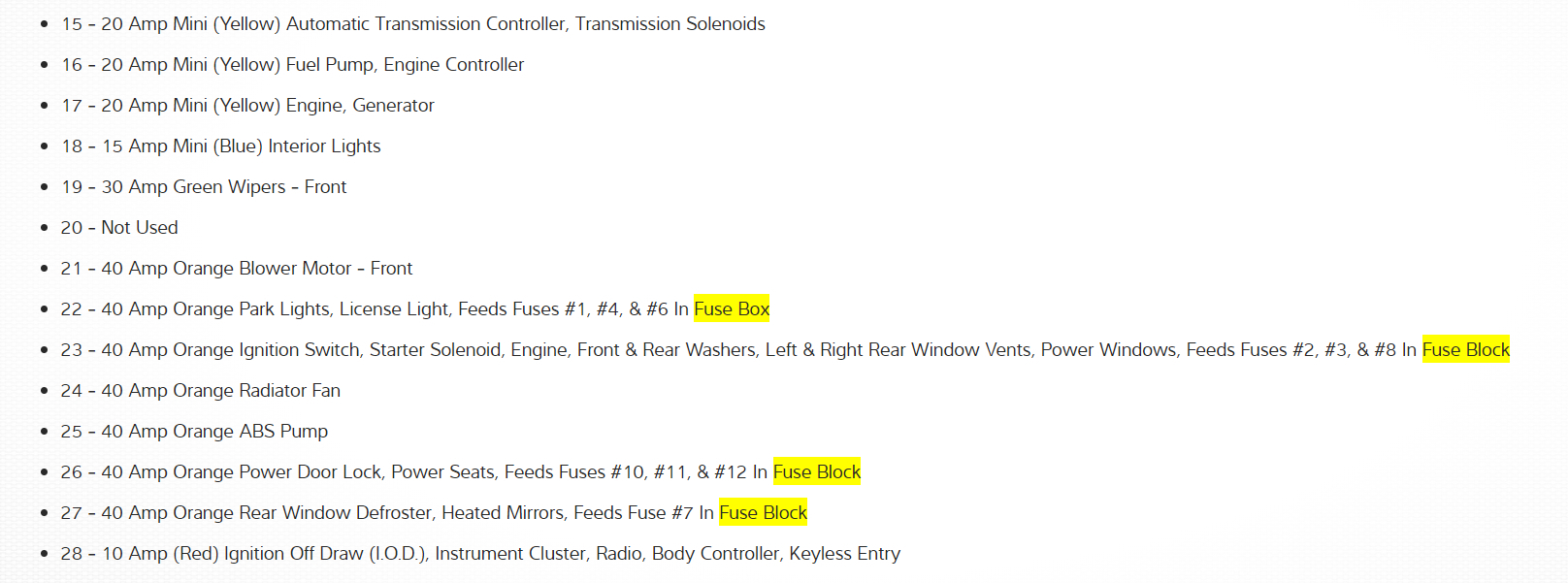

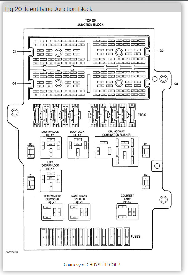

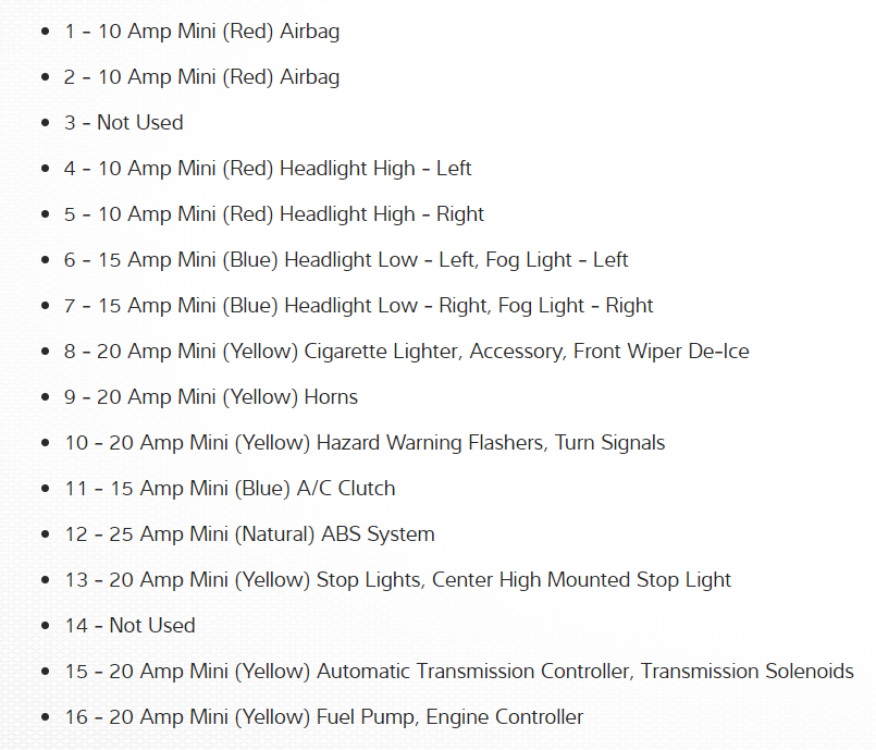

This sounds like two separate problems we will handle the blower and wiper operation problems on this thread please start a new question for the "The power door locks keep on locking and unlocking intermittently by itself."
We need to check for power at fuse # 3, 40 amp and fuse #9, 30 amp in the power distribution center. Here is a guide to help you and the blower wiring diagrams to help you see how the blower is powered. Here are the fuse location as well.

Here are my findings:
-All fuses have power.
-Blower works only when Park Lamp fuse is in, with A/C button and vent button blinking.
-No parking lights.
-Interior lights stay on the whole time, turn off only when Dashboard illumination is switched off; Driver and Passenger reading lights remain on too, and TURN OFF only when Dashboard illumination switch is turned on.
-Power door locks don't work on the door switches, but only with remote keyless entry.
Please advise.

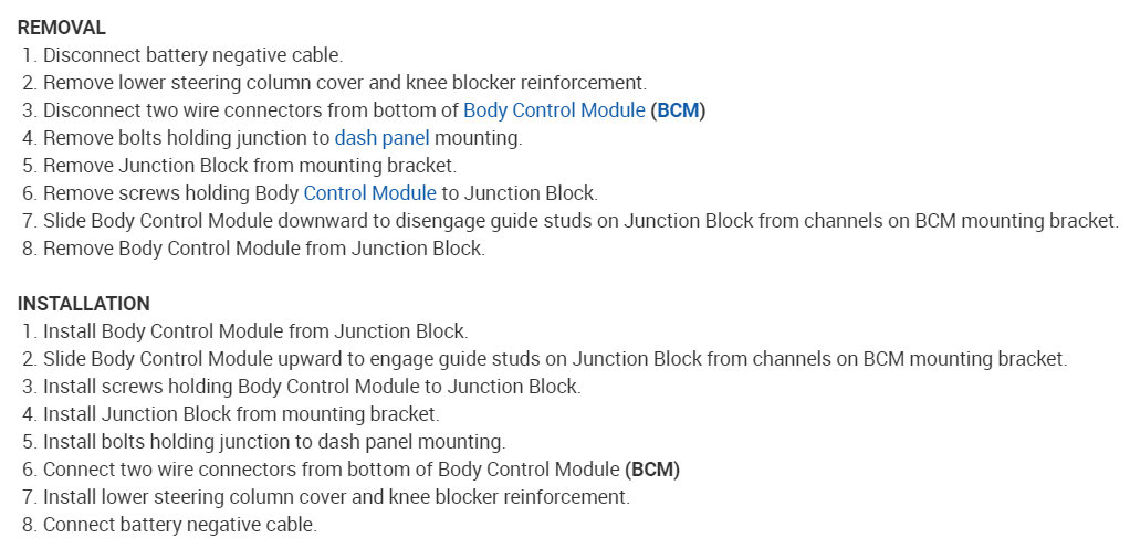

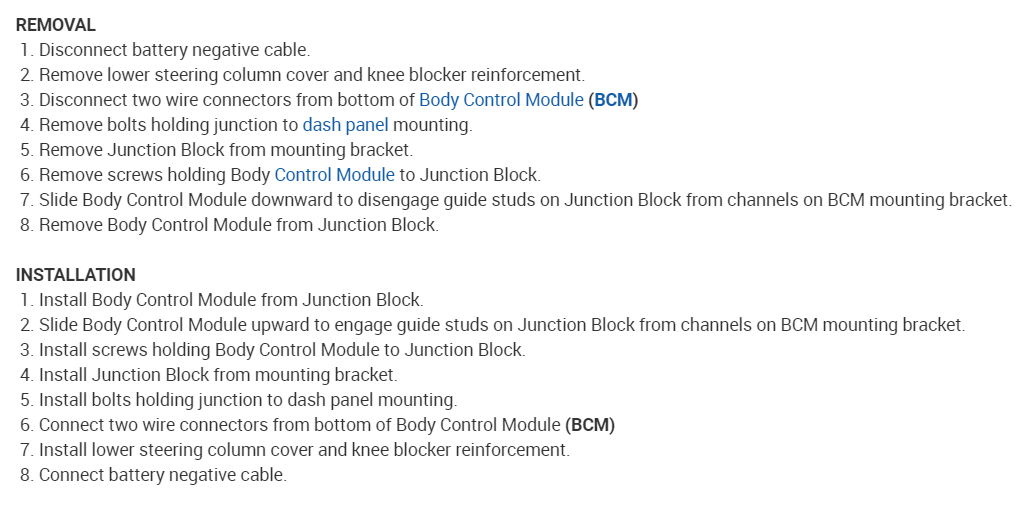

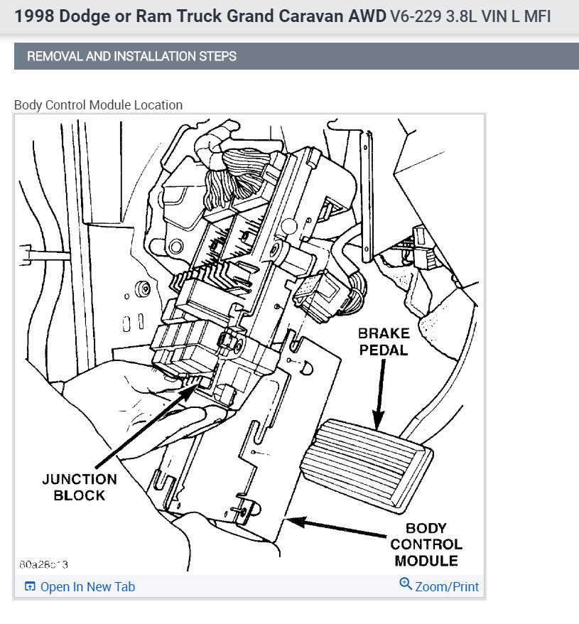

It is starting to sound like the BCM is out. To be sure, let's do a CAN scan to confirm the failure. Check out this guide and video, here is how you can change the BCM out.
Saturday, June 25th, 2022 AT 5:22 PM
REDCRU777
  • 84 POSTS
Hi Ken,
Sorry for this delayed update. I pulled out the BCM and ordered a replacement.

I got the BCM replacement and had it installed. All the problems: door lock actuators, front and rear wipers/washers, and A/C blower are all now working normally.
The only issue now is the park lights. It won't turn on. The park lights fuses and relay are okay, but when I remove the park light relay, the A/C blower won't work.

Actually, it was one of the issues before the BCM was replaced.
The difference is, with the old problem, the park lights won't turn off, and the only way to turn it off is to remove its relay, but the A/C blower won't work.
The issue now is, the park lights won't turn on, but the A/C is working fine, but only if the park light relay is in.
