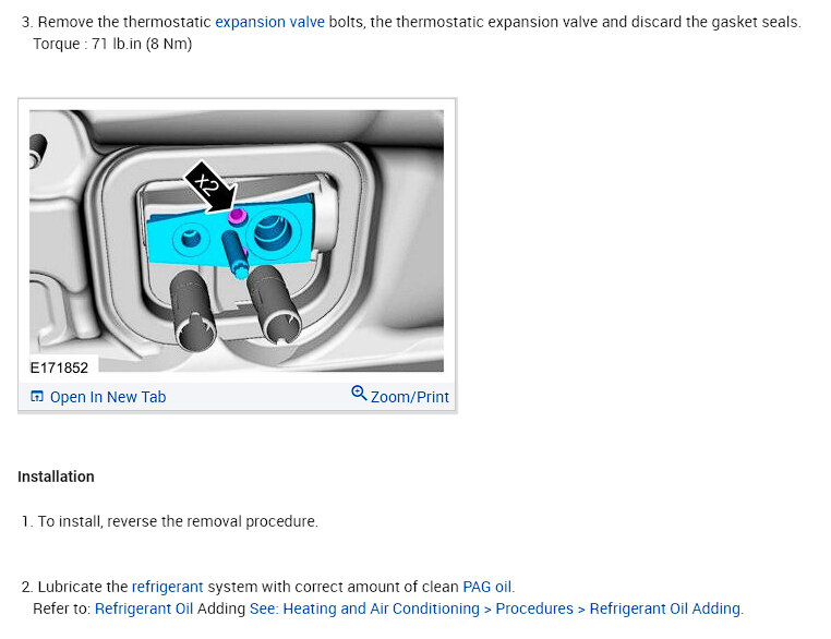

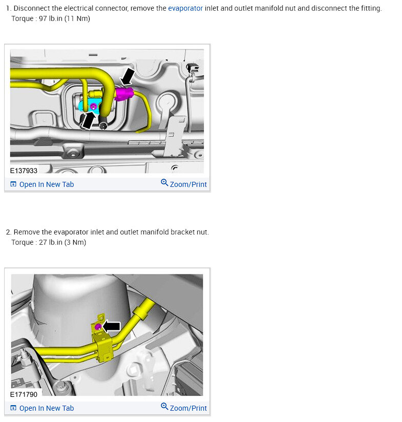

Looking for a diagram of the exact location of the expansion valve for the air conditioning system.

It's located on the firewall under the cowl panel. You can follow the larger diameter A/C line from the passenger side strut tower.
