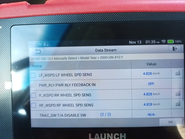

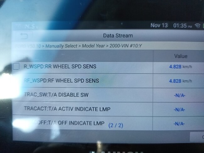

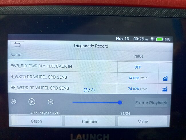

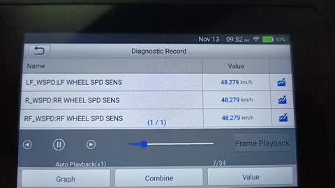

I am too. And disappointed they act like they don't want to mess with it. Well I did that test you talked about as best as I could kind of hard to take pics of the scanner while driving with one hand on the steering wheel and the other on the hand and brake control lol I had to do it while I was at the light (stopped). But all 3-wheel sensors reached 68.0 while driving.

Yeah what some car shops will work on one thing and not some other things USA Oklahoma. Well I did that test. Here are the pics I managed to get while at the stop light.

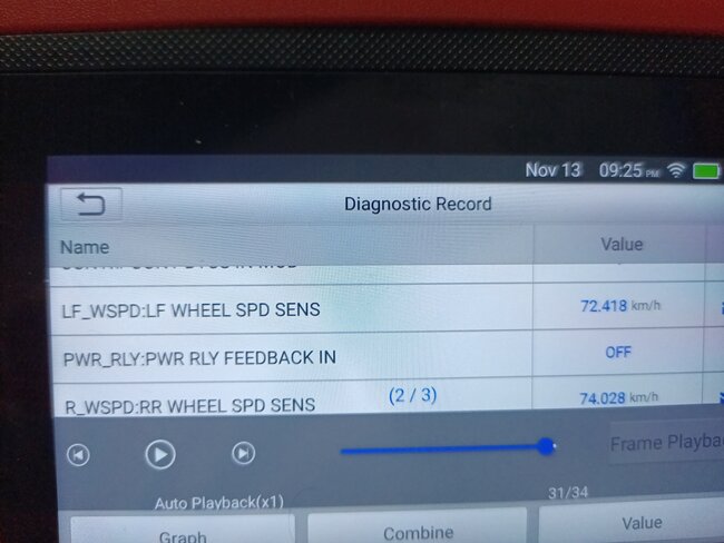

I'm sorry I forgot to post the pictures. In the first picture is when I stopped at the stop light. I have a short video on my scanner but I don't know how to get it off of there etc. And thank you CARADIODOC for your comment and you make some very interesting points too. I never thought about that.

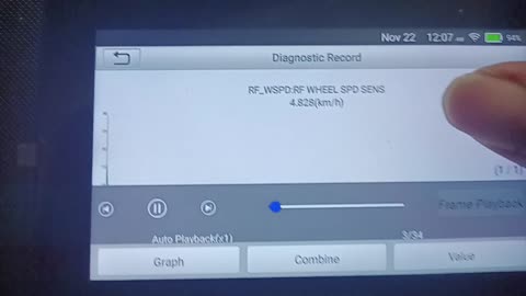

Last picture and here is the video too (sorry for so many post etc.) In the video you will see the speed sensors read 4.8 that's when I stopped at the red lights etc. But you guys know that already.

Okay, now that I know what you have for a scan tool. Select just the front sensors and the rear and switch them to graphing mode (the little hill looking thing on the right) now go drive on a rough road and then stop and look at the graphs. What you are looking for is drop outs in the signal, which is all that is needed to cause this. Then we can discover why. If there are no drop outs but the light is still on, then it could be the module itself not reading the signal internally.

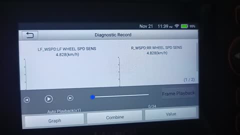

Okay, here is the graphic of the LF and RR speed sensor. The right front does the same thing. As the LF. Etc, I hope it's not the ABS module, because if it is. That's the end of that. Ford discontinued the ABS module for the 2000 Ford e-150 Eco van. And so far, I know of no auto parts stores that carry it. At least not where I live anyway. My last guess could be wrong with it is the brake booster or the ABS module.

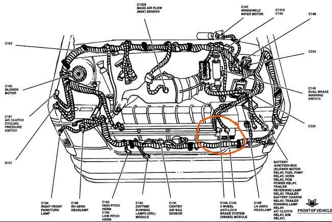

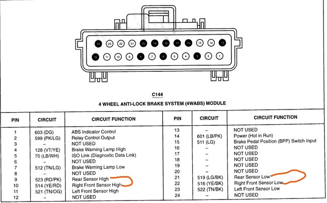

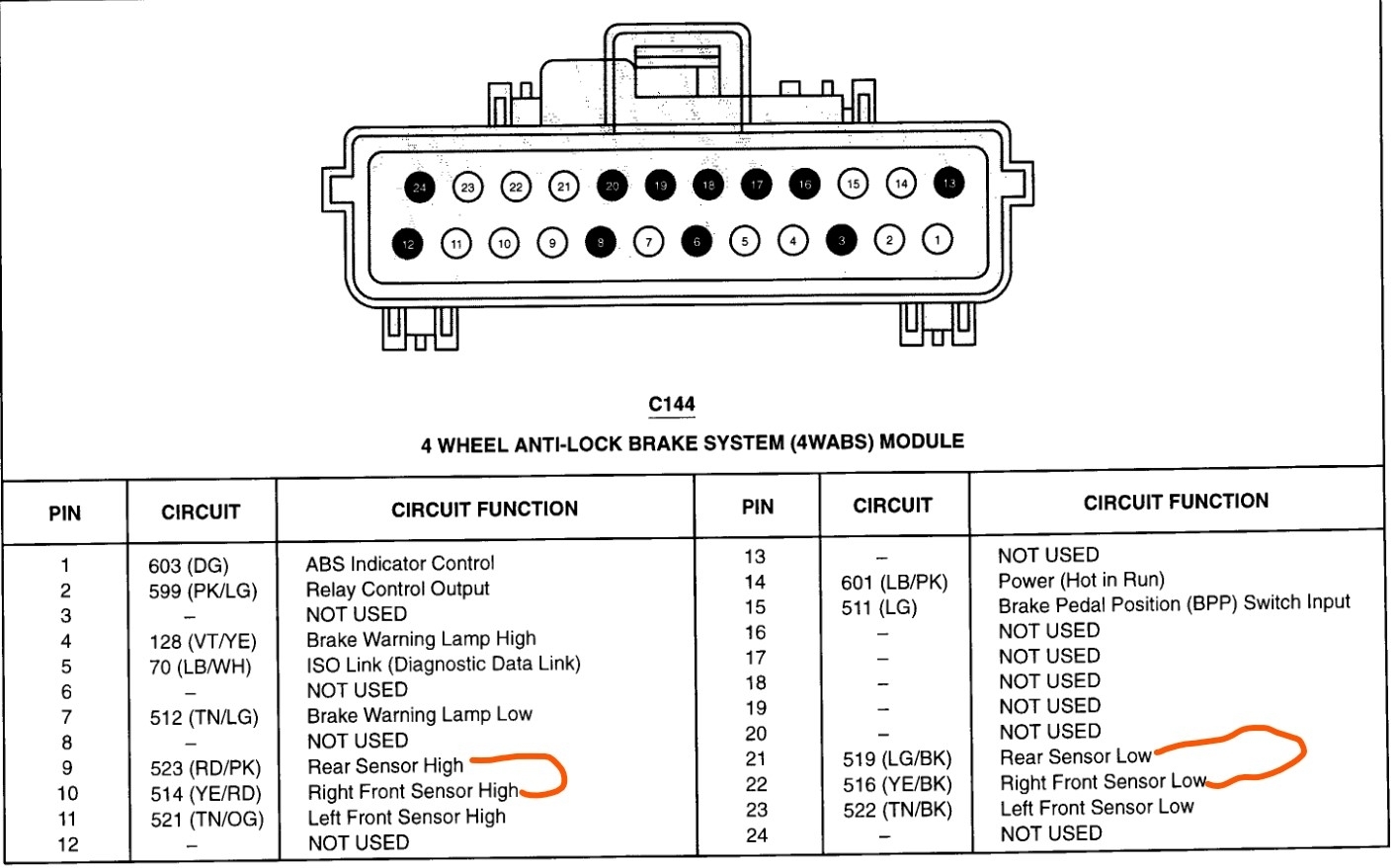

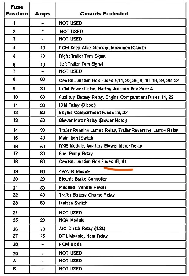

Yeah that doesn't look good, but we have another test that should tell you once and for all. It is a substitution test. You know the fronts are good and the rear is suspect. So, what we will do is "swap" the sensor inputs at the ABS Module. Basically, you know the sensors are sending data, but if you were to take the right front signal and send it to the rear input and it still showed the rear as the problem you know it's the module. Which can be found used,
To do that we would find the ABS module harness and swap the wires shown in the picture, either by cutting them or depinning. If you still see the same issue, then it's the module.

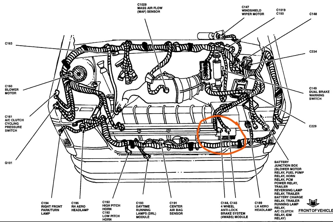

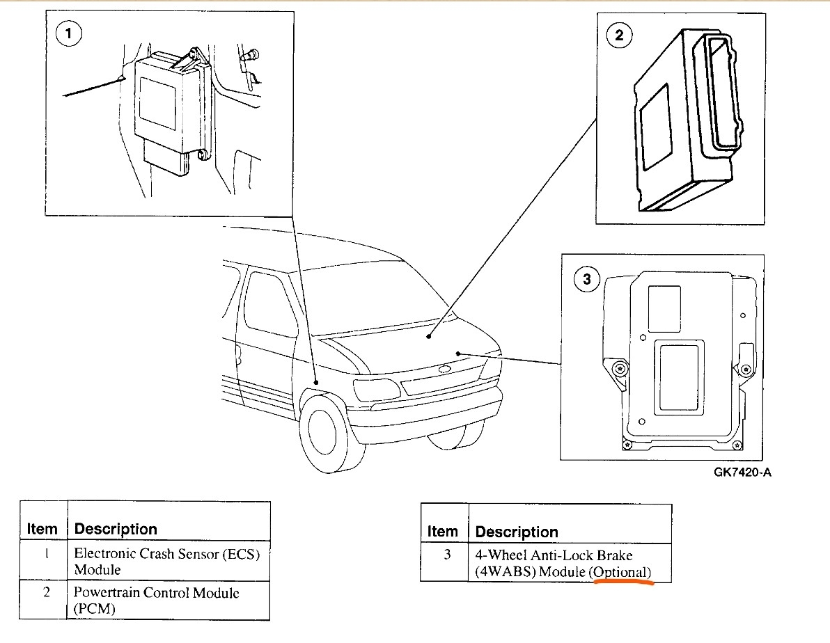

Now there is another option but I'm not going to tell you, but if you look in the location picture you might see something underlined. You had the brakes repaired and they work, while the light is on the ABS is off and it drives like a van without the optional ABS. If you can deal with that it's possible to turn off the ABS and the light in one step. Remove the optional ABS. I drove a lot of vehicles that way because I grew up on RWD and no ABS so many got the connector unplugged in my GMs.

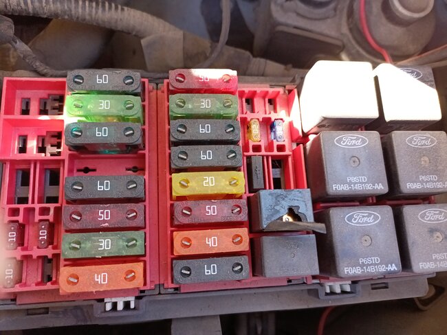

Hissing is usually a sign of a vacuum leak in the booster, unless it is momentary. Like you step down and hold the pedal and it stops it's likely just a valving issue, if you step on the pedal and it hisses the entire time that's a leak. It sounds like the ABS is intermittent as well. If you were to pull fuse 19 in the under-hood fuse box it should deactivate it and let you see if it is the ABS causing the jerky stops.

Okay, let me see if I can get someone to check this for me. Okay, I pulled the fuse 19 under the hood in the fuse (the fuse wasn't blown either) box like you said (and just did a short drive etc, ) and yeah, it stopped jerky when putting on the brakes and that sound I was telling you about went away too. I can live without the ABS system if I have to. But now the ABS light stays on all the time now. Also too. I seen a fuse under there that had a hole in it. I don't know what fuse it was related to as I forgot to write it down. But I will go back out there and look up what fuse that was. Well it was one of those big relay looking fuse is the one that had the whole in it. Someone covered it up with a piece of duct tape.

STEVE W.
  • 15,671 POSTS
Well, that relay isn't very secure any longer, I suspect they tried to remove it and damaged the case. That is the trailer running light relay. Removing fuse 19 would have disabled the ABS system (not the light but the ABS module and sensors). As that stopped the jerking and the hissing then it sounds like the ABS control module is the faulty part. With it partially operating it is trying to engage and disengage while you stop. Doing the sensor swap would pin it down but with your situation it may be a while before you can find a shop that can actually do the testing without just swapping out expensive pieces for you to pay for.
As such you can still drive it until you get it repaired but to turn off the light would require you to remove fuse 19 and Fuse 1. That should turn off the ABS system fully. It may not turn off the light, Ford did some strange wiring with it and used another fuse to power the light. If the brakes now work without the jerks and noise, then it is the ABS module itself that you would need to replace. You might try www. Car-part. Com to see if some yard near you has a used one, they could ship.
There is also the option of bulb removal to turn off that light if fuse one doesn't but that would be entirely your choice.

First Steve W. I want to thank you for all of your help. It helped me out big time. Thank you so much! :-) And okay, I will have to have someone pull fuse 1 / Fuse 19 is already removed. I just never had the person put it back for me. It is frustrating as heck know what to do to your vehicle and not being able to do it. But I am a happy man at this point at least I know what is problem now. Thanks again Steve W. I will keep you post as to what I can find on that website you suggested. I have seen one site that might have one, but ABS modules cost $600.00 to $800.00 someone told me. If I am lucky enough to find one new. But if I can find an old one. That is fine with me. Quick question, is the ABS module on a Ford van in the front of the van (under the hood) like it is on your diagram?

Yes, it's up front under the hood. That site should show you salvage yards to look at. It's a sort of watered down version of the Hollander interchange that the yards themselves use to look for parts.

Cool. Here I was thinking it was stuck way underneath the dashboard somewhere. Okay, since I know where it is I just need to find someone again to see if they can do that sensor swap you were talking about. But that may take some time to find someone that can do that for me. Finding people who know what they are doing is really hard to do. Thank you for your help once again Steve W. This also helps me as to if a repair guy tells me if he put in a new abs module and I can see if he does or not etc. But that's down the road though to repair that if necessary, etc.
