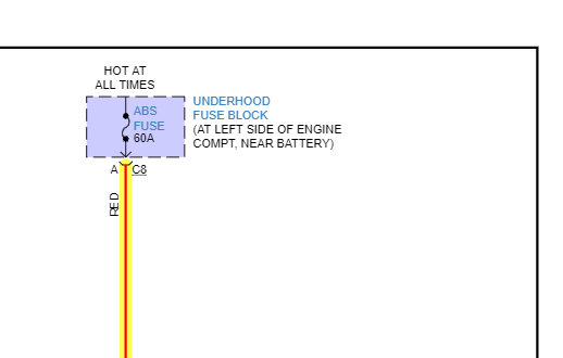

As you are getting ABS codes it could point to a bad sensor, however if the speedometer works it isn't the sensor as it uses the same signal. If the odometer display went blank the common problem is a failure of the FET that provides power to the display, or the resistors for the display have cracked free. If you want to see the repairs for that and are good with a soldering iron you can look for a YouTube channel called jeffescortlx he has a number of videos on the GM clusters and does repairs on them as do a few others.

If the display is blank it isn't any sensor. If the sensor went bad it would just stay stuck on a certain mileage or show all zeros. Scan tool won't change that at all. If both the ABS and Brake lights are on that could be any part of the ABS system, a common area for that is the ABS module itself failing. The scan tool issue is because it's a 2500HD, They use a slightly different protocol on the heavy duty version and most of the lower cost tools won't access it, a dealership should have one that will however many regular shops only deal with cars and light duty trucks. There were a bunch of TSBs and service items on those trucks over the years but to know if any apply you would need the proper scan tool for it. My Genisys EVO shows as having the proper software to talk to all the systems on that truck, so that tool might be an option as would many of the equivalent tools like the GM Tech 2, or even a brick (MT2500) if you can get the correct cartridges. The Genisys scan tools are available on the auction site all the time, the newest ones cover up to 2015 but any of them that cover say 2004 or higher would be up to date enough to work with your truck, I wouldn't go back to 2002 as many times they add items as the vehicles age and that may not be in the 2002 software yet it would be in the 04 or higher. They are not the fastest tool out there but they are a solid tool.

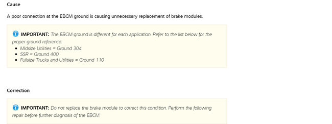

  • 2002 CHEVROLET 2500
  • 6.6L
  • V8
  • 4WD
  • 350,000 MILES

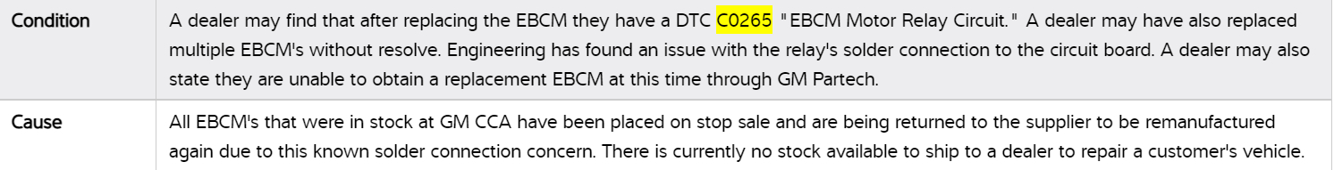

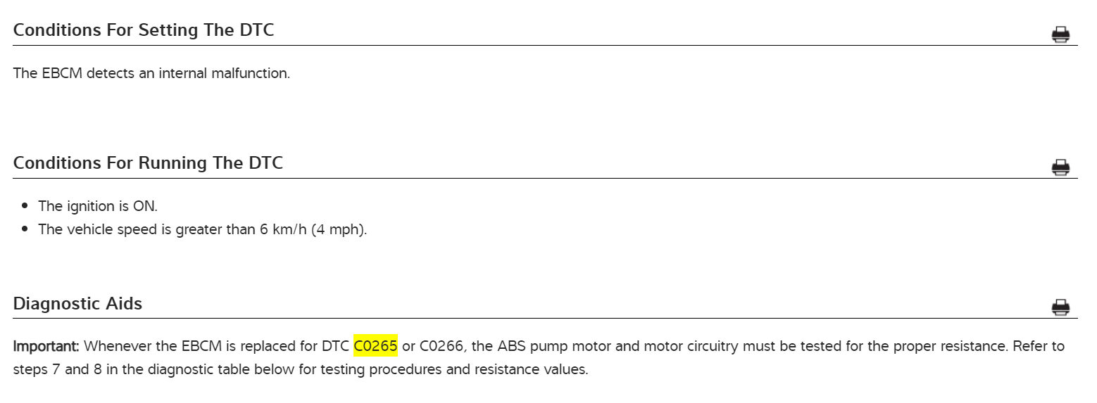

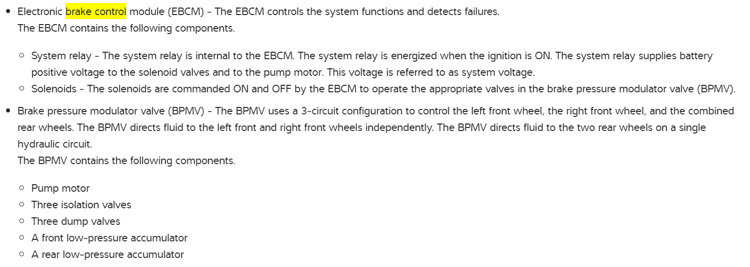

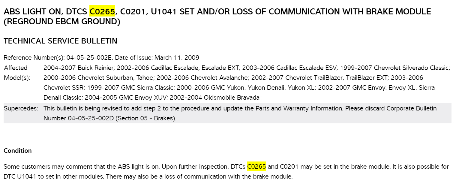

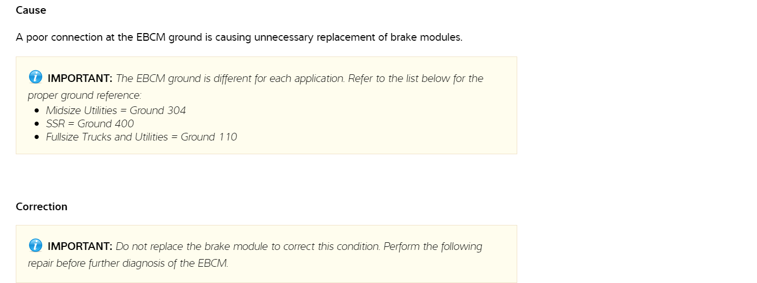

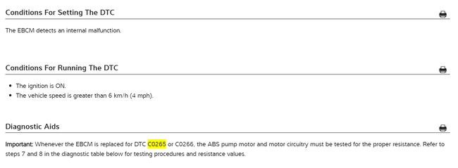

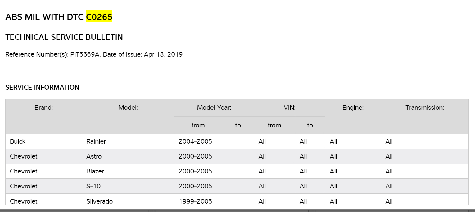

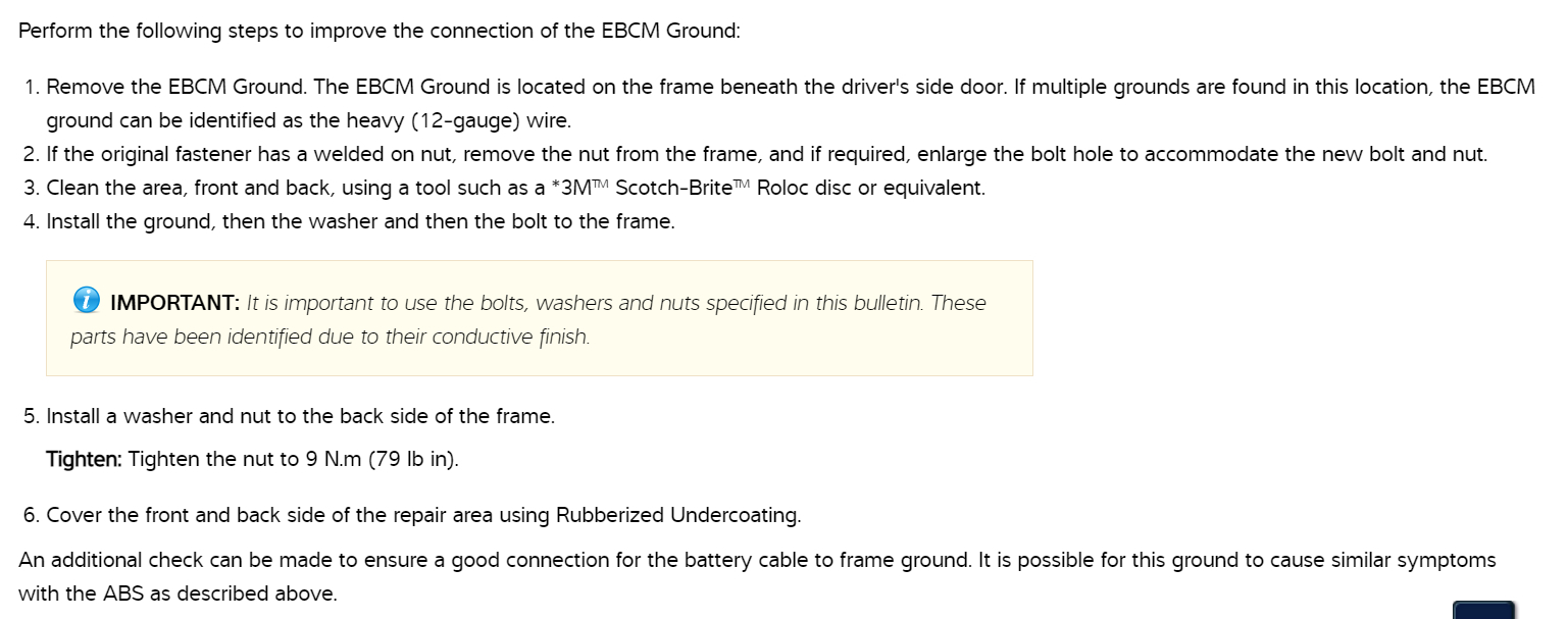

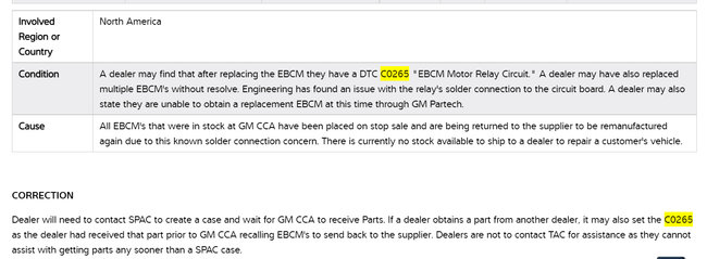

I have been having help from Steve and Danny. My ABS light stays on even though I had both sensors replaced. My mechanic diagnosed it and it read "error with Solenoid Control Monitor" but I can't find that part on the Internet. He is doing further research for me but sure wanted feed back from you great guys. I also wanted to tell you I lost sight of my odometer. It always was dim but not black. One day I did press on the reset button and it light up. I intend to pull the cluster gauge unit, remove the plastic on the back after unplugging it and look to see if it might be a burn out lamp. Is this a good idea?
