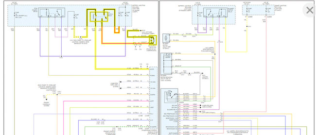

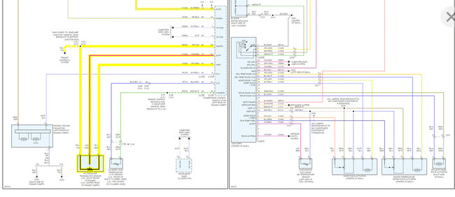

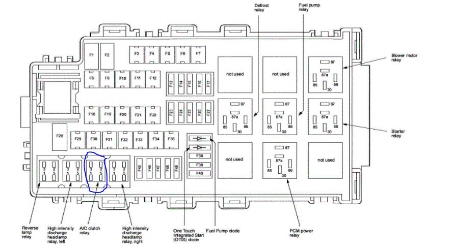

So I had my car parked for about a week, battery was bad so I replaced it, after replacing the battery my compressor doesn't seem to be receiving energy, got it to turn on by running it straight to my amplifier switch. so I know the the clutch or compressor are still good. I don't want to have to turn on my amplifier just to get the A/C going. I was wondering/hoping it could be a fuse or maybe something besides the evap sensor, if it is the evap would I be able to leave the clutch strait connected with my amp?
Sep 11, 2020 at 5:43 AM
  • CAR REPAIR CONTRIBUTOR
Good morning,
I attached a wiring diagram for you to view.
You need to verify power to the relay. I attached the location for you. If you have a volt meter we can do some checks.
