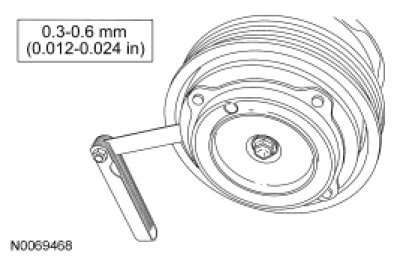

What I’m wondering is if maybe the air gap is to far off on the A/C clutch. Maybe one of the shims needs to be taken out?
Sunday, June 2nd, 2019 AT 11:32 AM
JIS001
  • 3,412 POSTS
That can also be an issue as well. Attached image below for the specs.
 12
2010 Ford Fusion FWD
Â
V6-3.0L
Â
Â
Adjustments
Vehicle Heating and Air Conditioning Compressor Clutch Adjustments
ADJUSTMENTS
Air Conditioning (A/C) Clutch Air Gap Adjustment
 1. Check the A/C clutch air gap at 3 equally spaced places between the clutch plate and the A/C clutch pulley.
Open In New TabZoom/Print
 2. If the A/C clutch air gap is out of range, remove the clutch plate. Add or remove spacers between the clutch plate hub and the compressor shaft until the clearance is within specification.
Sunday, June 2nd, 2019 AT 12:39 PM

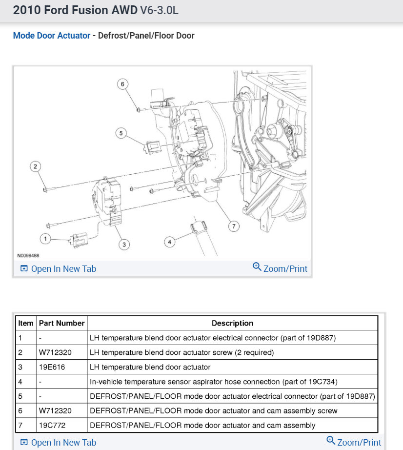

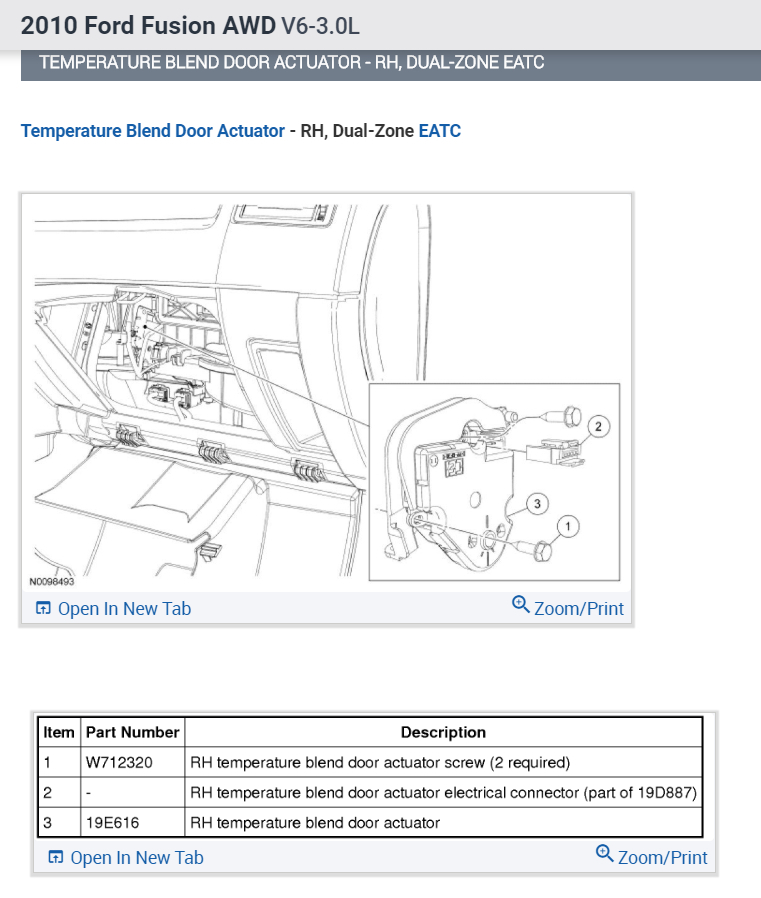

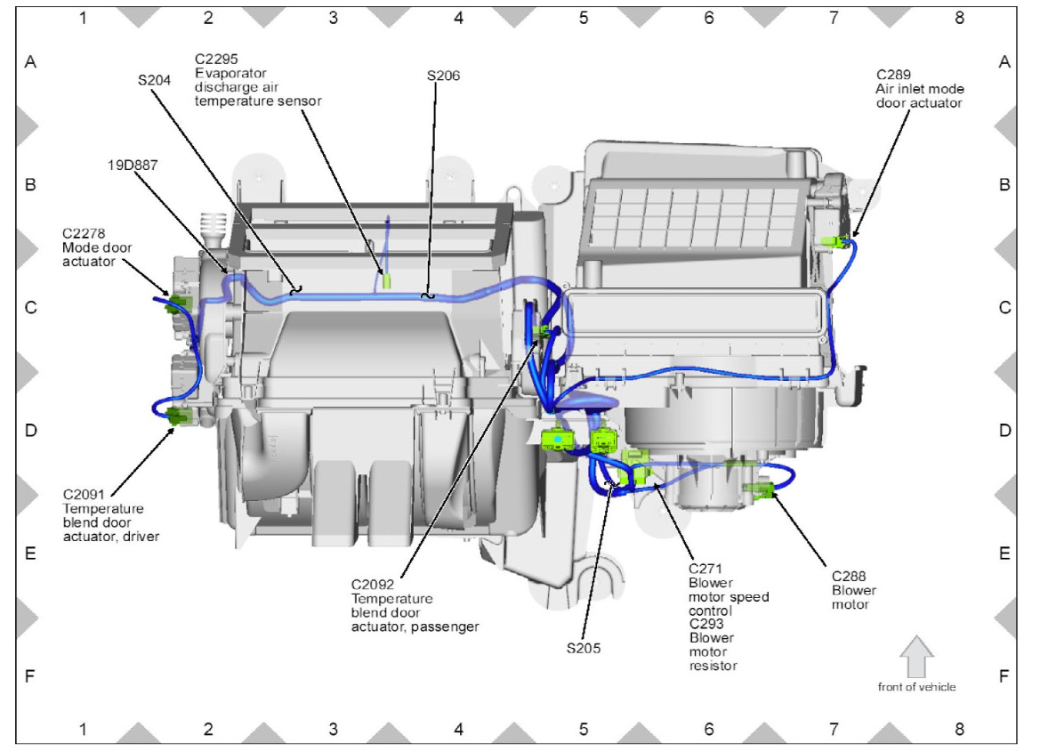

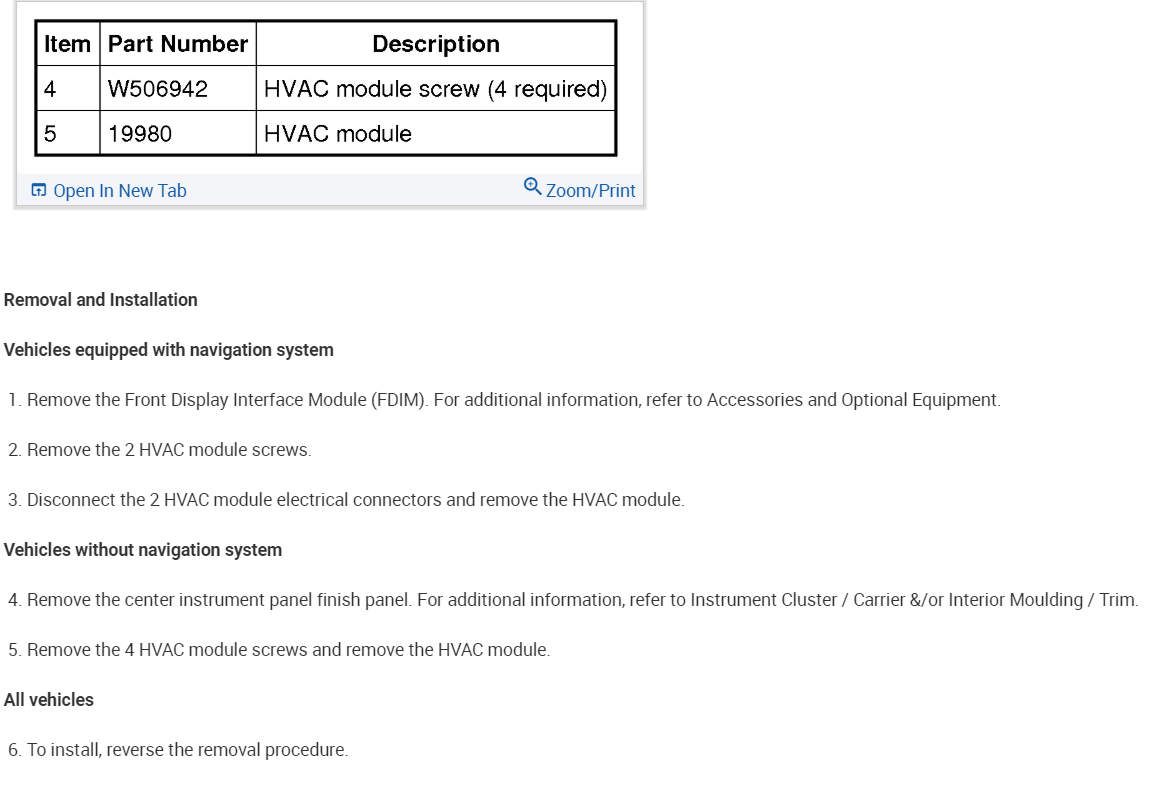

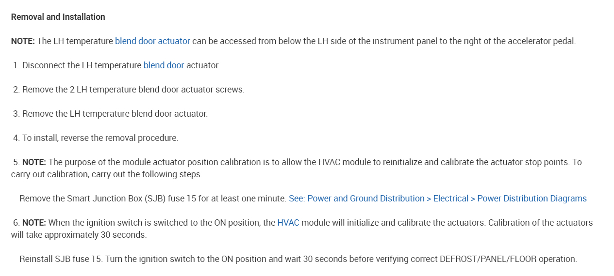

Did you have it fixed? What was the sensor and can you tell me how much is cost to have fixed?
Wednesday, June 5th, 2019 AT 4:41 PM
FRYER21
  • 10 POSTS
I did not have it fixed yet. But I believe the part is like under $30.00. I went to an auto part store and had it priced I am not sure on what the name of the part is but it sits inside the (HVAC?) And controls the temperatures. So it does not freeze up any parts.
Wednesday, June 5th, 2019 AT 8:20 PM
KEN L
  • MASTER CERTIFIED MECHANIC
  • 55,488 POSTS

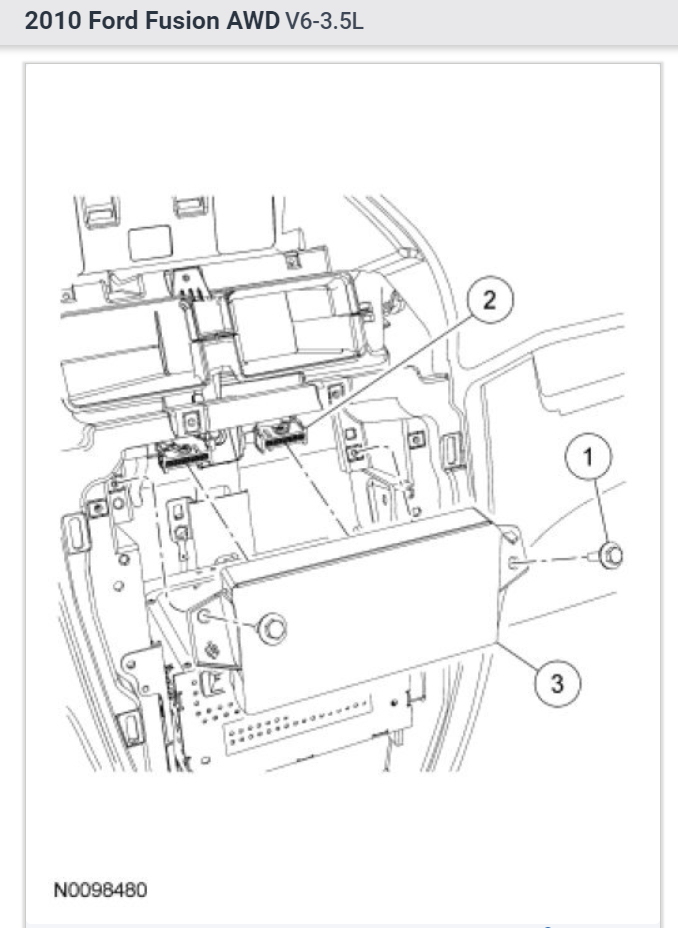

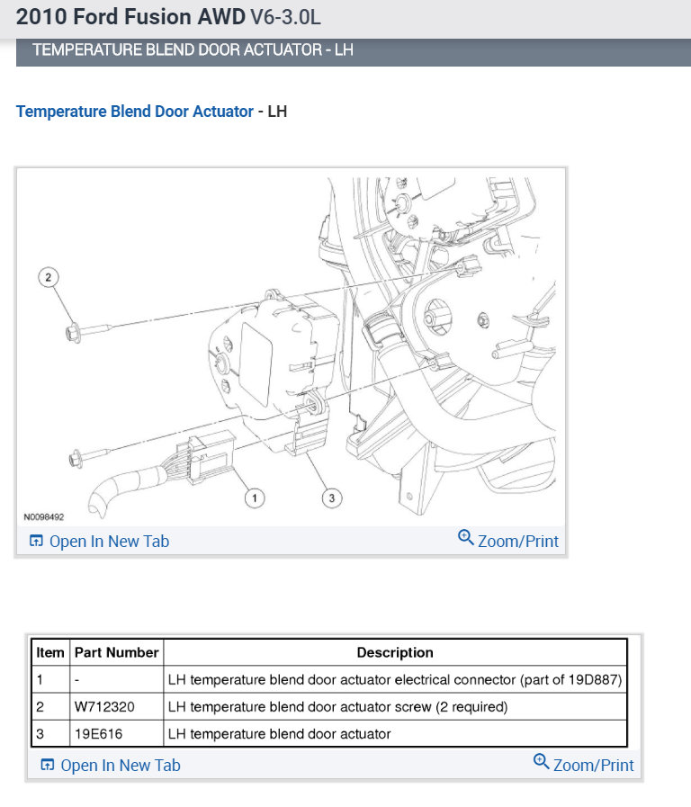

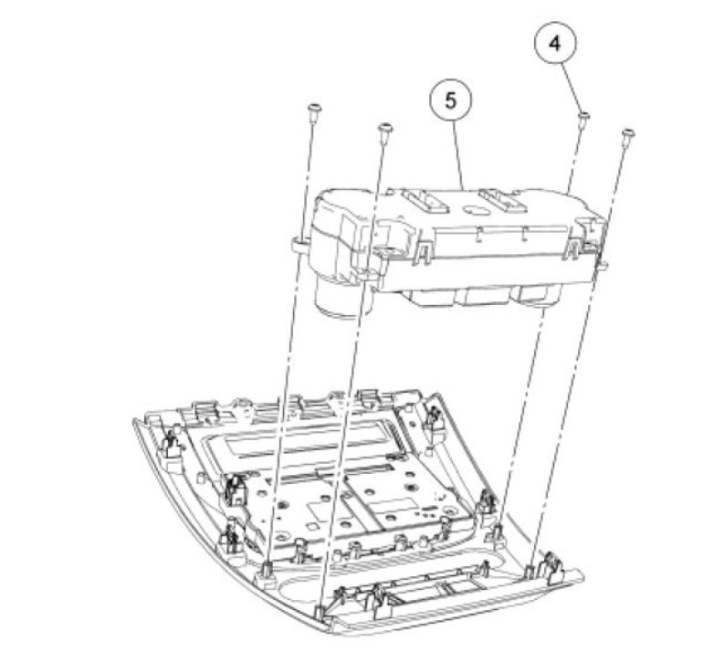

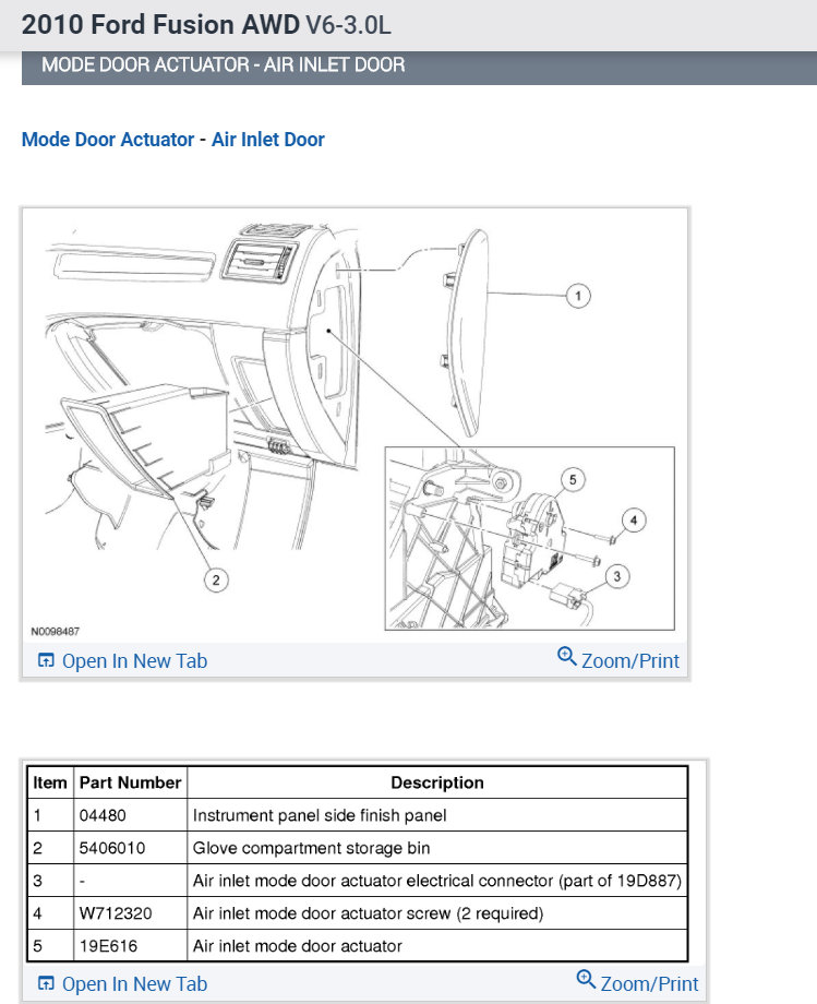

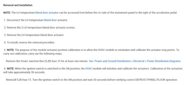

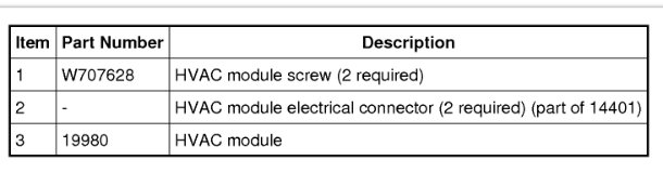

Was it a temperature or mode blend door actuator? If so here is how you change it out and the locations of each actuator. Check out the diagrams (below). Please let us know what happens.
+1
Thursday, June 6th, 2019 AT 2:01 PM
JIS001
  • 3,412 POSTS
It is the evaporator temperature sensor. They short out. The labor is expensive since the dashboard needs to be removed.
+2
Thursday, June 6th, 2019 AT 6:34 PM
FRYER21
  • 10 POSTS
Yes, that’s the part.
