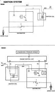

Check the ignition coil for twelve volts a the positive side of coil. Here is a diagram:

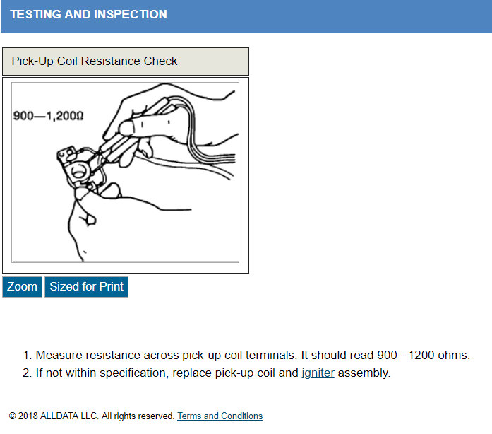

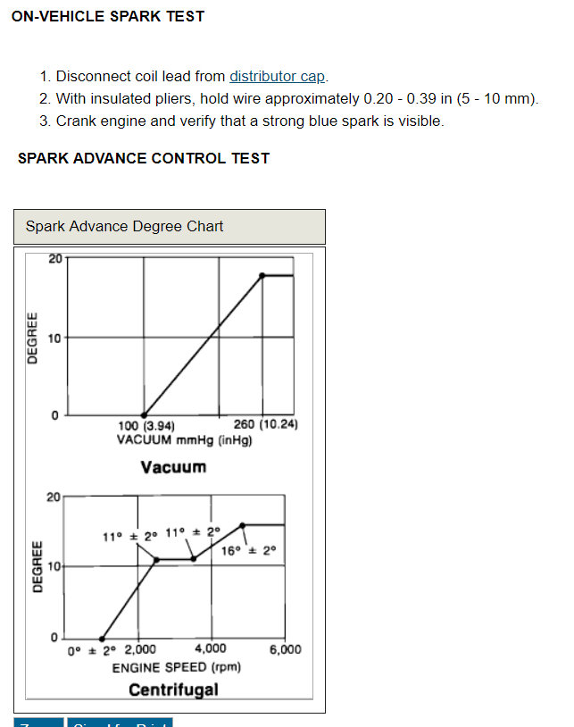

No snapping blue spark continue to troubleshoot the ignition system-power input to the coil/coil packs, coil's resistances, distributor pick-up coil, ignition control module, cam and crank sensors and computer.

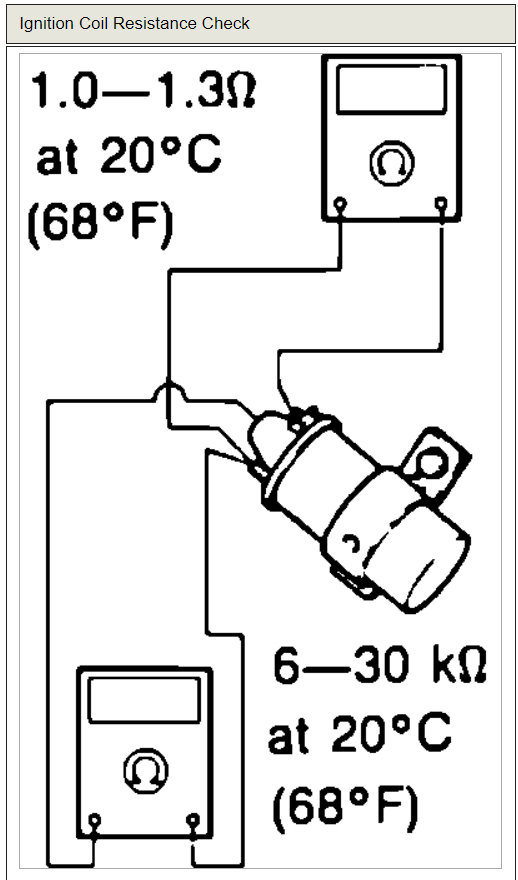

It is a good idea to do both since they work together one can make the other go out. Here are guides and instruction on how to test the system:
Check primary resistance across positive and negative coil terminals. At 68°F (20°C), it should be 1.0 - 1.3 ohms.
Check secondary resistance between primary positive terminal and ignition wire terminal. At 68°F (20°C), it should be 6 - 30K ohms.
Check insulation resistance between either primary terminal and coil case. It should be 10M ohms or higher.
Replace coil if it does not test as specified.

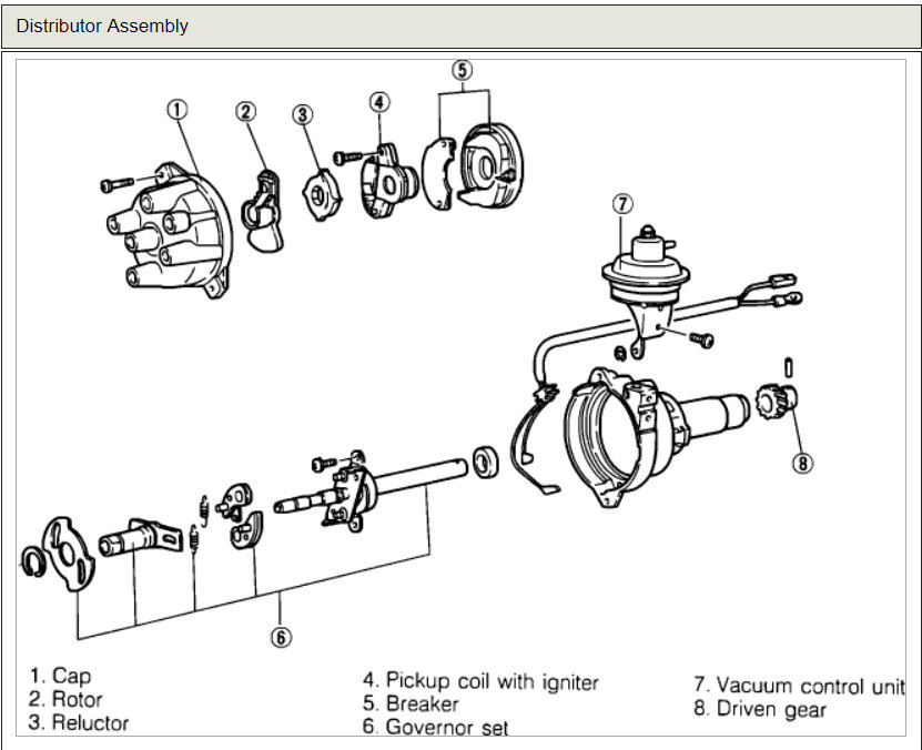

Ken, I have replaced the coil, distributor, cap and button, wires, and electronic ignition module. Still nothing. Any other suggestions for I just take it to the crushers? Thank you. (If I had a way to contact the initial poster on this thread, that is exactly what happened to my truck. As soon as I put it in reverse it quit. Do you have a way to contact him?). Thanks, Scott Smeeks

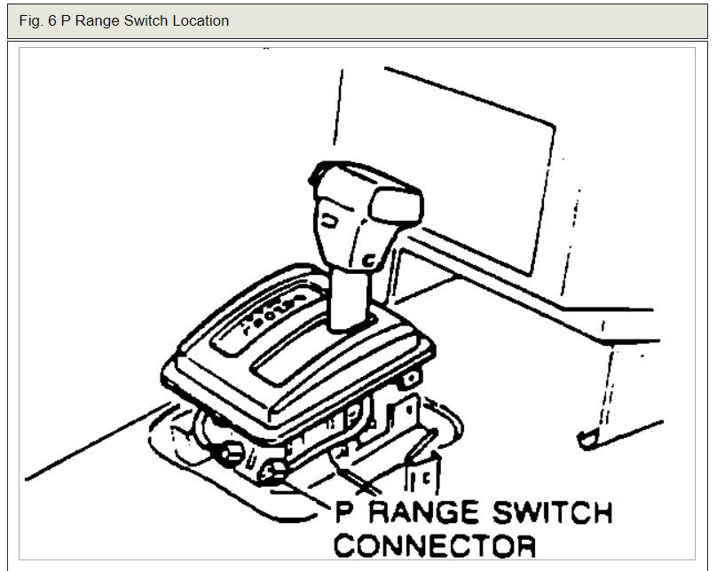

Can you do me a favor and remove the neutral safety switch connector once the engine is running and then put it into reverse? It sounds like transmission range sensor is shorted out.

Sorry Ken, I did not explain my response very well. After my truck quit running (put it in reverse and it quit about three weeks ago), it would not start again. I thought maybe the fuel pump, but it was getting fuel. Then I saw the above question from Todd Mc Dermaid and checked for a spark in the spark plug. No spark, so I replaced the distributor, cap, button, coil, and ignition module and still no spark. Fuses all seem okay, but do not know where to check next. I will try to look for the neutral safety switch. This is a 1991 Mazda B2600I Extended Cab 4x4. Thanks for your input, Scott

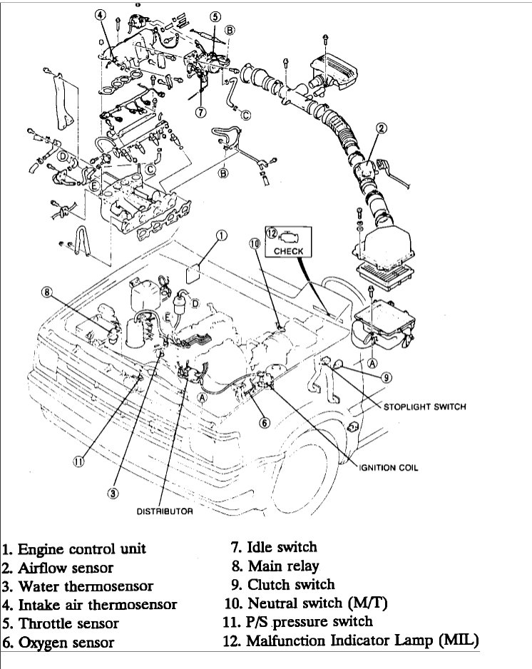

This sounds likes the main control relay is not working or the connections inside the relay are shorted.
Here is a guide and the location of the relay:
Check out the diagrams (below). Please let us know what you find.
