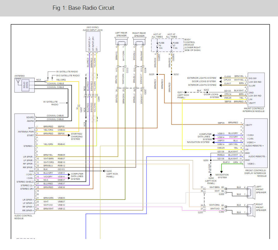

Thank you sir for your time. I do have an appointment set up for the 29th.

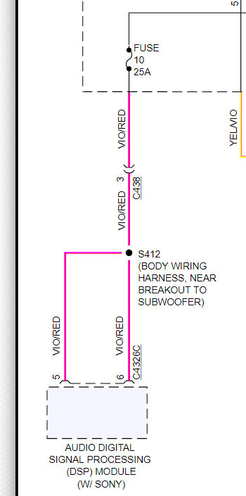

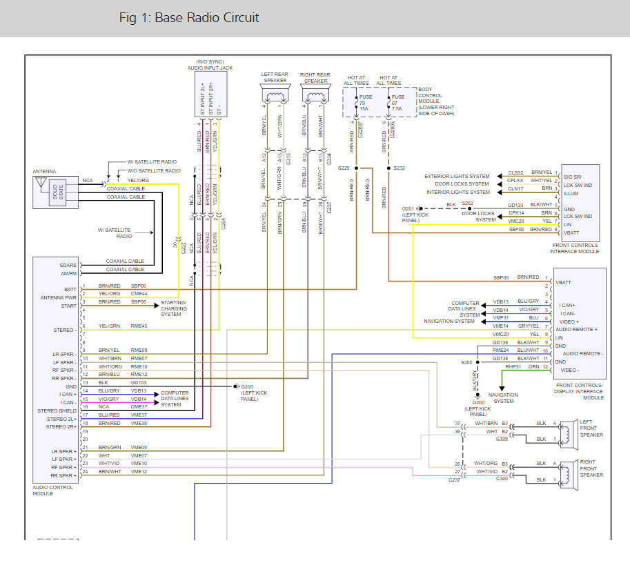

I would like to know if this is because of something I did (adding audio equipment/leds to vehicle, or is it a "ford" fault.
Sunday, August 10th, 2014 AT 8:44 PM
AISLEOFVIEW
  • 24 POSTS
It's gotta be that little green ground wire I mentioned earlier. When that green wire touches any part of the chassis, car is silent. Won't even crank.
Not a professional diagnosis of course, just a theory.

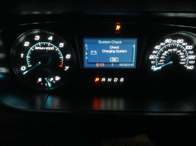

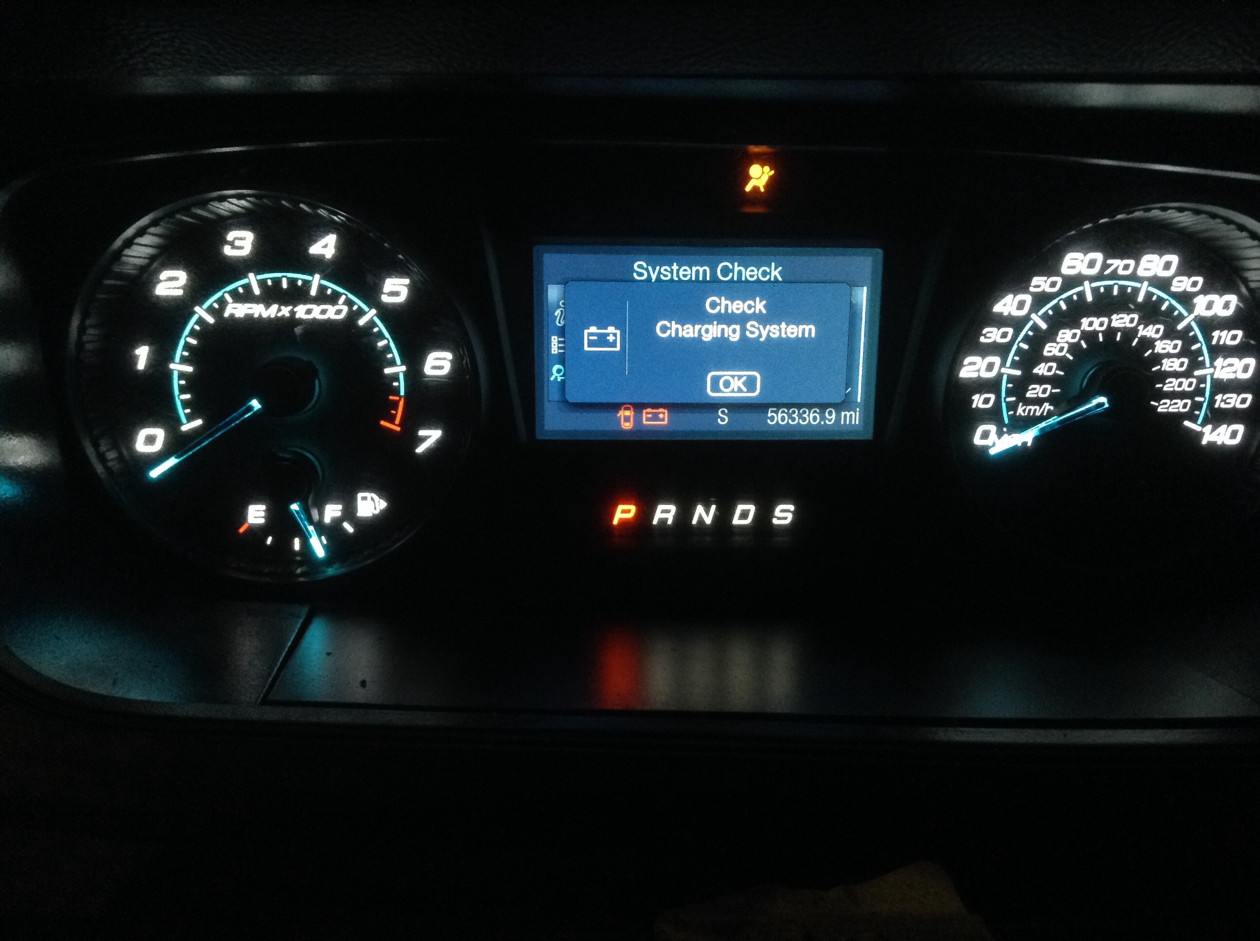

Hello and thank you again for your replies.
I just moved and am 100+ miles from the dealership I had it at. I do have an appointment with a local ford on Monday.
Update: car DOES start. "Check charging system" warning pops up.
Driving around or with it in idle, headlights, tail lights. License plate lights, all lights flicker.
Friday, October 17th, 2014 AT 11:50 AM
  • 110,192 POSTS
Either a ground problem or a bad voltage regulator will cause that. The car is too new to be having all these problems. If the new dealer you take it to can't help, you need to contact Ford Motor Co.
