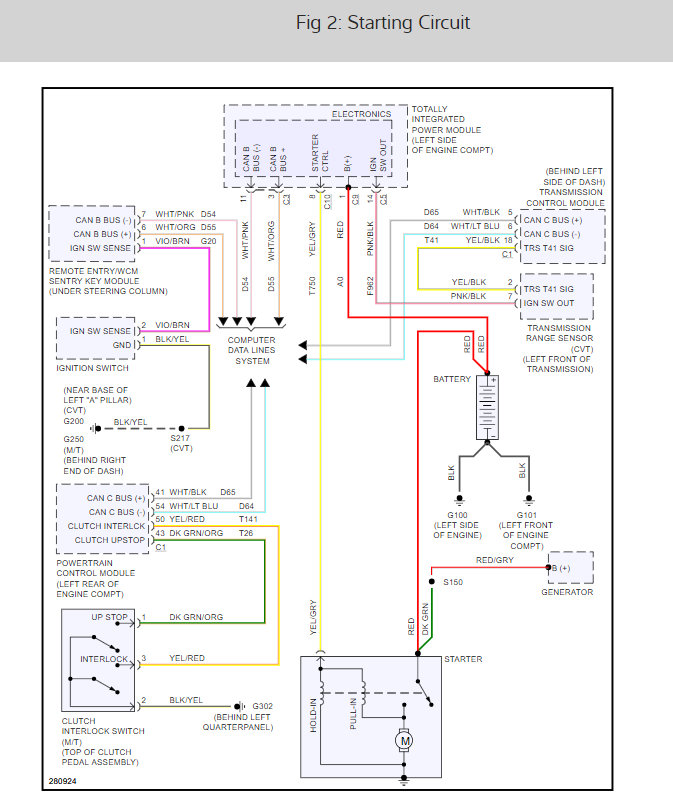

I have checked before. Wiring seems to be OK. I am not sure which of the 4 is the main relay though. It has 3 that are supposed to be radiator fan. There are 3 on one side and one alone in the corner on other side. I know the one alone in the corner is a fan relay. Hit it with the test light and the fan started up. They aren't the bigger square ones, they are the smaller rectangular relays.
Wednesday, December 30th, 2020 AT 5:48 PM (Merged)
SATURNTECH9
  • 30,869 POSTS
In the totally integrated power module number 18 40amp is ASD relay contact power feed. Number 23 is 15 amp engine ASD relay feed number 3. Number 26 is 15amp engine ASD relay feed. Number 32 is 30 amp engine ASD control feed 1.
+2
DRJ232002
I got a new TIPM for $233.00 and installed it everything is working as it should thanks for your help I love this site.

Can I ask if the security light is flashing? If so here is a guide to help fix it. Here is the starting wiring diagrams so you can see how the system works:
