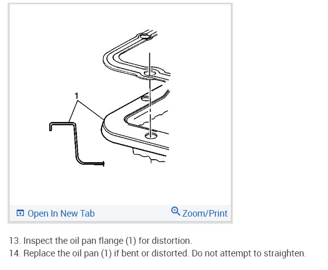

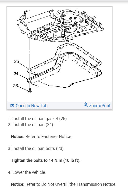

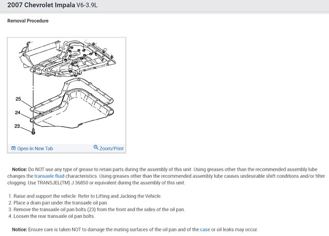

Hello, unsure if I should start a new thread or not if no one reply's in 48 hours I guess I will make a new one but everything seems to be good with the car now other than I noticed a transmission leak inspected it and seen that the pan gasket seems to have kinked, is there a specific sequence to put the pan on, and what I read that the transmission pan screws are at 10 ft/IB, 120 inch pound? Also any tips would be helpfully thanks. Also thank you KEN, and ASEMASTER6371 for the amazing help when I was doing this project you guys saved me around $2,500.00.

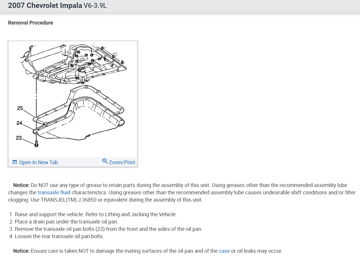

You are welcome for the help, that what we are here for. :) Here are instructions that should help you with the transmission pan leak:
Notice: Do not use any type of grease to retain parts during the assembly of this unit. Using greases other than the recommended assembly lube changes the transaxle fluid characteristics. Using greases other than the recommended assembly lube causes undesirable shift conditions and/or filter clogging. Use TRANSJEL(TM) J 36850 or equivalent during the assembly of this unit.
1. Raise and support the vehicle. Refer to Lifting and Jacking the Vehicle.
2. Place a drain pan under the transaxle oil pan.
3. Remove the transaxle oil pan bolts (23) from the front and the sides of the oil pan.
4. Loosen the rear transaxle oil pan bolts.
Notice: Ensure care is taken NOT to damage the mating surfaces of the oil pan and of the case or oil leaks may occur.
5. Use a rubber mallet to lightly tap the oil pan or use a screwdriver to pry the oil pan loose.
6. Allow the fluid to drain.
7. Remove the remaining transaxle bolts (23).
8. Remove the oil pan (24) from the automatic transmission.
9. Remove the oil pan gasket (25).
10. Inspect the oil pan and the filter for the following foreign material:
* Metal particles
* Clutch facing material
* Rubber particles
* Engine coolant
11. Determine the source of the contamination.
12. Correct the source of the contamination.

DAYTON YARNELL
  • 30 POSTS
What is photo number 2? Is that just the outside part of the pan? And thanks for the information.
Wednesday, March 17th, 2021 AT 3:59 PM (Merged)
KEN L
  • MASTER CERTIFIED MECHANIC
  • 55,440 POSTS
Sorry, #2? I don't see it?
DAYTON YARNELL
  • 30 POSTS
This is what you sent as photo number 2. What is that pan flange is that the outer part of the pan?
KEN L
  • 55,440 POSTS
They are just showing you a cross section of the pan metal shape is all, it is not a part.

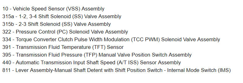

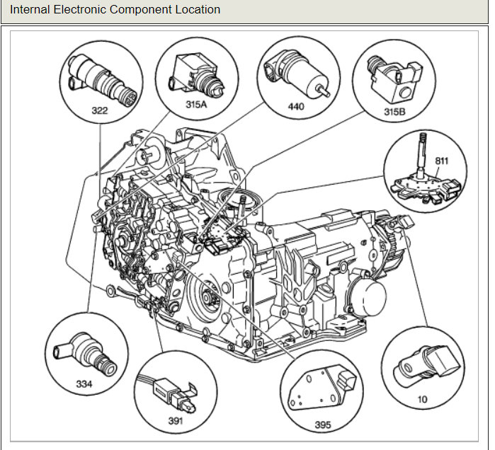

It sounds like one of two things has happened. First does the shift lights move when you are changing gears? If not then you need to replace the transmission range sensor which is located on the transmission near the shift cable hook up. Next is if the filter was not installed correctly with the right O ring or if they forgot the O ring the fluid will not be drawn into the transmission via the fluid pump.
Here is a guide to see what I am talking about for a correct transmission service.
Here is the transmission range sensor location. its #118
