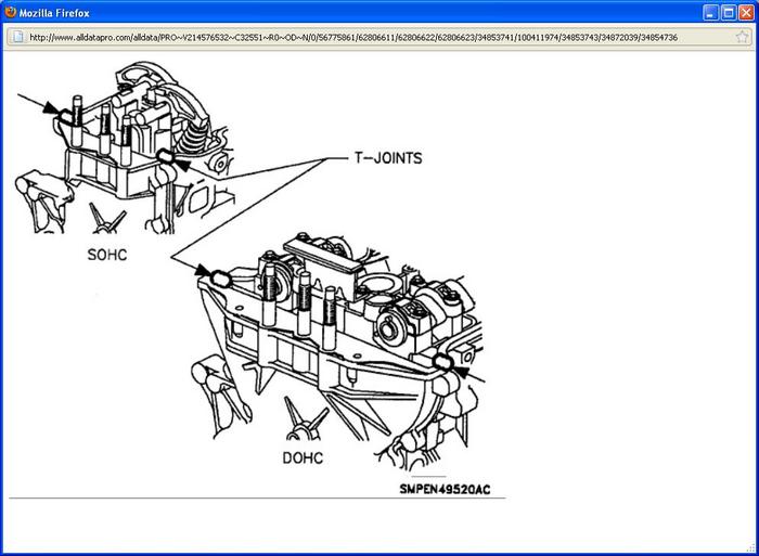

I posted a diagram of where the silicone bead goes under the cam cover gasket. The other silicone goes on the oil pan where it meets the front cover pretty simple.

To saturntech 9. Hey man. Got busy. I got it done and it runs and sounds great. Thanks a million. Without your help I would have been lost. I do have some oil leaking out of my new valve cover gasket. It is in right and I put the silicone where you told me. Am I going to have to take it back off and do it again? Should I RTV the whole gasket or does it take time to seal completely? Let me know what you think of this gasket deal. I will be doing the brakes in a few weeks so I will be asking for some more info on that if it is okay. Just wanted to let you know how it turned out. Thanks again. Joe.

It is just oozing a little from four or five sections. I was wondering if it takes some driving time for it to seal completely. It is a new gasket. I put it in the groove on the valve cover correctly. Wiped all contact points down with cleaner before I did it. Then there is 1 point that it is an actual leak. It is the back point on left side of motor where you told me to put the silicone. I put a decent amount down on that point. Should I just pull it off and do again. Can I reuse that $35 dollar gasket. What do you think? Thanks.

35 for a valve cover gasket?That's crazy I just got one for my 1999 SL2 a felpro it even came with the rubber grouments for all the hold down bolts for like 20 at auto zone. The only place you need to put silicone is where I told you on both sides of the front cover where the front cover meets the head under where the valve cover gasket touches. Just a nice bead on each side I posted a diagram showing you where the silicone goes. If you have leaks all around the gasket and it is tight then you have a warped valve cover.I have had cars where it was only leaking around the spark plug holes removed the cover replaced the gasket and then it was leaking around the outside of the cover. Found it to be a warped cover.I have a few like that. You can try putting silicone all the way around but I never had any luck doing that to get it to stop leaking.
