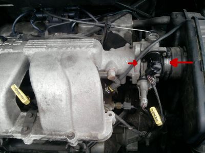

My father reminded me of something. He said the car dealer said he replaced something in the car because it didn't work normally. My father suspects this is the problem. I've uploaded a picture of the piece that has been replaced.
https://www.2carpros.com/forum/automotive_pictures/414396_motor_1_1.jpg
I really appreciate the help you are offering!

Hello, You are the fellow from Belgium? Man I watch how Belgium was so much in the middle of the great wars. All the area must be so beatiful to see in these times. Too bad there is not a highway across the ocean so we could all cross over. Looks like aidle speed motor called an AIS motor. Oh yes that will cause big problems if it doesnt operate properly on a high speed deceleration. No, I remember, you had a problem with stalling, or was it stuck in 2nd gear? Let me know I will check my posts a couple times a day. Busy season now.
You can use the key but not any audible for telling what is wrong in 1997. Iknow because in 1997 I worked for your manufacturer. They don't pay service mechanics to look for blinks and beeps to figure out what is wrong. Ok till 92, then it was a scan or experience to repair this simple problem. Tell me in exact words why you can not drive your van in a safe manner. In this country, a minivan that stalls is bad for you. That part can be removed, cleaned, then clean up the connections and bore of throttle body, reset the whole single system of fuel control. Please let me help you save some money and do it your self or have it fixed for your own good. I been ill and trying to fix electronic transaxles and fuel injection problems on your vans for well 84 was their first great year. Still doing it. Ok Mr. Jeroen. I am from the Austrian German area. I have 138 pieces of certifications for working with Chtusler products. I have every federal certification possible and required for any repair in my country for any car or light truck so I will not try to steer you wrong. Please forgive my lack of understanding this website. I am now understanding how easy it is to get all the info I need to help you.
Today I have time. And feel ok. Its slowing down. Maybe you will stop by, we will fix your van and drive around New Jersey. Lol. If you are stalling, the big three are responsible or another part. Your father had a idle control part replaced. If it is still stalling, like I say it could be repaired, but usually these services are performed when a part like in your picture is replaced. Cleaning the throttle blade and inner throat of the throttle body. That is the picture you have sent. The first step of the fuel system is your foot and the air. They are sensed and controlled. Ok so let me know if you need help. My name is Joe This website is the one of many that help. This is the best one I have seen. The people are into helping you. Your answers have been fine. You be exact. I or they will be exact. See you Mr. Jersoen. Still stalling? Problem? The scan tool is the best way. The key codes do work, for a tech, not a customer. Not in 1997 model year, not accurate enough.

the picture you had uploaded and pointing to an idle air
its the 1st to change when engine stall
I would suggest locking at the EGR system and check for vacuum leaks

But I noticed something that might add to this problem. If I start the car it runs smoothly, I shift it to D and still nothing happens. When I step a bit on the pedal so you can hear the motor better and than leave it just in neutral you can hear the car stutter at moments and eventually it stops running. It seems the car has difficulties to keep running in 1st gear and in idle. Maybe the part in the picture has something to do with it?
