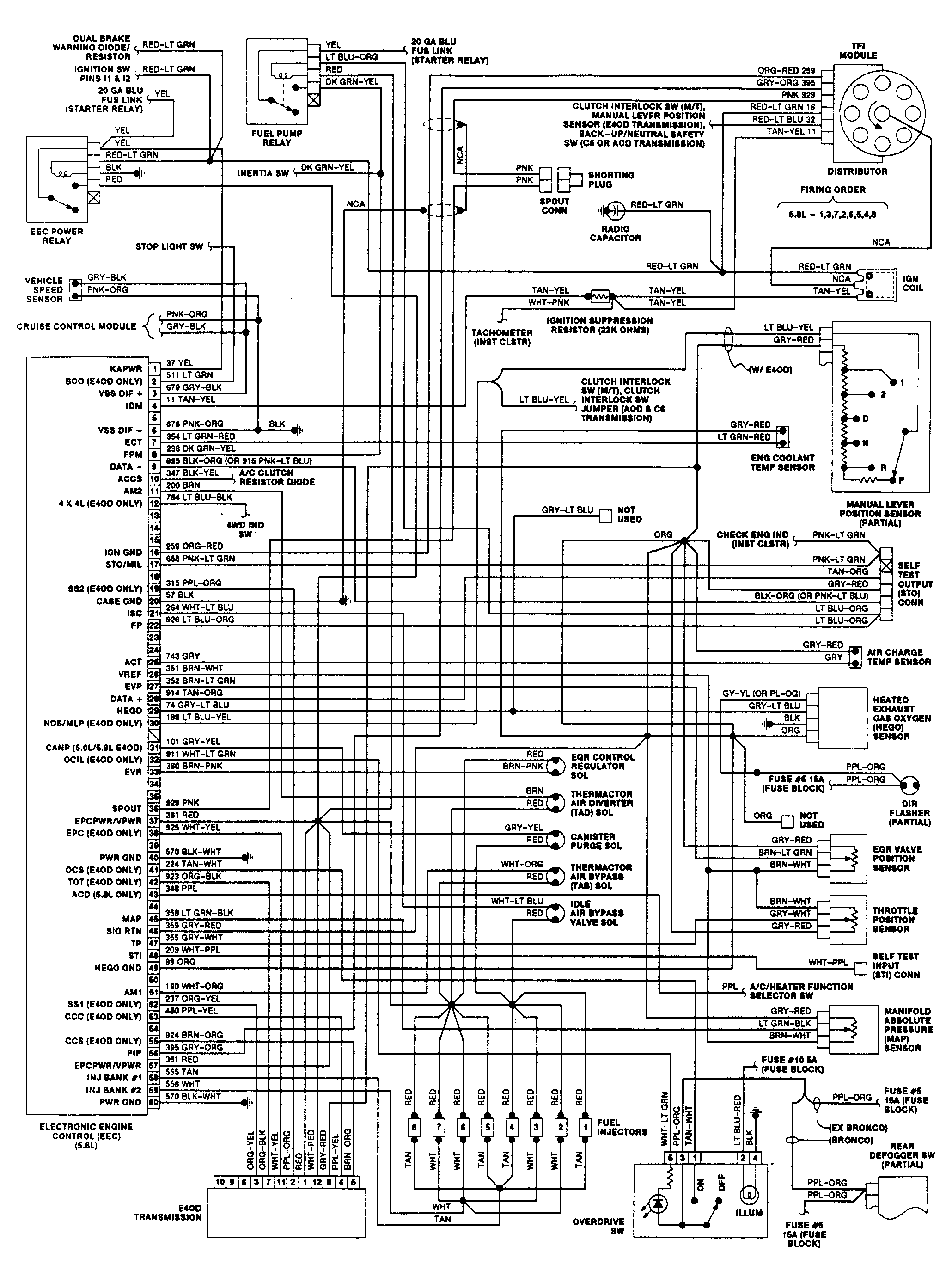

ALL I CAN COME UP WITH IS A RELAY IS HUNG UP
. OR THERE IS SOME SORT OF PRESSURE SWITCH THAT IS NOT WORKING
OR THE COMPUTER?
I GRABBED YOUR WIRING DIAGRAM FOR YOUR RIG---I LOOKED IT OVER
I NOTICED THEY DID NOT LABEL THE LOCATIONS OF THE COMPONENTS, AS THEY DO WITH OTHER DIAGRAMS
I SEE THE FUEL PUMP RELAY AT THE TOP---MAYBE IT'S CONTACTS ARE SEIZED TOGETHER, FROM SO MANY ACTUATIONS?
I DID NOT SEE ANYTHING ELSE LIKE A PRESSURE SWITCH THAT MIGHT SHUT OFF THE PUMP, ONCE A PRESSURE WAS REACHED (LIKE A FUEL RAIL PRESSURE SWITCH)
MAYBE I MISSED SOMETHING
I KNOW YOU PROBABLY CAN'T READ THIS DIAGRAM, WITH THIS MUCH CRAP IS ON IT. ONCE I POST IT
GO BACK TO MESSAGES---GIMME YOUR EMAIL AGAIN, I'LL SEND IT TO YOU SO IT CAN BE BLOWN UP AS ONE OF YOUR DOWNLOADS, SO IT WILL BE NICE AND BIG AND CRISP!
