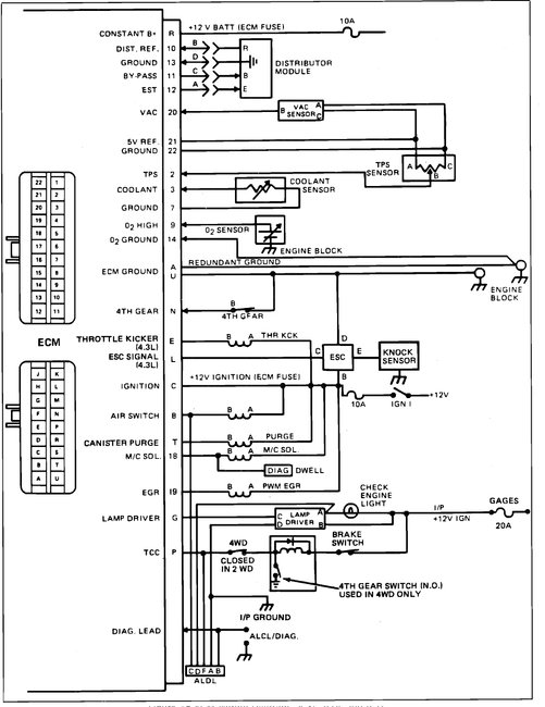

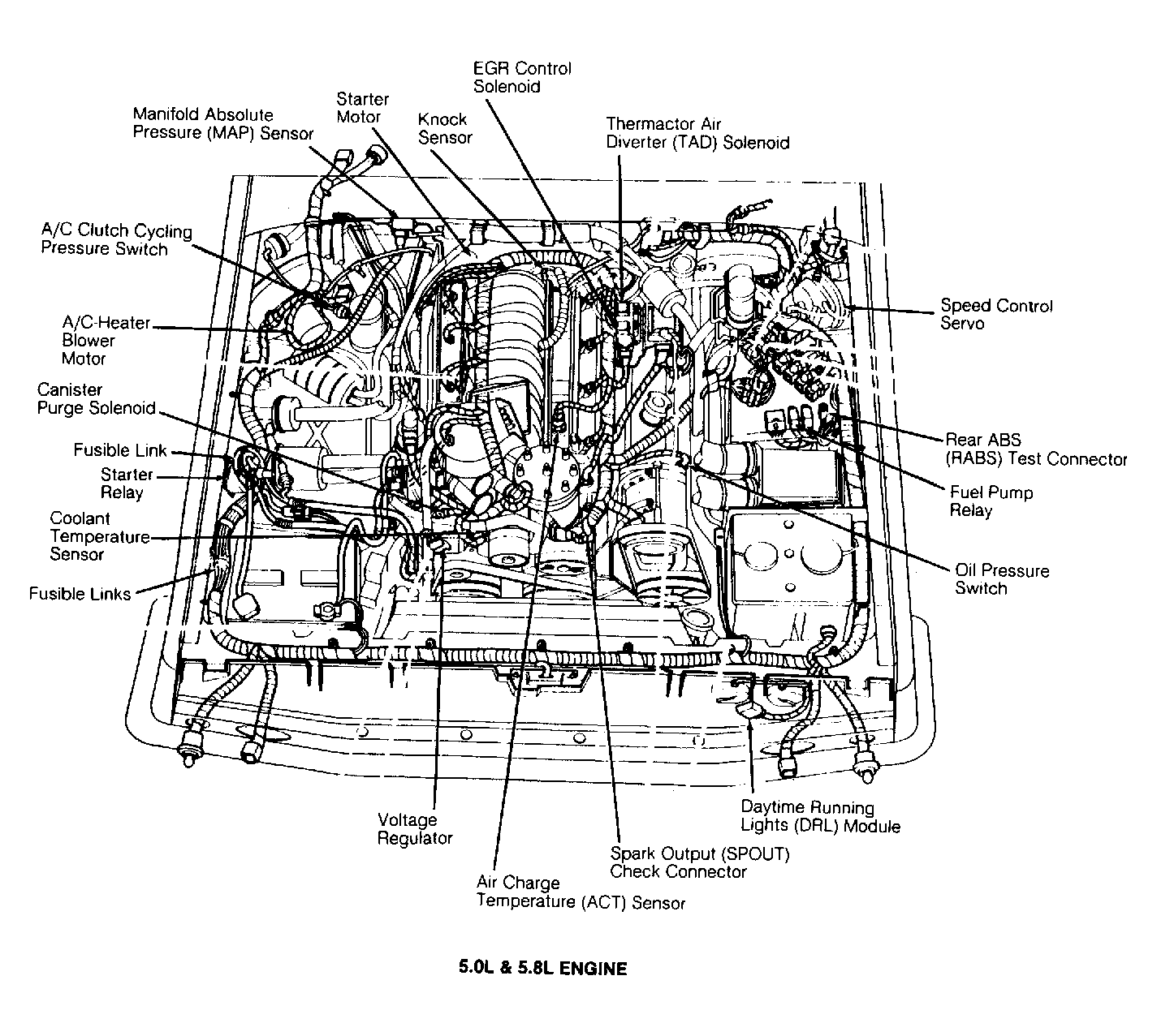

Ok I've had a few mechanic buddies come and work on it and there telling me its a fuel problem so now there thinking fuel pump. But when I turn the key to the on position it kicks on but wount stop priming is it the pump or something else? Any ideas would help greatly.
ALL I CAN COME UP WITH IS A RELAY IS HUNG UP
.....OR THERE IS SOME SORT OF PRESSURE SWITCH THAT IS NOT WORKING
OR THE COMPUTER????

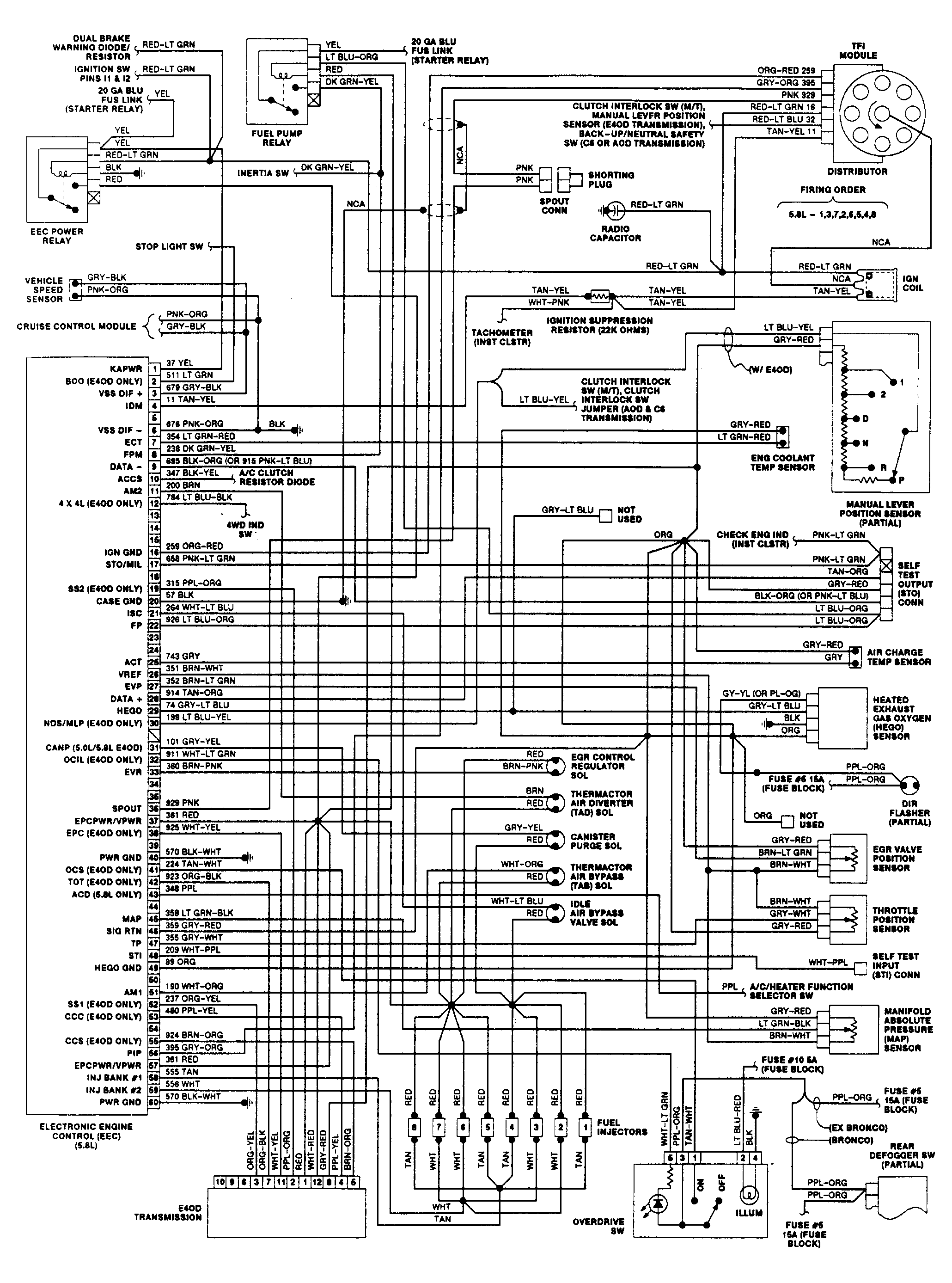

I GRABBED YOUR WIRING DIAGRAM FOR YOUR RIG---I LOOKED IT OVER
I NOTICED THEY DID NOT LABEL THE LOCATIONS OF THE COMPONENTS, AS THEY DO WITH OTHER DIAGRAMS
I SEE THE FUEL PUMP RELAY AT THE TOP---MAYBE IT'S CONTACTS ARE SEIZED TOGETHER, FROM SO MANY ACTUATIONS ???
I DID NOT SEE ANYTHING ELSE LIKE A PRESSURE SWITCH THAT MIGHT SHUT OFF THE PUMP, ONCE A PRESSURE WAS REACHED (LIKE A FUEL RAIL PRESSURE SWITCH)
MAYBE I MISSED SOMETHING
I KNOW YOU PROBABLY CAN'T READ THIS DIAGRAM, WITH THIS MUCH CRAP IS ON IT...ONCE I POST IT
GO BACK TO MESSAGES---GIMME YOUR EMAIL AGAIN, I'LL SEND IT TO YOU SO IT CAN BE BLOWN UP AS ONE OF YOUR DOWNLOADS, SO IT WILL BE NICE AND BIG AND CRISP!

Ok could my fuel pump running constantly when the key is on be a bad fp relay? Or a bad fuel pump

RECKON THIS IS IT?
http://shop.advanceautoparts.com/webapp/wcs/stores/servlet/product_Relay-BWD_5972302-P_1225_R%7CGRPFUELAMS_____
MIGHT BE WORTH THE "THROWING OF PARTS AT IT"---IF IT AIN'T THE PROBLEM, YOU'LL HAVE A SPARE!.....I'D TAKE A CHANCE WITH $14.50

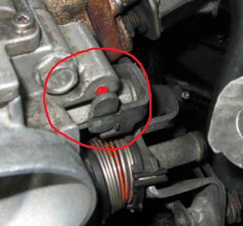

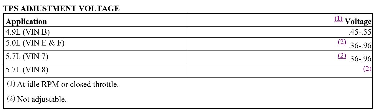

Ok I priced one at napa for 10 I think I'm gonna give it a try and if that's not it I'm not sure where to go but I did put a new throttle position sensor on it and it fired off and idled for a few seconds and then died so I think I'm on the right track. What do u think?
