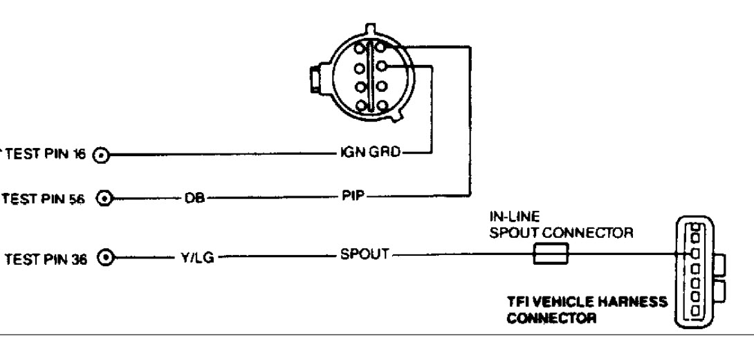

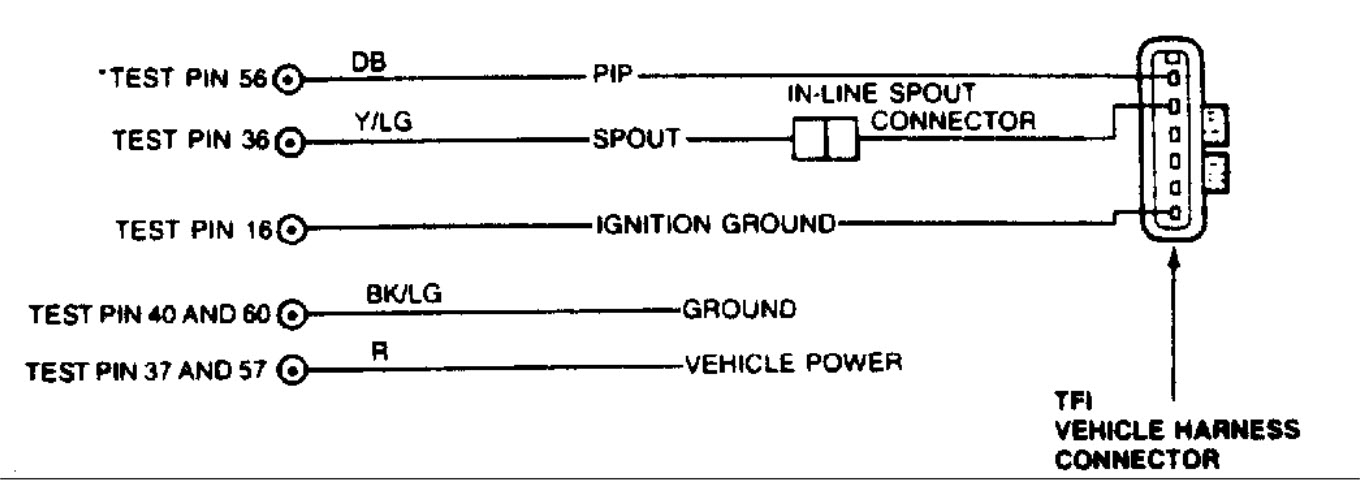

90' Mustang GT. Car will not start. Turn key on @ nothing works. No noise of fuel pump turning on, no power to starter solonide, Changed TFM on distributor. Nothing seems to make the car come alive. Wasn't able to locate a ignition ground switch.
Any suggestions?
Thursday, November 29th, 2018 AT 1:12 PM (Merged)
CARADIODOC
  • 34,468 POSTS
So you're saying everything is dead, just the same as if there was no battery in the car? If that's correct, start by checking the two large copper nuts on the starter relay / solenoid on the inner fender. Ford likes to use one of them as a common tie point for all of the other electrical circuits.
If those nuts are tight, use a test light or digital voltmeter to follow the battery cables to see where voltage is lost. That will be the point to look for a bad connection.

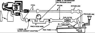

My car will start if you put ether in the starter body. I put a new fuel pump on it, checked all the fuses, new distributor, fuel pressure regulator, checked inertia switch in the trunk. Fuel injectors are fine. I went through your entire checklist for crank but no start all the way down to "obscure starting issues" and I have none of those problems. I have spent a lot of money on the car already and still it will not crank. Any idea of what the problem could be? I have not been through any water puddles or hit any potholes. I was driving the car one day and it was running fine. I parked it, and then next weekend it just would not start.
-1

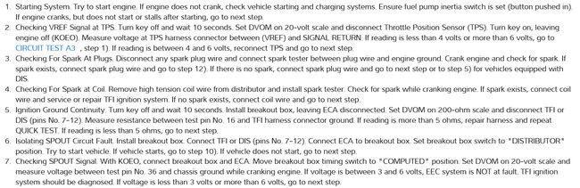

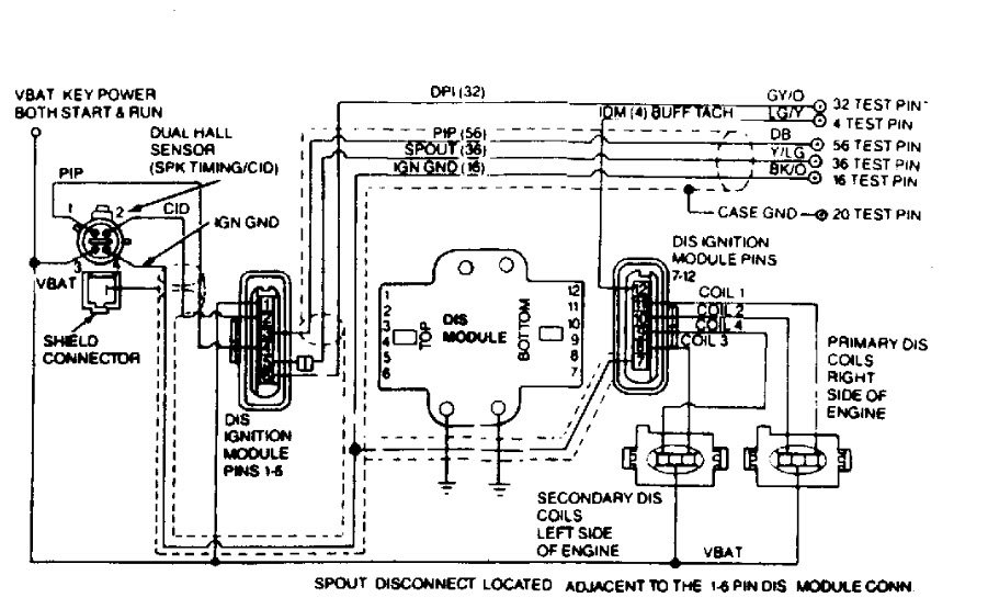

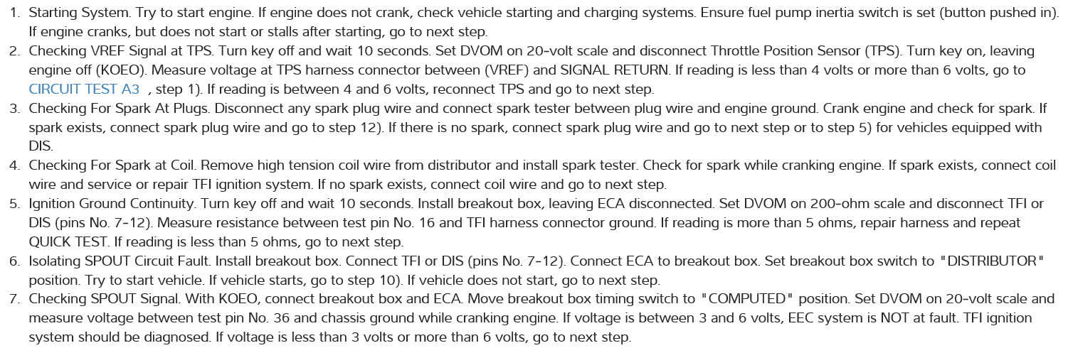

HMAC300
  • 48,601 POSTS
Check the brown fusible link on starter relay by battery it should have twelve volts on both sides that powers the fuel pump relay and may be your problem. I am assuming you cannot hear the pump kick on when key is turned on. If that is burnt up no fuel it will attach to an orange/light blue wire.
LACEYMC
I checked that fusible link - not the problem. Also, I have 45 psi fuel pressure.

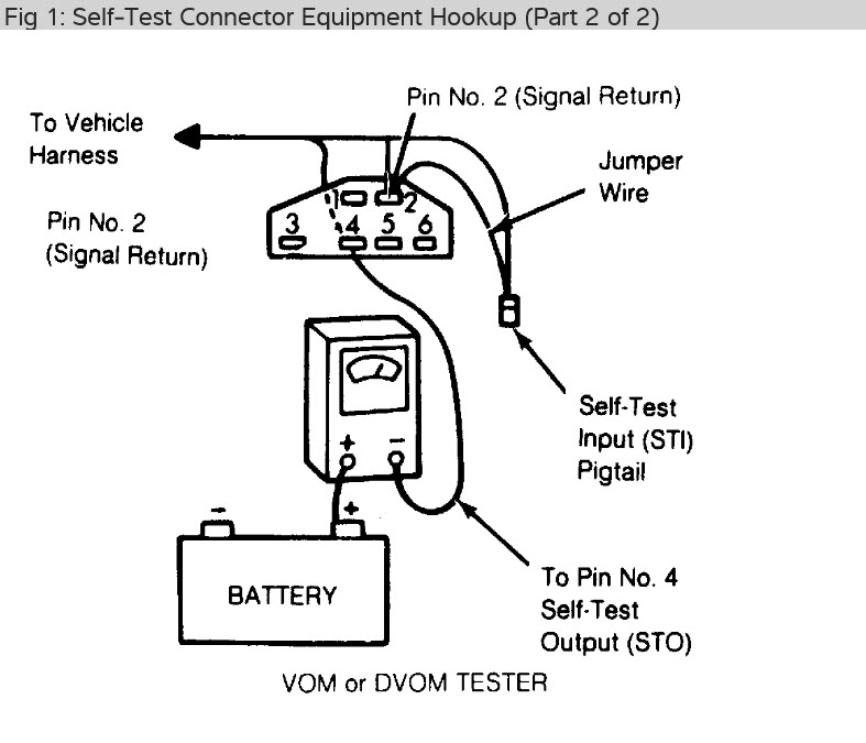

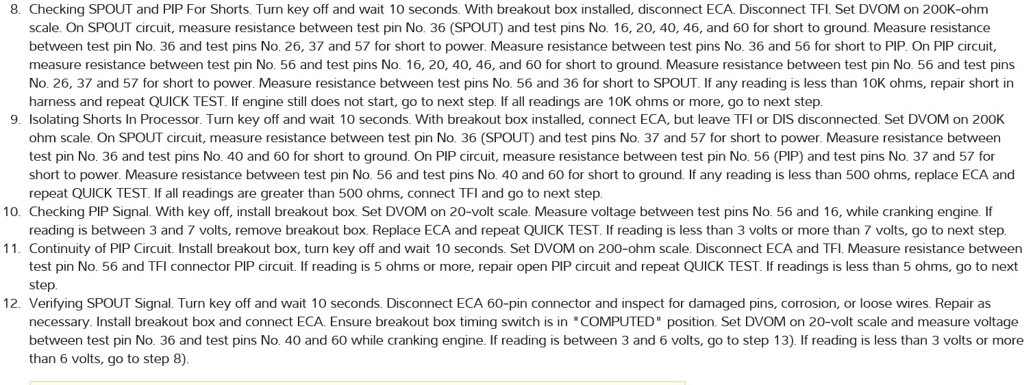

HMAC300
  • 48,601 POSTS

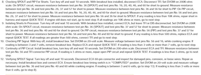

Then if you are spraying either in it and it is starting there is an ignition problem not letting fuel injection work. Scan for codes and follow pictures for instructions test ignition system only as you already have fuel pressure.

HMAC300
  • 48,601 POSTS
Have you done any of the tests I sent? What I sent is to diagnose your problem. Please follow those to see why your car isn't starting
