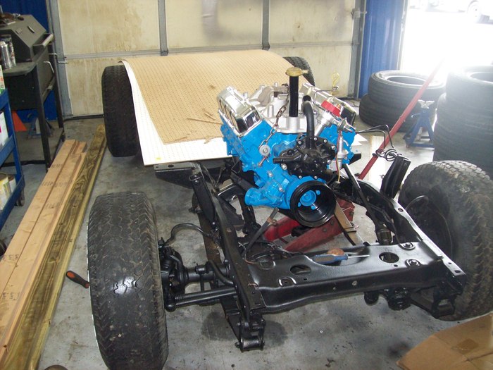

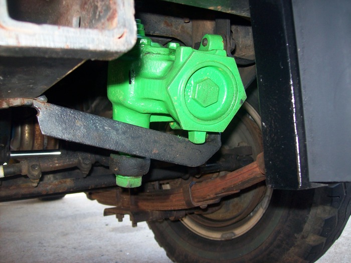

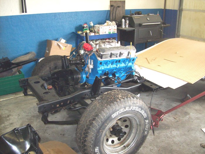

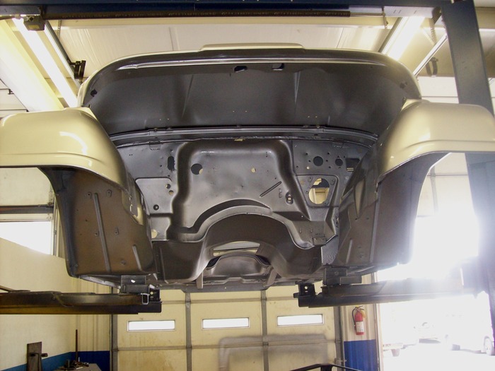

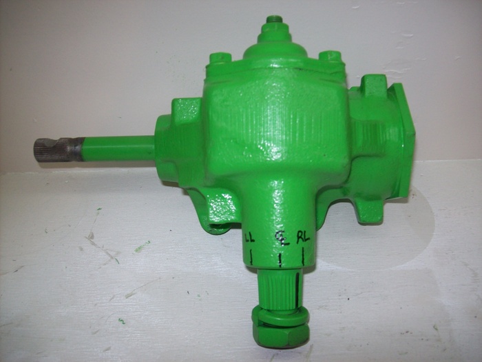

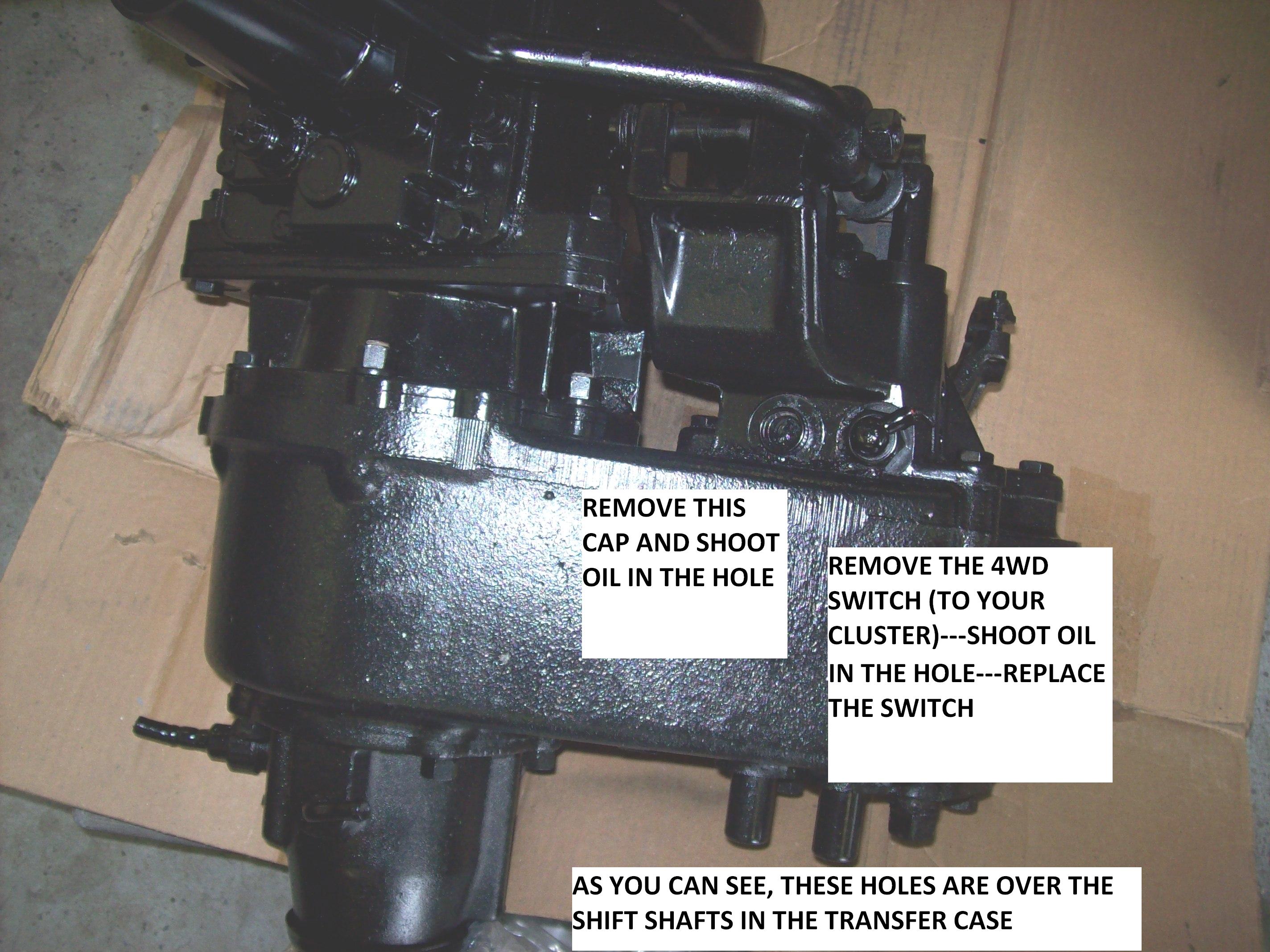

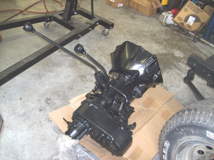

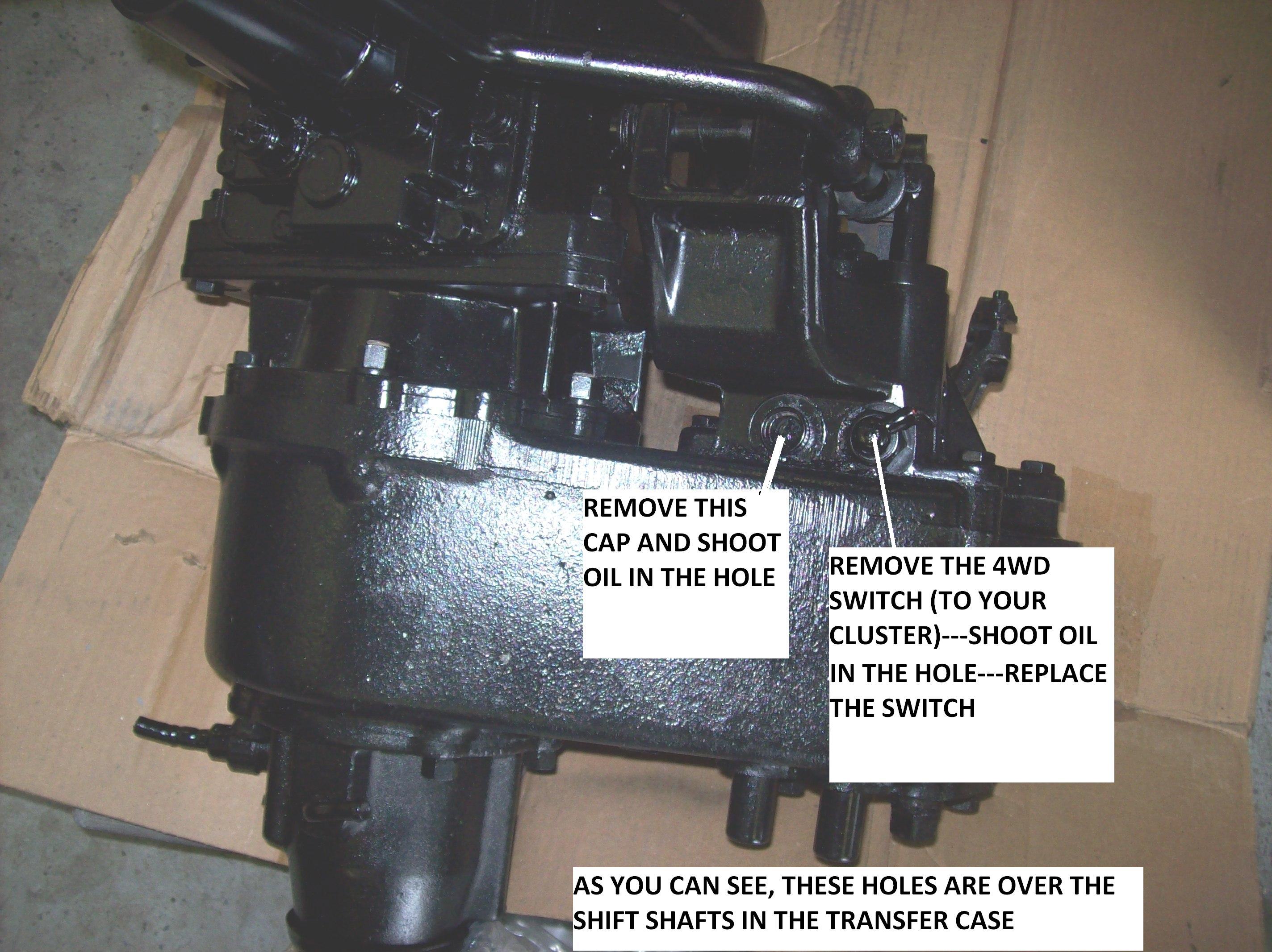

OK--GOT SOME PICS OF A DANA 300----HARD TO SHIFT?
THIS IS A FULL RESTORATION I HAVE RUN ACROSS RECENTLY

OK, FORGOT MY ARROWS IN THE LAST PIC!

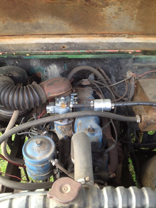

Well medic, long time no talk. Ive been pretty busy with working and I was on vacation for a week there too. But I finally solved the issue. It had nothing to do with the carb. I was talking to my dad about it and he suggested the fuel pump. I didnt see how that would do it, because ive only heard of them being a yea or no thing. Not only work halfway. But I trust him, and gave it a shot. Put the new one on and it purred like a kitten. The carb is a little off now from trying to mess with it before, but now it will idle so I can accurately tune it.
It is slightly out of action right now. I remembered about my steering box leak so I had to turn it off, the pump was completely dry. Im halfway into removing the steering box to replace the input shaft seal. Than I can tune the carb and time it and it should go where I want it to under its own power. Its so close I can taste it.

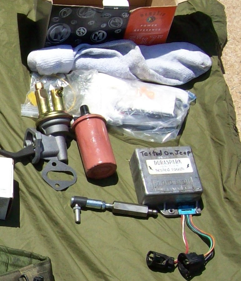

SORRY IT DIDN'T EVEN CROSS MY MIND---I DO KEEP A SPARE FUEL PUMP WITH ME, ALONG WITH A COIL, IGNITION MODULE, AND THE LAST LINK OF MY CLUTCH'S BELL CRANK SYSTEM (SEE PIC)
REMEMBER, I RE-VAMPED THE REST OF IT USING SEALED BEARINGS AND SPHERICAL PLANE BEARINGS, THE ROD TO THE CLUTCH ARM IS MY WEAKEST LINK---MY MODIFICATION W/ THE BEARINGS SHOULD LAST 100 YEARS!
INSURE YOU RESEARCH YOUR STEERING AT THE K.B.---MY GEAR IS MANUAL, I REPLACED IT IN JANUARY 2010 W/ A NEW OEM SAGINAW THAT I FOUND ON THE NET (I HAD PUT ON AN OMIX-ADA CHEAPO BEFORE, IT DID NOT LAST VERY LONG

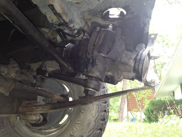

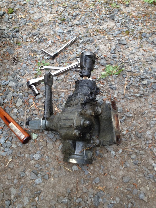

Well I dove into the steering box leak and got that all taken care of this weekend. I started it during the week, I would mess with it a bit each night after work since the sun is now still out when I get off for a bit. It had me confused at first, and intimidaded with making sure I put it back on right. Turned out to not be a problem at all. I snapped a few pictures along the way. Not as many as usual, this thing was super greasy from leaking so bad.

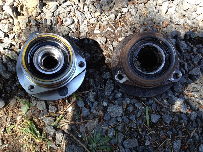

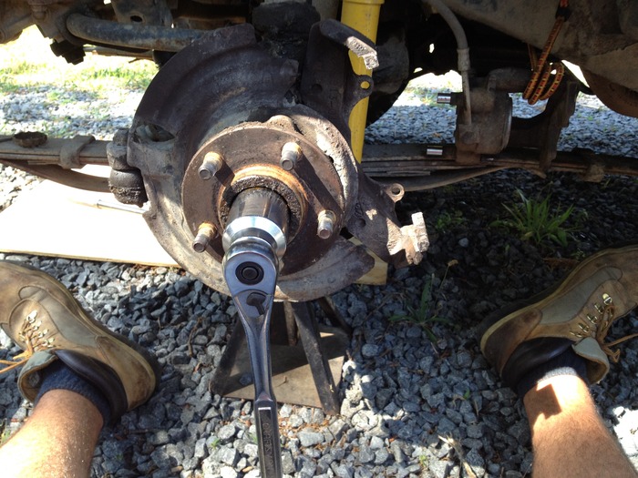

Also finally got around to changing the front hub assembly in my YJ. That was simple and done in an hour.

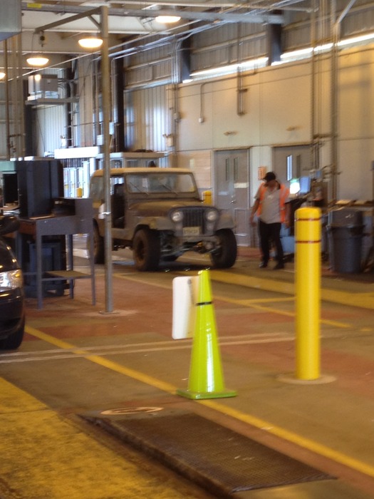

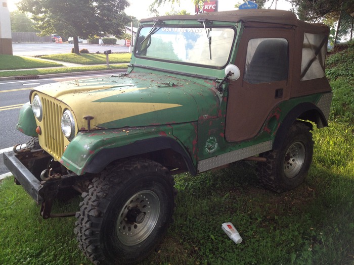

The last few pictures are from the 4wheeling trip in may, my baby being raped by the state inspection, and also this awesome looking cj5 I found one day. For your viewing pleasure.

LIKE THEM SOCKS!
. AND THAT CORAL SNAKE COILED UP AND HOLDING YOUR CALIPER UP

YOU SORTA LEFT THE TIP END OF YOUR STEERING BAR HOOKED TO YOUR GEAR.I KNOW IT WAS A PAIN GETTING THE "SQUARES" AND THEIR "WAVY WASHERS" BACK IN. NOT TO MENTION GETTING THE BOOT AND WIRE RETAINER BACK IN. I HOPE YOU FIGURED OUT PUTTING IT BACK ON THE STEERING ROD 1ST. THEN INSTALLING THE GEAR WAS THE EZist THING TO DO

Yeah the other pictures dont want to load. Maybe if I can get my email to work, ill send them that way. I actually didnt have that hard of a time getting the collar back on the steering rod. I re-installed it the way you see it. I hammered the collar all the way down the input shaft, tightened the bolt that clamps that tight. Than just slid it back over the "squares." Even the boot an wire retainer wasnt too hard. It all fell into place, like it wanted to get back on there and be ran.

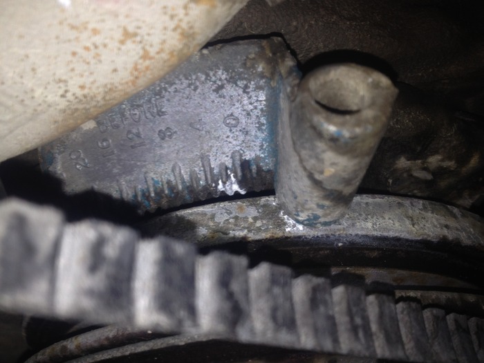

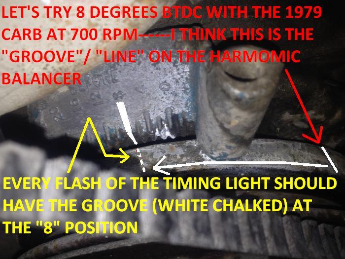

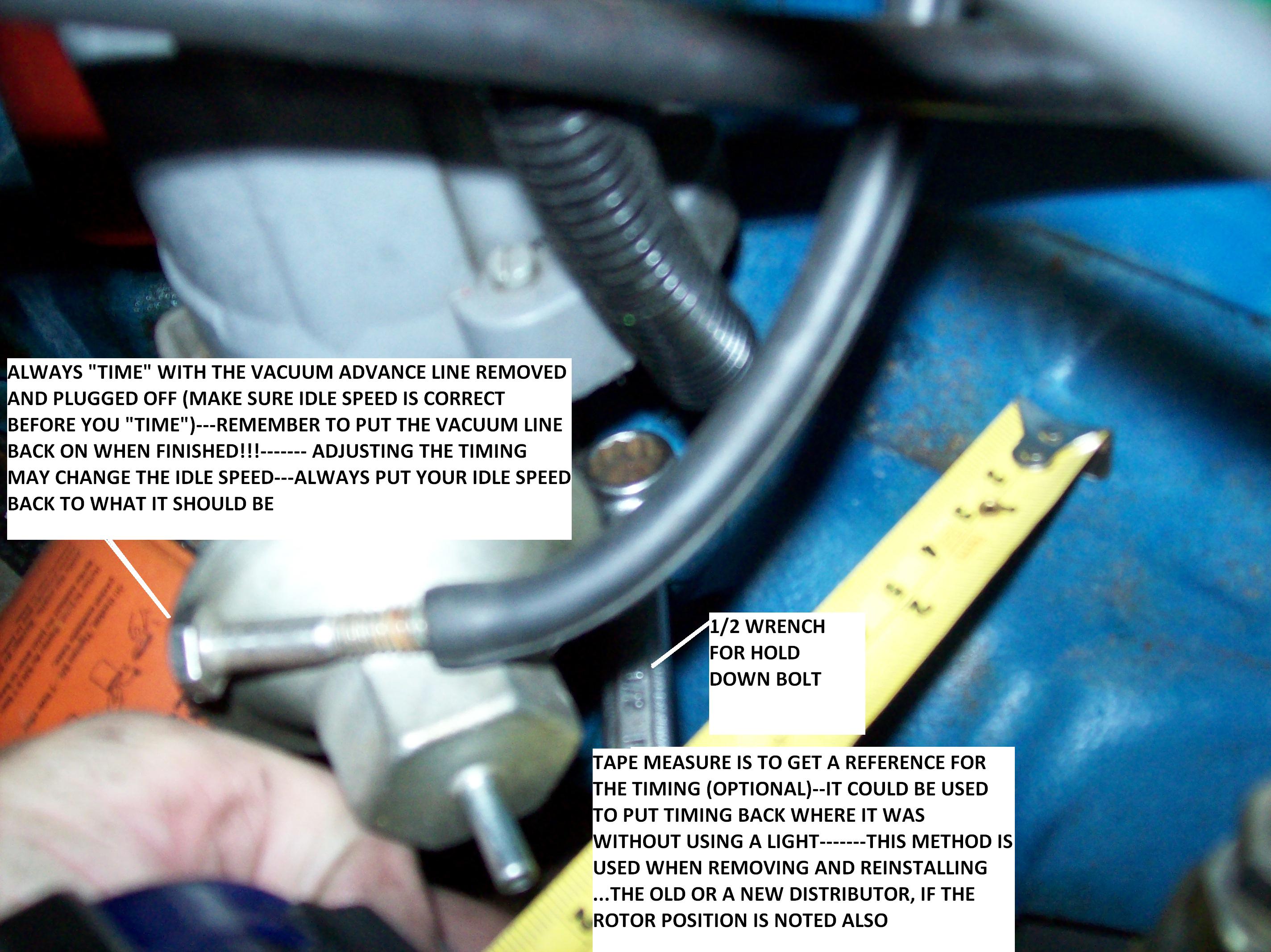

Well, I went to take her out the other night and it would NOT keep an idle. No matter what I did. So I took a second look at it, and I dont think I tightened the distributor down from adjusting it. So I retimed it, and now the carb wont let it idle any lower than about 1000 RPM. I can tell that its trying to, but once it goes below the 1000 it falls out and stalls. From what I was told, youre supposed to time it with the vacuum advance off, is that correct? That might make the difference? Im just thinking of ideas at this point. I did the carb cleaner trick to check for vacuum leaks and couldnt find anywhere that made it react.
The idle is really bouncy, even at the 1000 it bounces from 900-1300 up and down. It doesnt stay consistant at all.

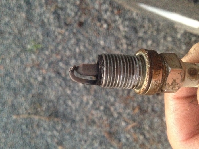

Also went over the ignition system again and found an issue. You'll see what I mean. Cleaned them up and put em back in. Was only that 1 that was like that.

WE ARE SET UP LIKE A 1979---I THINK YOU'D BE BETTER OFF USING "STOCK" SPARK PLUGS (CHAMPION N-13L OR EQUIVALENT) GAP IS.035 (THIRTY-FIVE THOUSANDTHS OF AN INCH)
IF YOU ARE EVER GIVEN A PLUG GAP "CHOICE", SUCH AS.035-.040----ALWAYS GO WITH THE SMALLER GAP (.035) THEORETICALLY THE GAP "WEARS" OR "GROWS" EVERY SO MANY THOUSAND MILES. GAPPING SMALL, WILL INSURE THAT THE CORRECT GAP DOES NOT GROW "TOO BIG" OVER TIME, AND YOUR SPARK PLUG GAP WILL REMAIN WITHIN SPECS
I ALSO RECOMMEND THAT YOU USE A 1979 PCV VALVE, AND TUNE YOUR CARB ---AFTER--- IT IS INSTALLED (IT S. UCKS IN LESS AIR THAN THE ONE FOR YOUR YEAR. THIS WOULD AFFECT YOUR AIR/ FUEL RATIO, MORE AT IDLE)
BELOW PICS SHOULD EXPLAIN TIMING (I HOPE). LET ME KNOW IF YOU ARE CONFUSED
