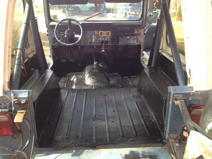

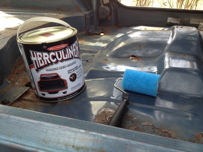

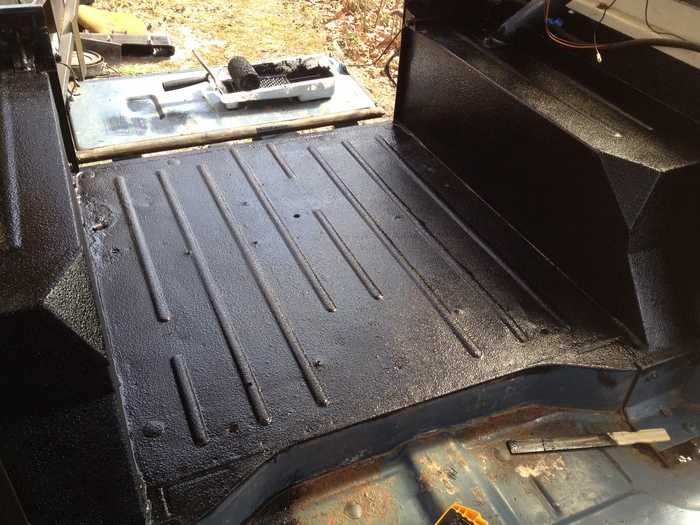

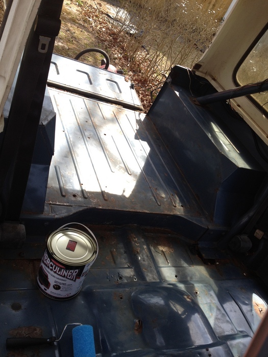

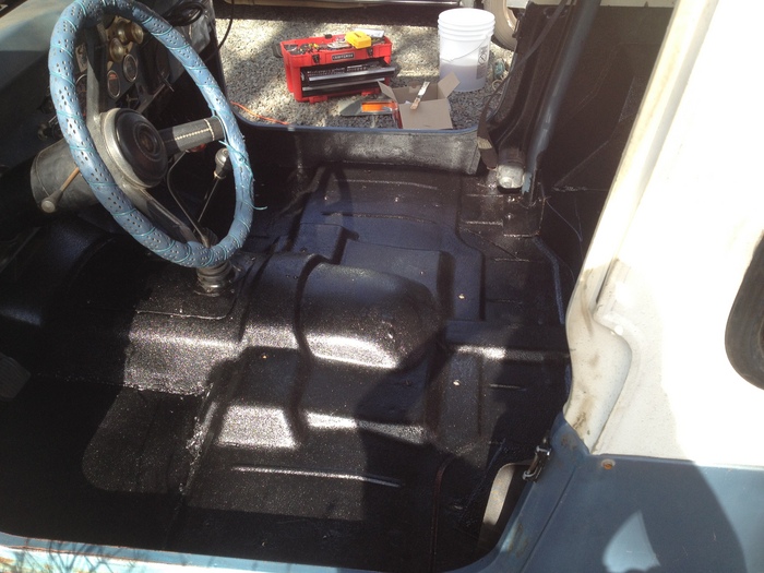

Well I surely made a mess today. Went out and got the herculiner kit last night and tackled that today, its some rough stuff on the hands. Nearly impossible to get off. But it came out real nice. That was all for today. Nothing tomorrow, have to work all day. But maybe this weekend ill get those wheel locks off. Going to try to use the craftsman warranty to get them off. Ill be back again to update over the weekend.

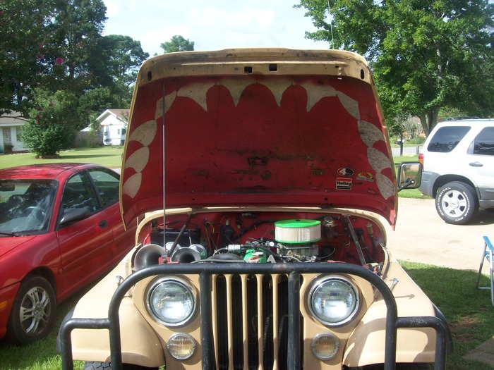

SOON I WILL HAVE THE NEED TO WEAR THEM WHEN I FIBERGLASS THE BACK SIDES OF WHERE THE RUST EAT (ATE) OUT UNDER MY DRIVER'S DOOR. IN MY PIC (FURTHER BACK), I JUST HAD GROUND IT OUT, IT DID NOT APPEAR AS BAD AS IT REALLY WAS, THE RUST AND PAINT SORTA HID THE ACTUAL EXTENT OF THE RUST DAMAGE. AFTER I GOT IT TO "BARE METAL" I SPRAYED IT WELL WITH "RUST TRANSFORMER" TO HOPEFULLY KILL THE RUST ACTION TILL I CAN GET IT GLASSED AND BONDO-ED. MAYBE MY NEXT DAY OFF.
IT IS LOOKIN' REALLY NICE!

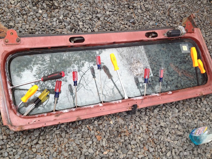

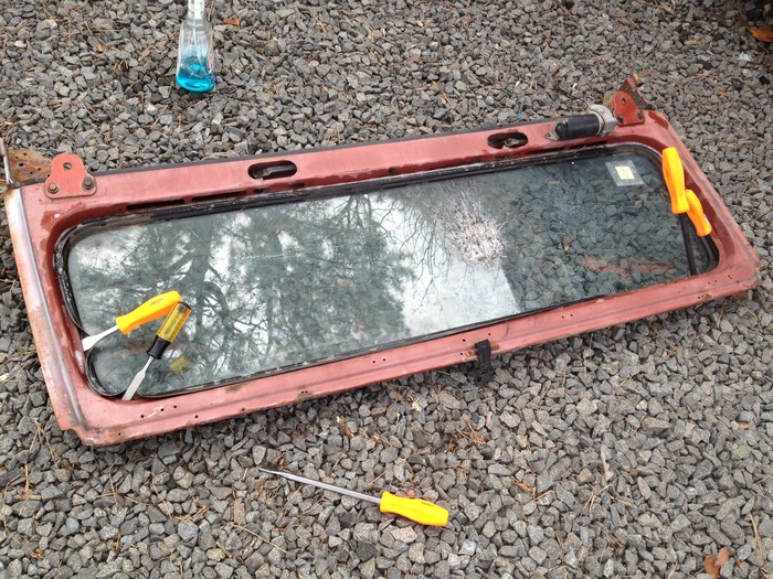

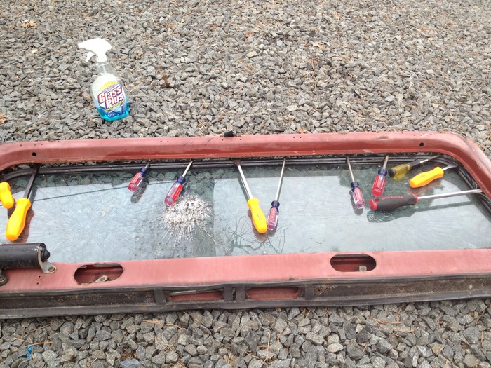

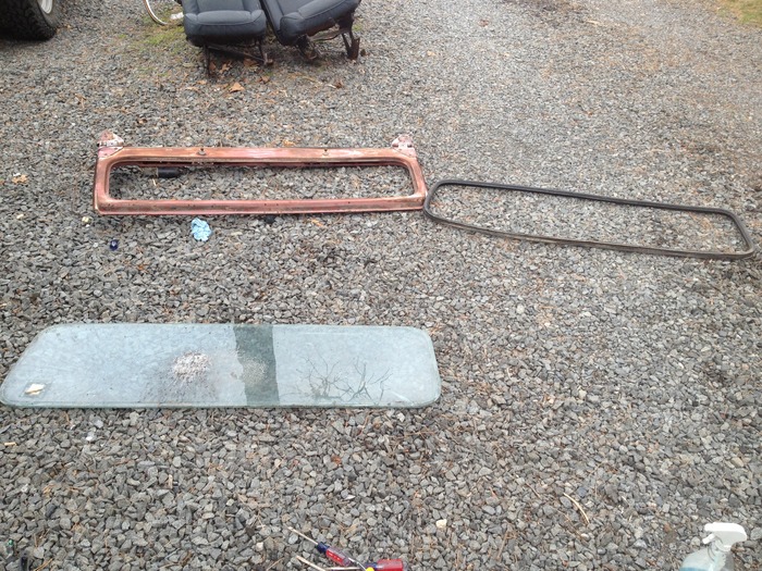

All of the glass removal was done while we were on the phone. In the one pic you can see what I meant by prying in the top corners, and than adding screwdrivers and pry bars all across the top. As simple as one small push on each corner and the center one it just dropped right down out of the frame. Well of course with plenty of window cleaner I used as a lubricant between the frame and the seal. That was the first thing I found in a spray bottle and figured it would work. Ill have to try that method on getting the other glass out. Although I might just get a new windshield because of the chips in it shown in the last 2 pics. One on each side of the glass.
Thursday, March 22nd, 2012 AT 2:24 AM

It just wouldnt go through with all the pictures attached so heres the rest of them

THAT SURE DOES LOOK A LOT EZer THAN THE WAY I HAVE BEEN DOING IT!

Yeah it was really simple. Starting at the top on the corners, putting 2 pry points on each side than one in the center and working each way so that none of the seal was still pushing tight on the frame, plus plenty of the window cleaner sprays between the seal and frame. Than once they were all in there I gave the corners and center pry points all a small push down and it fell right out. Than did the same on the bottom of it, of course that was alot easier. The bottom was more of just breaking the seal off the frame for how long its been on there.

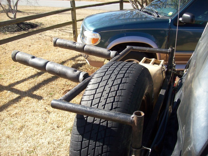

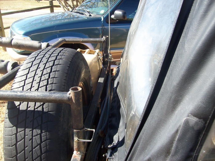

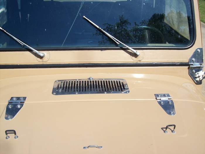

IF I REMEMBER WELL ENOUGH--THIS ARE PICS OF THE CONSOLE (20MM AMMO CAN W/ LOCK AND CUSHION) MY CONVEX MIRROR (AFTERMARKET STAINLESS) REMOVABLE CANOE/ LUMBER/ PIPE RACK/ STEERING GEAR BRACE (MODIFIED ANGLE IRON) THIS REMOVES PLAY FROM THE FRAME TWISTING---STORAGE BOX MY REAR SEAT SITS ON TOP OF (ABOUT A 4" SEAT LIFT)

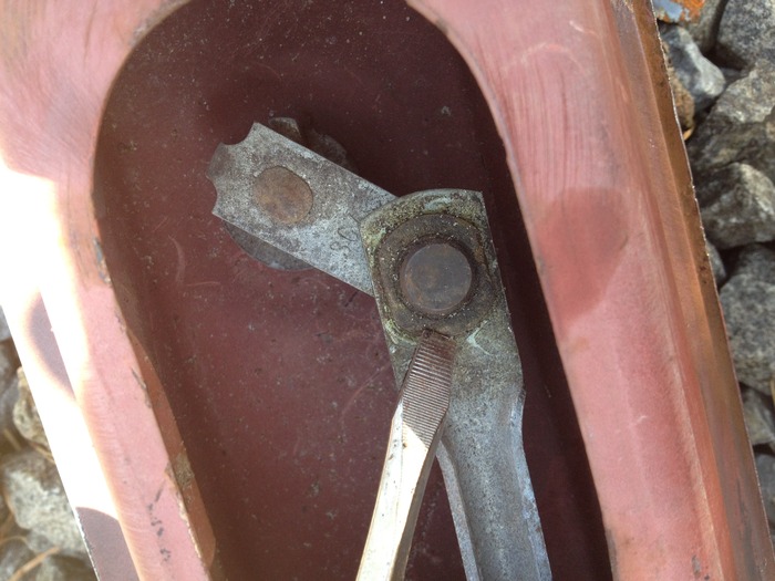

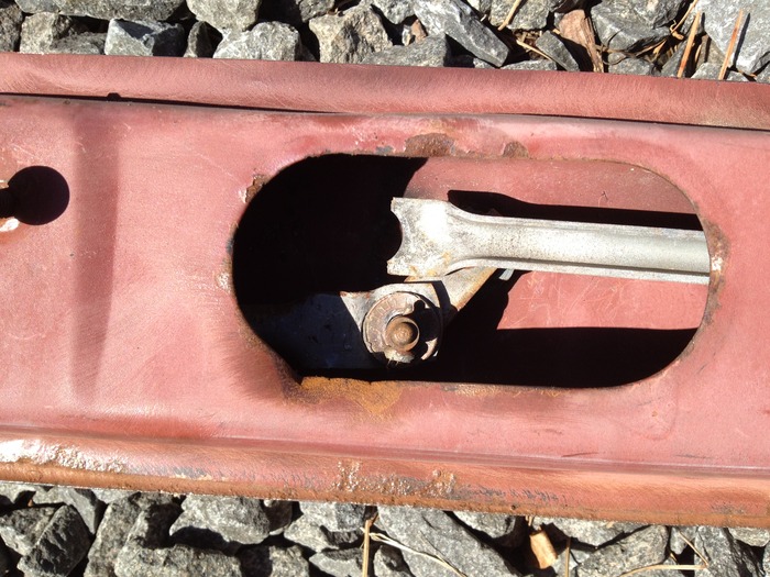

Well I started looking at that windshield frame and realized its gonna need some parts swapping. The wiper linkage is broken for the pass. Side wiper blade, and the wiper motor doesnt work. So ill be pulling that out of the old frame and swapping that over before I install it. Plus paint and installation of new glass. But im unsure of how the wiper linkage comes off, have you done this before? Ill attach pics to show you where I need to disconnect the linkage.
Pic 1: broken pass side linkage
pic 2: screwdriver is pointing to the piece that holds the linkage to go through to the outside to control the wiper blade. Any idea how this disconnects?
Thursday, March 22nd, 2012 AT 6:19 PM
CJ MEDEVAC
  • 11,004 POSTS
SORTA LOOKS LIKE THE CLIP IS MISSING----WILL IT PULL APART?
MINE ARE SORTA FOLDED OVER SPRING STEEL---YOU PULL IT OPEN LIKE A TACO--THEN SLIDE IT OFF
IT'S 22:30 HERE--I'VE BEEN REALLY BUSY TODAY--CHORES/ WORK/ REPLACE VALVE STEM ON MR. JEEP (HAD FLAT BEFORE I GOT IN HIM TO GO TO WORK, VALVE STEM SORTA BROKE IN HALF)
I'D ALMOST BET YOU JUST "WENT FOR IT" AND THE WIPER TASK IS DONE!
THE BEST ADVICE I CAN GIVE YOU ON INSTALLATION IS---MAKE SURE NOTHING IS BENT (EVEN SLIGHTLY) WHAT WILL HAPPEN IS WHERE THE "PIVOT SHAFT" GOES THRU THE SHEET METAL FRAME. THE PIVOT SHAFT ASSEMBLY WILL SORTA "TWIST OR ROCK" IN THE THIN METAL OF THE WINDSHIELD FRAME----THE METAL WILL FATIGUE---IT WILL EVENTUALLY "TEAR" AROUND THE PIVOT----OR THE LINKAGES WILL SUDDENLY BEND OR CRIMP OVER, WHEN THIS HAPPENS, THE PIVOTS WILL BIND THEN BEND FRAME AROUND IT. THIS WILL KINDA MAKE THE FRAME LOOK LIKE A CHAMELEON EYE BALL----THE METAL WILL BE SO FATIGUED, TAPPING IT BACK IN PLACE WILL ONLY RESULT IN A FEW MINUTES OF OPERATION---THEN ANOTHER CHAMELEON EYE BALL!
YES YOU WILL BE WAY OFF---AND IT WILL POUR RAIN 24 HOURS STRAIGHT
I ALWAYS USE "RAIN-X"---KEEP THE WIPING TO A MINIMUM
I SORTA KNOW THIS 1ST HAND, AND FROM OTHER PEOPLES JEEPS
WHEN I DEVELOPED THE LIZARD EYE BALLS AND TEARS---I LOCATED ANOTHER RUSTY WORTHLESS FRAME. RUSTED TERRIBLY AROUND THE HINGES
USING THE DONOR FRAME, I CUT OUT THE PIVOT HOLES IN A "DECORATIVE FASHION", THEN ENLARGED MY OLD HOLES, AND I RIVETED THEM OVER THE SCREWED UP HOLES (YOU MIGHT WANNA SAVE YOUR OLD ONES, FOR FUTURE USE. IF NEED BE!
LOOK AT HOW I DID MINE IN ORDER TO NOT BUY THE WHOLE WINDSHIELD FRAME! MAY BE HARD TO SEE, I PAINTED THEM THE SAME COLOR, I INSTALLED BOTH TO KEEP IT SYMMETRICAL. THE DRIVERS SIDE WAS MY PROBLEM CHILD
ONE LAST BIT OF ADVICE. NEVER STICK YOUR FINGERS IN THE OVAL HOLES. WHILE THE WIPERS ARE RUNNING OR MESSING UP. DON'T EVEN ASK ABOUT THE STITCHES OR HOW LONG I SCREAMED LIKE A LITTLE GIRL, BEFORE AND AFTER I GOT 'EM OUT OF THE HOLE.

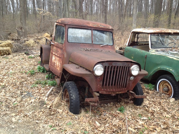

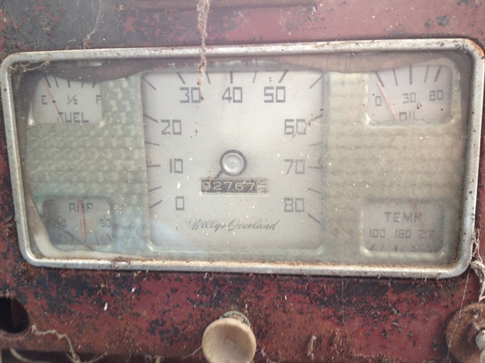

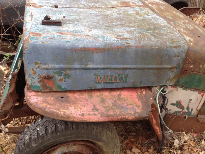

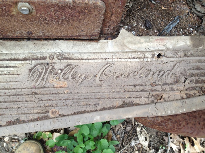

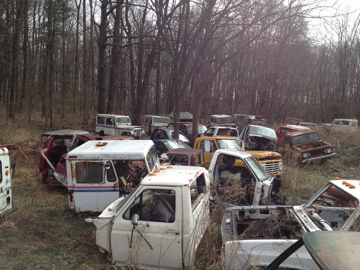

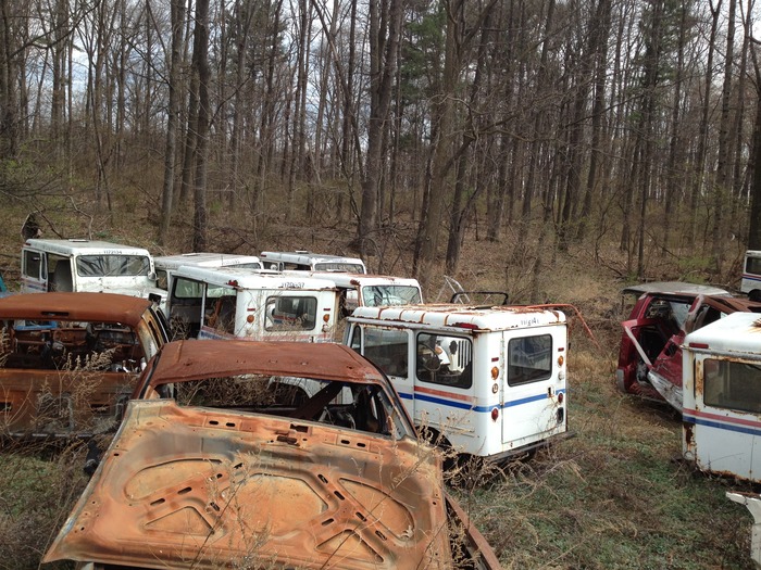

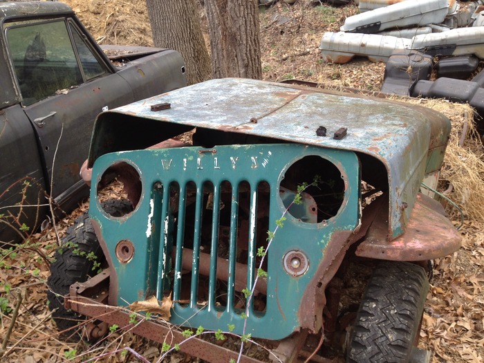

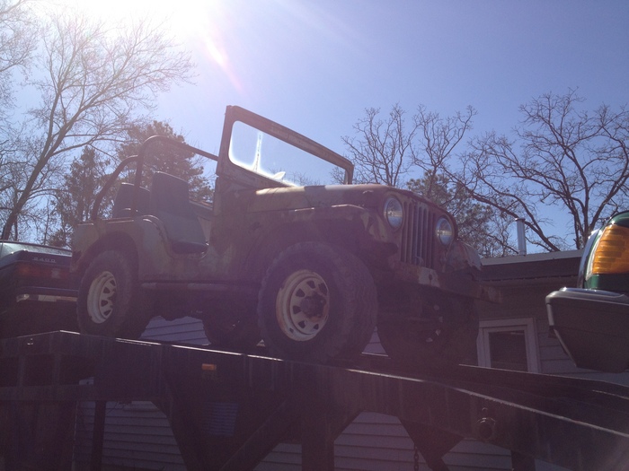

Hit the junkyard today, and got some more stuff. Got some really neat pics, think youll be impressed with my findings. Theres a ROUGH loooking cj5 that im falling in love with more and more each time I go there. But its getting worse and worse.
Pic 1&2: how many postal jeeps can you spot?
Pic 3, 4, 5: OLD willys overland
pic 6, 7: OLDDDD willys, im sure your more familiar with the style than I am. Im thinking that its a CJ3A? Im not sure, havent done squat with them before
