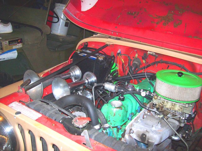

From blowing up the picture, looks like a campground.

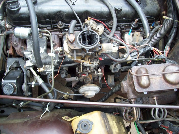

Take in account you may still have the 1 bbl, operations will be the same
I went to the Carter BBD (2 bbl) for a few years on my present CJ-5, Now I have Mr. 390 Holley 4 bbl. Intake and carb did cost, but I did reach my goal. 18 MPG an improvement over 15 or so norm, with an occasional 16

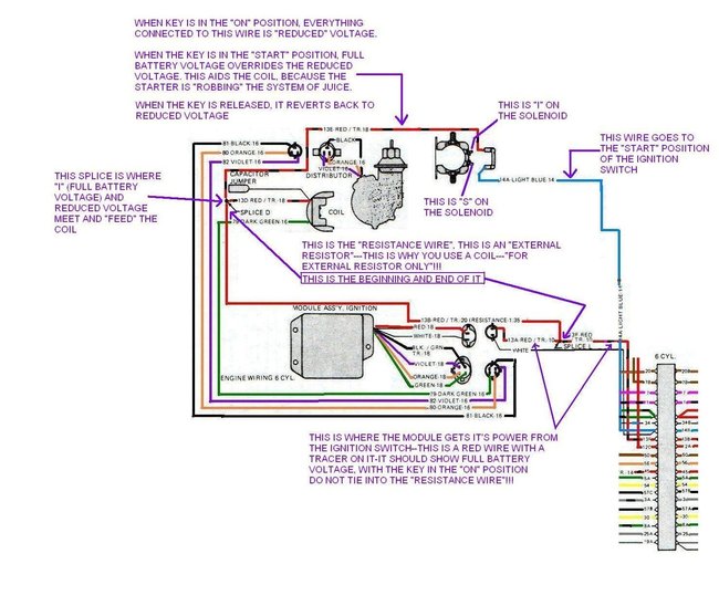

I have a 76 CJ7 with AMC 360 swap. Motorcraft Distributor. Long story short, Starting Solenoid stuck in engaged in the cold I think I cooked something. Swapped with new : Coil, Ignition switch, Starting solenoid, new TP40 module, Fusible link.
I have no fire in run position, have fire in start. If I hotwire + battery to + coil she runs like a charm.
Shes see more grease balls than a Shanghai lady of the night.
Any ideas?
Thursday, March 30th, 2017 AT 1:38 PM
CJ MEDEVAC
  • 11,005 POSTS
Thanks for relying on me!
I hope I can help!

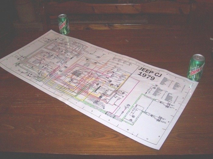

My wire '79 diagram shows the 'Main Plat' using a 258 it does also show the 304 split off of it (It is sorta confusing on the 304 part)
I use/ modify this diagram to 'splain stuff to y'all. I took a diagram in a manual (2 different pages) and scanned it/ colored it in Microsoft Paint, then I had it blown up and laminated it's now hanging in my garage. Originally all the lines were black/ small/ criss-crossing/nearly impossible to trace out. With it colored and big now, it takes seconds to navigate it! (I still have it in computer format).
So, I grabbed this part and deleted everything around a long while back.
If you will study "I" terminal and my explanation of how it works, you will understand why you have juice to the coil while 'cranking'. SEE THE SPLICE/ OR TEE in the coil wire.
From that splice, head 'South" your problem is most likely from there down.
Check your wires
Check the resistance wire
This is a '79 diagram, Generically forget the firewall in the diagram, BUT see if you are getting juice (12 V) into the module from your firewall.
