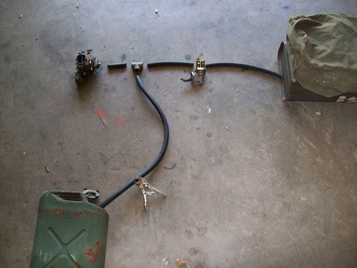

FIRST CALL!---WAKE UP!---TIME TO DRAIN YOUR FUEL TANK!
LET YOUR FUEL PUMP DO ALL OF THE WORK!
DEFINITIONS. FROM LEFT TO RIGHT. THEN DOWN!
CARBURETOR---FUEL LINE--TEE--FUEL PUMP--FUEL LINE--FUEL TANK IN VEHICLE
DOWN FROM TEE----LONG FUEL LINE---VISE GRIP PLIERS (VALVE, OR EVEN A SLIGHT "KINK")--PROVIDES BACK PRESSURE TO INSURE CARB DOES NOT STARVE FOR FUEL, WHILE PUMPING OUT)----THEN FINALLY OUR "CATCHER FUEL CAN"
THE PLIERS/ KINK/ VALVE MAY NOT BE NEEDED, AS LONG AS THE CARB IS CONTINUED TO BE FED ENOUGH FUEL TO RUN ENGINE
MONITOR PROGRESS--DO NOT LET YOU CAN OVERFLOW
FIRE EXTINGUISHER HANDY, IS ALWAYS A GOOD THING!
MOVED WIFE'S CAR OUT OF THE GARAGE, JUST TO MAKE YOU A SPECIAL PIC!
AIN'T IT PERTTY!
I KNOW A FEW EXPERTS HERE, THAT COULD FIND SOMETHING WRONG WITH IT!
DO YOU UNDERSTAND. THAT'S ALL THAT MATTERS!
YOUR TURN
THE MEDIC
Monday, June 20th, 2011 AT 5:38 PM
