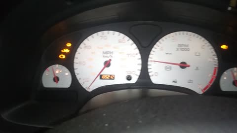

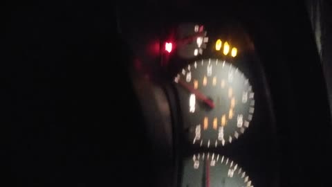

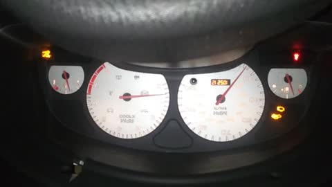

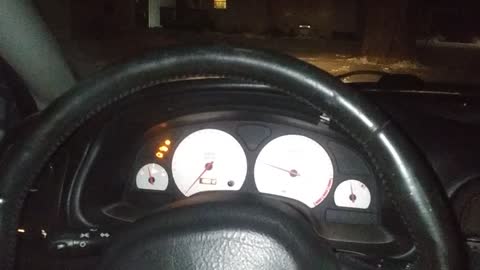

I will do that. I have to say that i'm a service tech for arcade like games and slots. So when I opened the BCM I notice that some pins looked like they got hot and could use re-solder. I didn't but when I put the BCM back instead of sitting on top of glove box I twisted it up above a little higher. So i'm thinking maybe now those pins are making a connection for now anyways. I might pull it out and touch them up a little bit and see what happens. I will go now and shoot a video.
Friday, January 24th, 2020 AT 7:40 PM
JUGGALO45
  • 88 POSTS
This is now as i'm texting this but next ones are minutes before that it didn't start then it did start, but rough as heck. Right now it smooth up and regained power.
Friday, January 24th, 2020 AT 7:57 PM
JUGGALO45
  • 88 POSTS
Minutes before. At first it didn't want to start then this original BCM still.
Friday, January 24th, 2020 AT 7:59 PM
JUGGALO45
  • 88 POSTS
And now when I shift into drive it clucks pretty hard.
Friday, January 24th, 2020 AT 8:05 PM
JUGGALO45
  • 88 POSTS
I restarted it and it stopped clucking into gear.
Friday, January 24th, 2020 AT 8:07 PM
JUGGALO45
  • 88 POSTS
Clunking.

Now it started. Running rough now.

Running.

What have you done between not running and now?
Sunday, January 26th, 2020 AT 2:46 PM
JUGGALO45
  • 88 POSTS
Just unhook negative to battery last night and kept trying to restart it and it started up. I let it warm up drove it 10 miles and let it run at idle at a buddy's and it just quit running and now I have to go and tow it back home. I stop there because I notice I didn't have turn signals but had everything else. And it was idling 10 minutes and just shut off.
