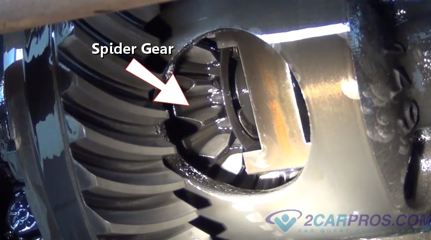

Spider Gears
Spider gears is where the "magic" happens, both the right and left side axles are plugged into a spider gear on each side, and is held in place by a pinion shaft within the differential carrier.
