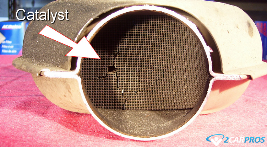

A catalytic converter is constructed with a ceramic honeycomb or wash plate which is coated with a thin layer of catalyst material, typically platinum, palladium, and rhodium. These materials are placed inside a metal container with an inlet and outlet connections. The honeycomb design provides maximum exposure to the exhaust gases.

This is what the catalyst material looks like inside the converter, this one is broken which is why it was replaced.
catalyst inside an automotive exhaust system catalytic converter

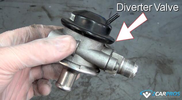

You may have noticed that some vehicles have an air injector system which provides fresh air into the exhaust system, either before or at the catalytic converter. This AIS system is designed with an air pump, control relay, air diverter valve, air check valve and tubing, super heating the catalyst to aid in it's chemical reaction, here is what a diverter valve looks like:
air injection diverter valve
