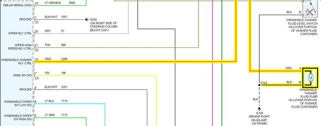

If you have already replaced the windshield washer pump in your 2006 Chevrolet Impala and tested for voltage at the pump with no power present, it's possible that the issue lies with the switch or a related component.
In many vehicles, including the Chevrolet Impala, the windshield washer switch is typically integrated into the multifunction switch assembly, which is located on the steering column and also controls functions such as the turn signals and high beams.
Here are a few steps you can take to further diagnose the problem:

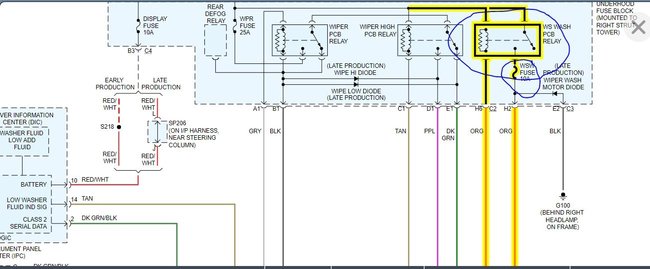

Check the fuse: Locate the fuse box and check the fuse related to the windshield washer pump. Refer to the vehicle's manual or the fuse box cover for the exact location and identification of the fuse. If the fuse is blown, replace it with a new one of the same amperage rating. Test the washer pump again to see if it now receives power.
Inspect the wiring: Inspect the wiring harness that connects to the windshield washer pump for any signs of damage, loose connections, or corrosion. Repair or replace any damaged wiring as necessary.
Test the multifunction switch: Since the windshield washer switch is integrated into the multifunction switch assembly, it's possible that the switch itself is faulty. To test it, you may need a multimeter to check for continuity and proper operation of the switch. If the switch is determined to be faulty, it will need to be replaced.
