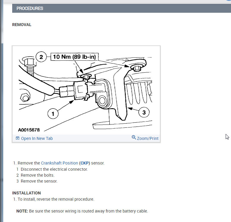

This could be a couple of things but the most likely is the crank sensor has failed. However, let's start with this guide that covers this issue:
https://www.2carpros.com/articles/engine-stalls
Next we need to pull a plug and hold it against the block and crank the engine to see if there is a spark. Here is a guide that gets into the crank sensor which is what I suspect the issue is:
Lastly, I attached the process below on how to replace it from the manual. Let's run through this material and go from there.
