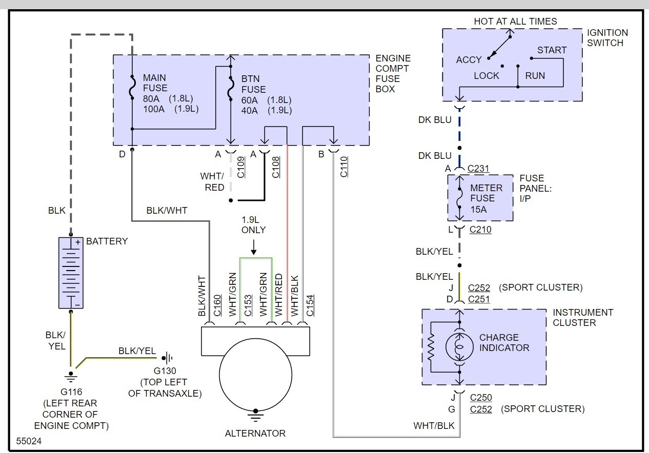

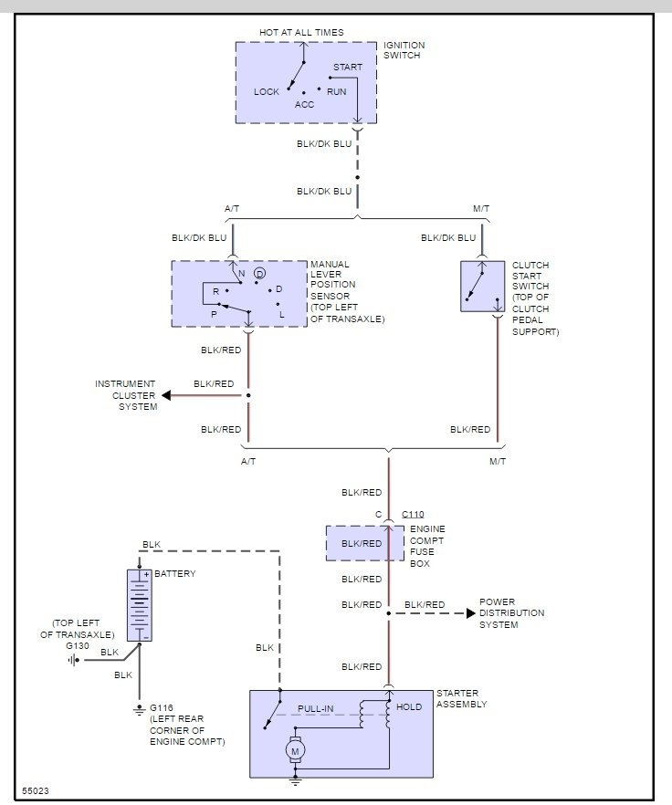

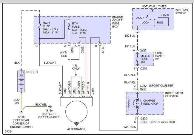

I turn the key, engine starts, I release the key, engine stops running.
The injector line has fuel pressure. Always starts, does not continue running.
Wednesday, December 28th, 2016 AT 11:13 PM
KEN L
MASTER CERTIFIED MECHANIC
55,440 POSTS
Hey CBRICHINS,
this sounds like you have an ignition switch that has gone bad, here is a wiring diagram and a guide so you can do some testing. Also check the fuses.
and
Please let us know happens so it will help others.
Best, Ken
