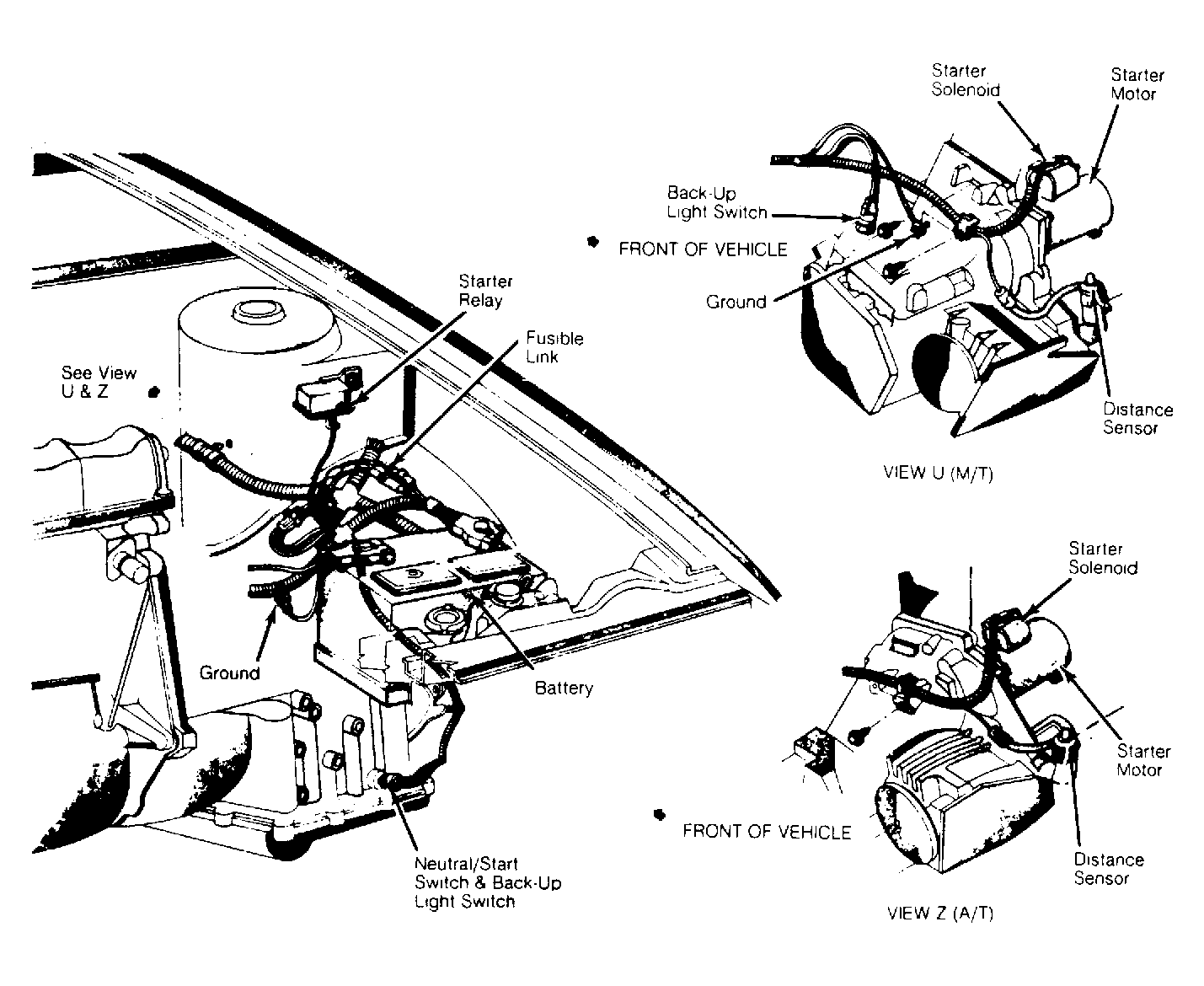

Upon entering the vehicle, inserting key and attempting to start I am met with silence. I wiggle the gearshift nothing, again nothing. Sometimes it starts the first or second time sometimes I have to try seven or eight times. It does the same in neutral as in park.

This sounds like the starter had gone bad but to be sure lets run down this guide to see confirm the issue.
if it is bad this guide can help walk you through the repair.

If the starter cannot crank, it can be one of many reasons.
Starter, ignition switch (or it circuitry), starter relay, battery, (or terminals and connections) and security system.

It could be a bad starter. You would have to verify power on the small trigger wire when the key is held in start when the problem is present.

Sounds like the battery or cables. A nuetral or clutch switch provides the starter relay to work. Turn on the headlights, try and crank it, if they die, battery or connections from or to car, if they don't change at all it may be the switch, if just erratic, its still a cable, terminal, or battery, the car needs a good battery before any basic charging or starting problem can be tested. Hope this helps you, I liked this car and worked with hundreds. Be careful working around the battery. With no good voltage supply, the check engine should come on, its normal.
