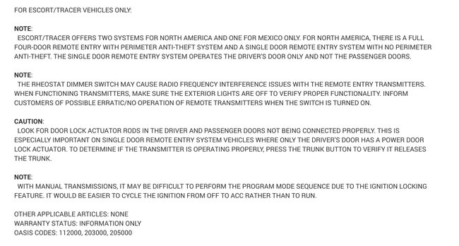

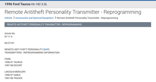

Hello again,
When I was doing some more research on this, I ran across this Technical Service Bulletin[TSB]. Please go through it and report back with how everything turns out.
Thanks,
Alex
